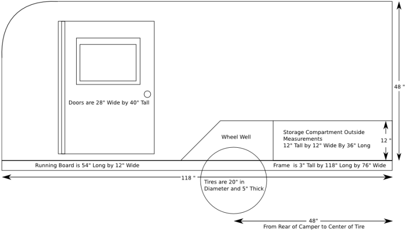

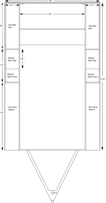

This first one is a base/floor layout:
And a side view. Other side will be a mirror image of this one. The running boards will be thin plywood or aluminum plate on top of the frame. Still working on how I'm gonna build the floor.

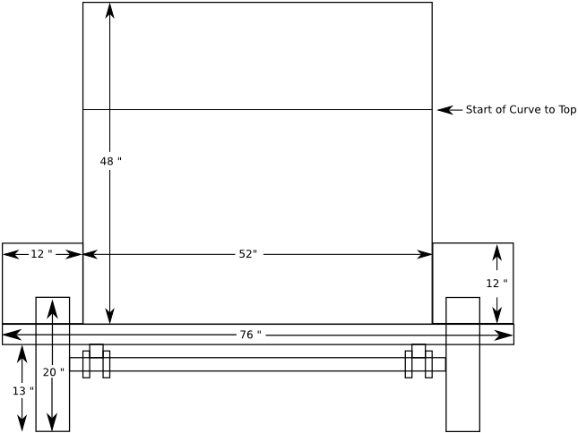

View from the front. Will most likely have a tongue box with spare tire mounted on front wall, just below the point it starts curving.

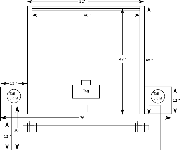

And last a view from the back showing the lights.

Looks pretty good to me. I do wonder if the wheels are a bit far forward for this plan. If you put heavy stuff in the rear outside storage area this will be even worse than a traditional teardrop about need the wheels moved back from center.

Alan Wood wrote:Looks pretty good to me. I do wonder if the wheels are a bit far forward for this plan. If you put heavy stuff in the rear outside storage area this will be even worse than a traditional teardrop about need the wheels moved back from center.
True. Problem is, if I have to move the axle back it will mean having to rebuild the frame anyway. I have tentatively planned on storing stuff like camp shovel, chairs, and charcoal in the rear boxes. Was planning on putting the battery and charger in the tongue box to help a little with the balance. I can move the shelves for clothing and such that are at the back of the sleeping compartment to the front wall which will move a bit more weight forward. Will run the Trailer Balance Spreadsheet before I go any farther and see what tongue weight looks like.
Thanks for the input!
Your welcome. The battery and charger in the tongue box will surely help. As would moving the sleeping compartment storage forward. If you go this route I think you will have to be carefull to keep the running board storage lite. Hm it occurs to me that making the running boards out of not so light aluminum plate would be a step in the right direction.

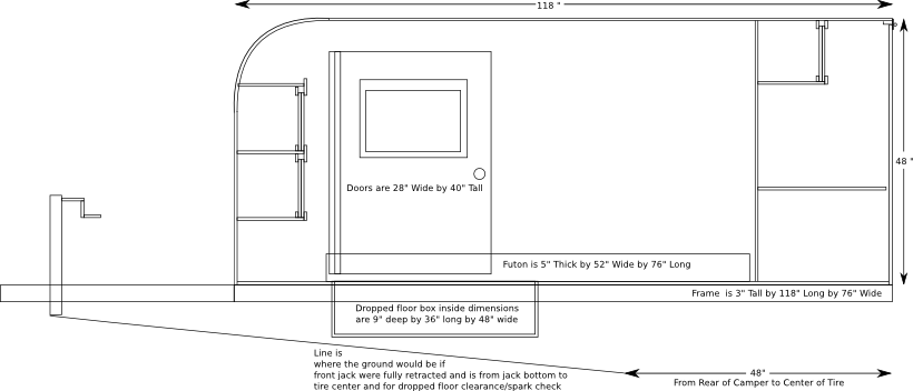

This sketch is a side view of the inside with some rough detail added. Floor box is tentative as I've still got to finish the teardown and get the old floor off and see exactly where the cross support members are located. Maybe by this weekend.
Alan,
I'm doing a lot of guessing in coming up with those numbers and the shape of this critter doesn't exactly match the shape that the calculator was designed for. After I get the rest of the stuff off the frame I'll get the big feed store scales out and see if I can get an actual weight for the frame and axle as well as hitch weight and see what changes need to be made and go from there.

Postby Alan Wood » Thu Oct 23, 2008 12:02 am
depatty wrote:Alan,
Every good TD starts with a vision. And your vision apears to be coming together nicely. :thumbsup:
The hatch being staight looks like a good canidate for strategic light weight construction to me. And it's in the place were that would help the most with your existing trailer.
The tounge box however probably ought to be built like a tank within reason of course.

Postby Alan Wood » Thu Oct 23, 2008 12:15 am
Hm I was taking another look at it and realized that as drawn the trailer end of the galley hatch is at 5'3" . You may want to extend the hatch forward several inches to get better clearance in the galley. Like has been done in some of the grashopper's.

Alan Wood wrote:Hm I was taking another look at it and realized that as drawn the trailer end of the galley hatch is at 5'3" . You may want to extend the hatch forward several inches to get better clearance in the galley. Like has been done in some of the grashopper's.
I'm over 6 feet tall, so yea, I've given a bit of thought to the head clearance problem and also thought about the flat back wall causing reduced fuel economy too. :roll: But, on the other hand, my initial reasoning was that most if not all of the actual cooking will be done outside or on swing out/pull out tables and the galley area will be used mostly for storage. Also the vertical seams will be easier to waterproof/seal and the rear door can be a lot lighter and easier to build. On yet the other hand, :lol: I do like the grasshopper design and you do make a good point about the height. I'll take a look at changing the angle on that back wall and see what it looks like with the top moved forward 10 to 12 inches. That would still let me keep the hinge on the (almost) vertical portion of the wall but reduce the knots on the head quite a bit... :thinking:
