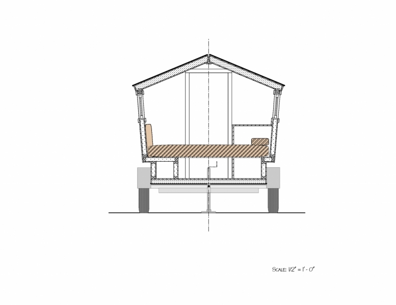

Postby n0klu » Thu Nov 08, 2012 11:06 pm
droid_ca wrote:
n0klu wrote:
mikeschn wrote:Droid,
Welcome aboard n0klu I like the layout of your roof line do you have any other picture of this idea?
Thank you for the welcome.
I have developed this plan for a 12' trailer as well as the 14' trailer. To answer you question:
Not yet however they can be made rather easily. I use a CAD program called "Vectorworks" a Macintosh program.
What kind of views are you looking for? I don't know how to do rendering very well.
I used the pitched roof only because it would be easier for me to build (and insulate)... A bow can be substituted but the walls must increase another 10-14 inches to make for the headroom, or a drastic bow would have to be done. Bows are typically +/- 8' on the radii or about 12-14 inches in the bow. looking at the section the bow would be just below (2-3") the inside of the pitched roof and then the thickness of the roof lower still.
Sorry for the lag time in my response.

Postby droid_ca » Fri Nov 09, 2012 2:21 am
Do you know what angles your roof lines are on as for my cabin idea I think that would be about the angle I'd like to go with with the exception of 2 feet how much of a difference is there between your 12 foot and 14 foot design
“Fide Canem”
viewtopic.php?f=5&t=52816
droid_ca
Posts: 1981
Images: 176
Re: Vardo plans
Postby n0klu » Fri Nov 09, 2012 3:22 am
droid_ca wrote:Do you know what angles your roof lines are on as for my cabin idea I think that would be about the angle I'd like to go with with the exception of 2 feet how much of a difference is there between your 12 foot and 14 foot design
here is the floor layout of the 12' plan:
6x12' Vardo.pdf
(199.1 KiB) Downloaded 638 times
the kitchenette is a little smaller as well as the closet space.
Here is the dimensions and angles for the 14'... Hope this helps you.
14' single axle trailer Vardo.pdf
(33 KiB) Downloaded 614 times

Re: Vardo plans
Postby n0klu » Mon Nov 12, 2012 5:39 pm
6x12' Vardo.pdf
Did they help? :D

Re: Vardo plans
Postby droid_ca » Mon Nov 12, 2012 6:55 pm
goimg over the plans there is one dimension that seems to be missing and that is the actual height of wall that is angled outward But I've been playing around with some ideas I might do a straight wall with no angles as I'd like to keep it as close to a house shape as possible...figure I better spend some time in designing it right the first time instead of ripping it apart and having to do it over again and agian
