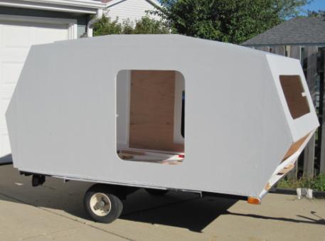

Did it seem to be absorbed by the wood, or did it just lay on top?
I'm anxious to hear what you think of how the aluminum laid down too, is it nice and uniform?

parnold wrote:Did it seem to be absorbed by the wood, or did it just lay on top?
I think it just laid on top. It went down very easily, nice & uniform, but adhered more like a paint rather than being soaked into the wood or absorbed like a sponge would do. It gave off a smell that reminded me of the combination of plastic, Testors glue and enamel paint when building models as a kid. :lol:
The first coat went down in about an hour, and was only (maybe?) 1/4 of the can. The second coat took around 45 minutes and that took me down to a little more than halfway, more than enough for the hatch and the remaining piece in the front.
They say to use a phenolic core roller, whatever that means (I didn't spend much time looking that up online and the guys (plural) @ the box store were no help), but I made sure I used one specifically made for varnishes & urethanes, rather than the ones made for all types of paint.

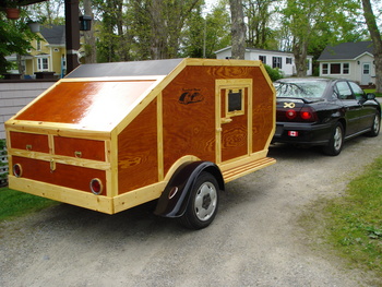

Trim with Diamond Tread Plate...
Postby myoung » Tue Sep 07, 2010 10:33 pm
For the corners, I plan to use 1.5 x 1.5-inch diamond tread plate which is available in 4 to 8 foot lengths. I've sketched out the design and like the rugged industrial look for angular trailers like yours and mine. It should be an excellent complement to the aluminum-colored exterior finish.

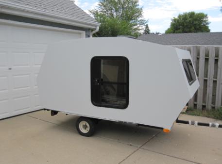

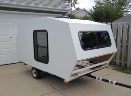

Postby MKE_Tear » Tue Sep 14, 2010 12:24 pm

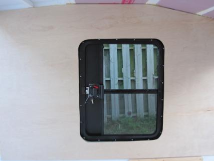

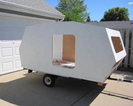

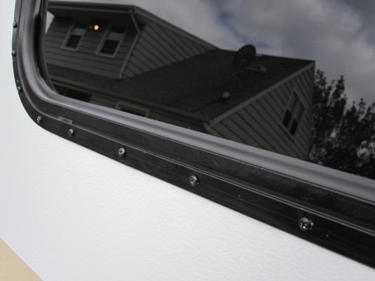

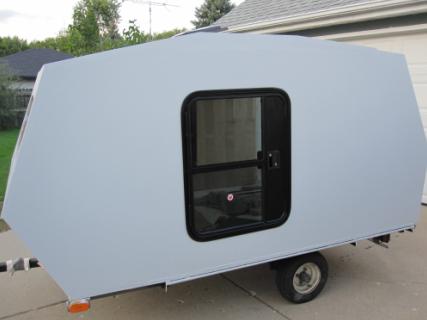

Well, I had to take a couple of steps backwards. I got the paint on, three coats to get everything even, and I then later didn't like it.
So then came a coat of primer and two coats of the paint I'm going with. It's slightly lighter than the color of the aluthane, but not as shiny. I'm still trying to maintain a relatively industrial look. I'll later put in some stripes, streaks or swirls but that might be next year.
Here's after the paint job:
Image'
And with the passenger side door in (and with the front window just resting there/testing the fit, now that I have 6 coats of product on top of the two coats of aluthane):

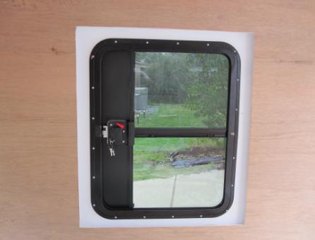

In having the slight setback, I learned something VERY IMPORTANT about the Little Guy style doors. They are designed so that the hinge is towards the front, like the hinge on a car door (it gives you more room to get into, and in case the thing blows open while you're going down the freeway the wind won't blow the thing off), but here's the thing:
MY STICKERS (telling me passenger side up & driver side up) WERE BACKWARDS -- THEY WERE ON THE WRONG DOORS (or wrong sides of the doors)!!
After I put the passenger side in the first time, and even though the sticker said I had it in properly, it was wrong bec. I realized that the weep holes were on the top, not good for draining water.
So, no matter what the stickers say, look for the weep holes and/or the proper placement of the hinge.

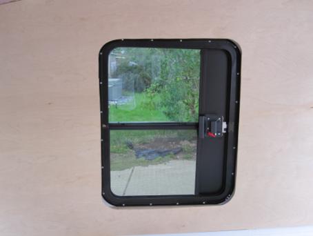

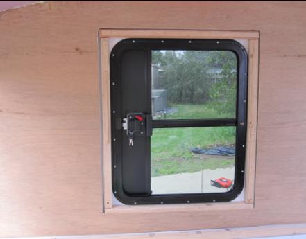

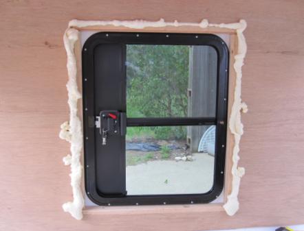

Postby MKE_Tear » Tue Sep 14, 2010 12:47 pm
On the inside I wasn't sure how I was going to frame out the Little Guy Door, with respect to my inside walls (my original design didn't have insulation or sandwich walls). I just had a piece of luan over the pink stuff:
Notice the placement of the door, ESPECIALLY where the hinge and door handle are located.
So I decided to frame out the open area with 2x2s and then fill in with the foam in a can stuff, and follow it up by laying a sheet of birch plywood over the top, to give it a nicer and stronger inside finish (not spongy like the luan).
Giving me this, with the PROPERLY installed door:
I'll later finish it up with some trim. I was able to get the hole to the right size by test hanging the plywood and tracing the opening from the outside onto the back side of the plywood. Hope that makes sense!
I should point out that I called the manufacturer and he said it didn't really matter which way the doors are in, I guess there is a vendor that specifically mounts them the other way (which orients the open screen towards the top of the door), but I would prefer to have the weep holes at the bottom.

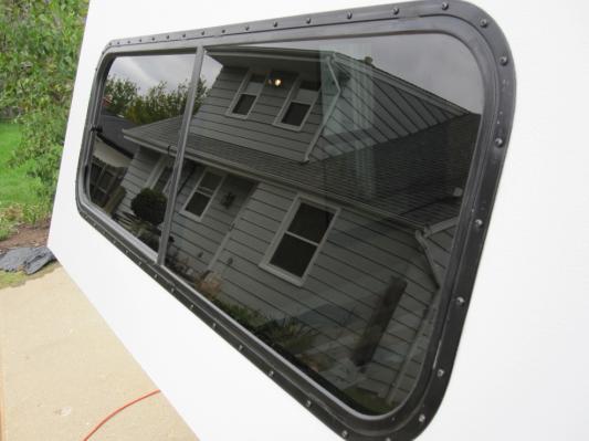

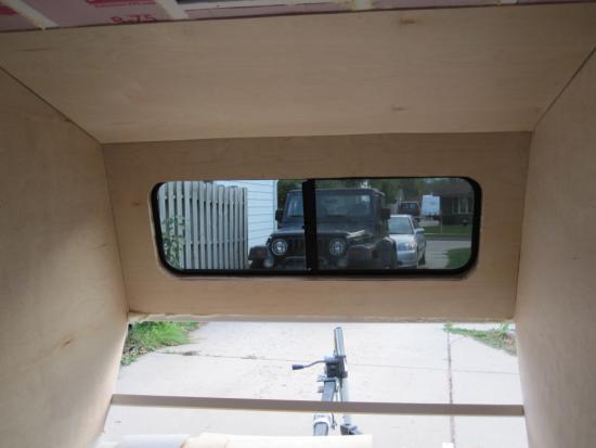

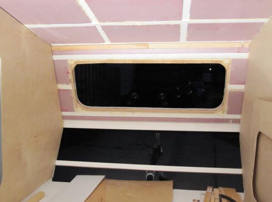

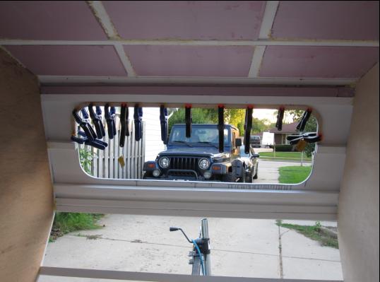

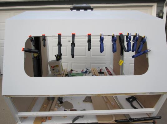

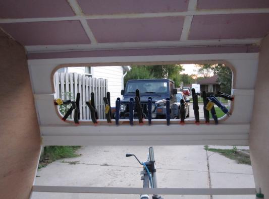

Postby MKE_Tear » Sat Sep 25, 2010 5:13 pm

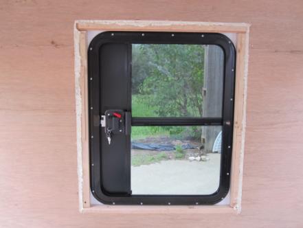

So the front window finally went in, permanently.

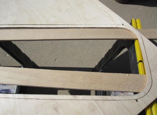

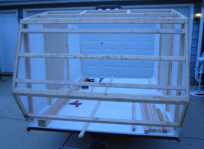

Before I even cut the plywood for the sides/walls, I purchased a window off eBay (from either a camper or probably a pickup truck) that I decided was going in the front. It didn't have a clamp ring but having dropped a sunroof into a car before I thought I could figure it out.
If you remember from an earilier shot there was quite a bit of framing in the front -- an extra set of spars -- that's bec. I wanted to make sure I could support the window and/or keep the front panel of plywood from warping (due to the weight of the window).

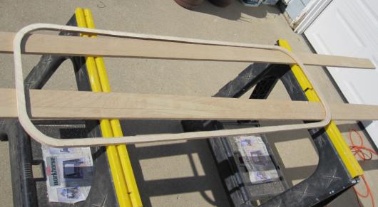

Now, after all the test fits, I'm finally at the stage of building the ring/frame that will hold it in on the inside.
Basically, I traced the size of the original window hole, enlarged it by 3/4" and cut it out of 1/2" plywood three times, then gluing them together to make the "oval" 1 1/2 inch depth of my inside sandwich walls. Maybe these photos will help make some sense.
After the inside framing is sandwiched/done and that front panel is insulated, the goal is to then drill holes into the frame and screw it in (with decorative black head screws) using RTV silicone as the adhesive.
And, after measuring where all the screw holes go, here's the finished product:
If you look close enough you'll see my guide/pencil line and maybe some remnant adhesive that needs to be wiped/rubbed off (when dried).
As my wife says, "It's got two doors & a window."

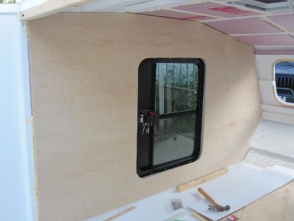

Postby MKE_Tear » Sat Sep 25, 2010 6:38 pm
Inside paneling is going in...
Molding will go around the edges to finish/trim things off.
I know I won't meet my self-imposed deadline of the end of Sep. but oh well. Daylight hours are just getting shorter and shorter. That's what I'm going with. :lol:
