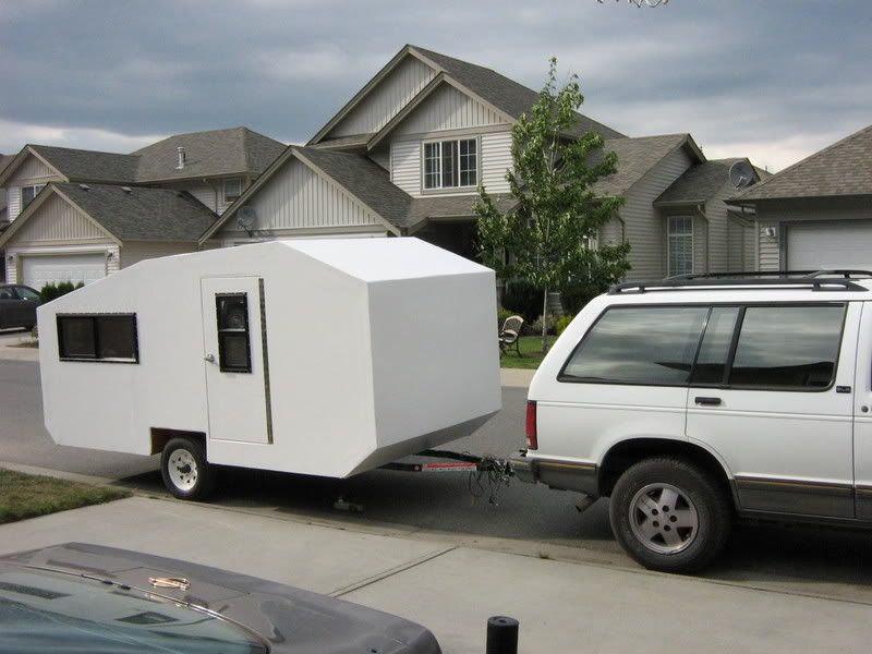

Well... She's 90 percent completed.
I just finished painting and managed to hang 2 windows.
I have 2 more windows to do, I need to mount the lights, add a outer door jam weather stip. And some cosmetic stuff, like a grey accent strip.
I also need to finish the interior but as she stands now I can use her.
It ended up taking, 3 coats of epoxy, 2 coats of primer and 3 coats of tremclad. I'm satisified but not truly happy with the final results but hey, live and learn.

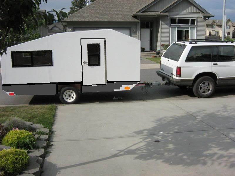

Postby beevel » Fri Aug 17, 2007 11:13 am
Here's what I'm thinking of for paint work.
beevel

Postby Cliffmeister2000 » Fri Aug 17, 2007 1:00 pm
She looks terrific! :applause:
Mike had opined in an earlier post that with the wheels so far forward you might need and anti-sway bar. I see you have it hooked up to your tow vehicle - how does it tow?

Postby beevel » Fri Aug 17, 2007 2:54 pm
Haven't towed it yet. I'll probably take it for a test tow on Sunday. I have a few things left to do tomorrow ( lights being one of them) and then she'll be good to go.
In hindsight I would have moved the wheels back about 12 inches,( but then in hindsight I would have done a few things differently) having said that she is definetely tounge heavy as it stands now, when we pack it for camping all of our supplies are going to be packed in front of the axle so I don't forsee any problems. I don't ussually tow over 110km/h(65mph) anyway so even it it sways a little I'll be okay.

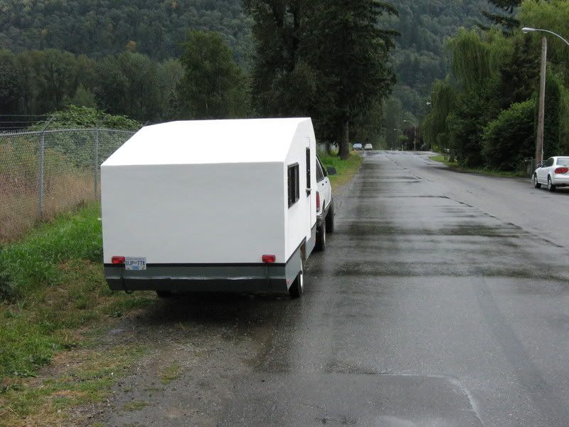

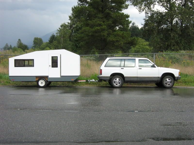

Postby beevel » Sat Aug 18, 2007 7:21 pm
Well, she's done (on the outside anyway) and useable. I managed to finish installing the windows today, hooking up my lights and doing the two tone paint.
Took it out for a quick tow and my Jimmy doesn't even feel the trailer back there.
Here are a couple more pics
Next... finish the interior.... I think I'll stop workng on it for a little bit, I need a break.... Now I have to finish the things around the house that I've been neglecting
And a photo of the opposite side.
