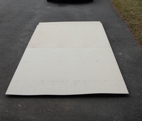

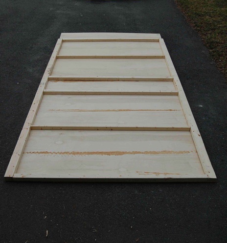

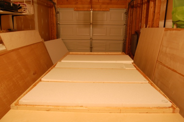

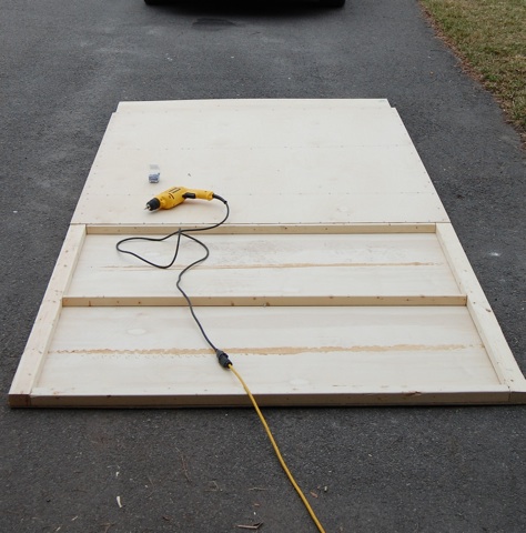

Starting to make some progress. This morning I finally got some of the floor glued up. I screwed the 1/4 ply to the framing to keep things in place, then flipped it over and glued and screwed the 1/8 ply in place. The screws will be removed once the glue dries. Then I'll remove the 1/4, glue in the insulation, and glue the 1/4 into place. The 1/4 side is going to be the cabin side with the 1/8 facing the ground.
There will be pics in my album soon, but I'm having some difficulty uploading images at the moment.

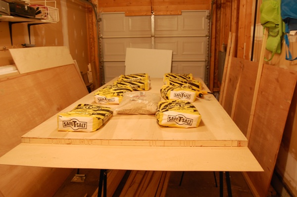

Got the insulation and 1/4 inch ply glued into place. The ply is secured with screws around the edge and gravity clamps in between. It's only 160kg of weight so it isn't much, but better than nothing.

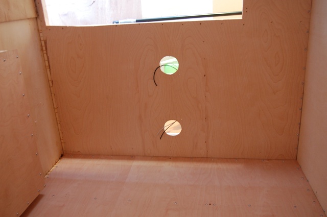

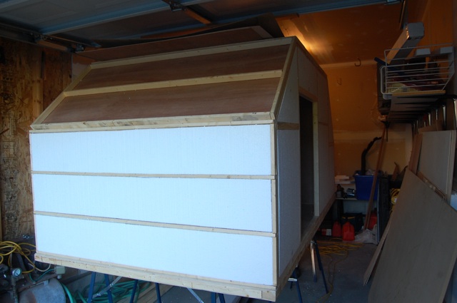

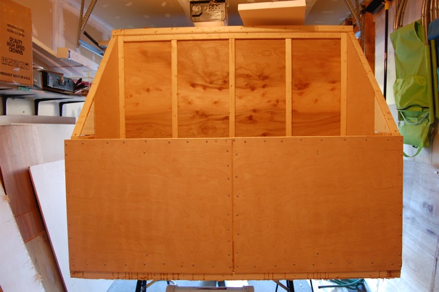

Postby adlibdrama » Fri Aug 06, 2010 6:21 pm
Here's the pics. Thought I had some of the wall being built, but I can't find them.
Walls are stick built, stood them up to glue the inside skin on, then laid them down again to fit the insulation. Stood them up again and glued and screwed them in place. The roof and front wall panels were built and then glued and screwed to the walls.
If you have any questions about how I built anything, I can take some pictures of specific areas.
