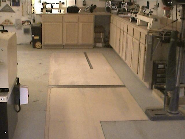

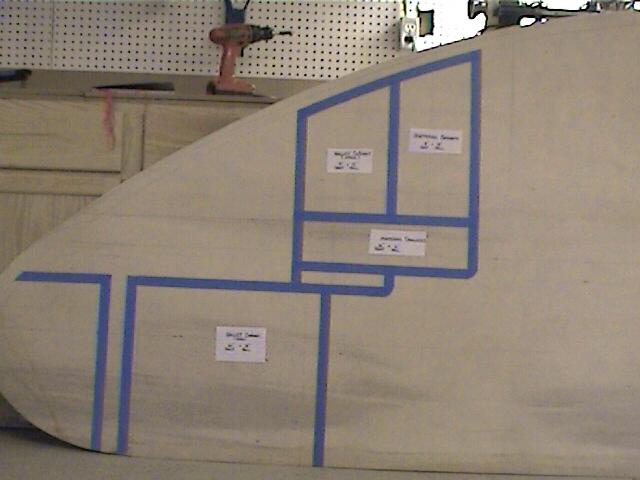

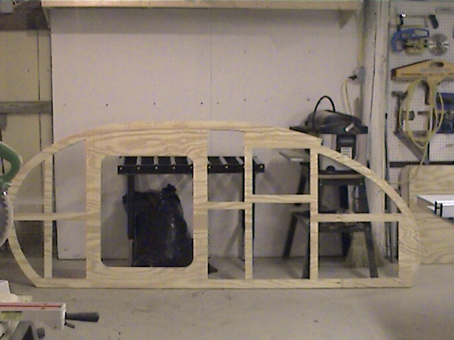

I finally decided to take the plunge today and get started on my teardrop :applause: All i had time to do today was layout the profile, cut it out to use as a template and mock up where i think i might want the interior and galley cabinets.
Here you can see the far end of what will be the profile template. :)
Shot from the other direction and yes that's duct tape ! hehehehehe.
Here is the rough cutout of my profile, I did something juuust bit different with the top curve. I used a 12' fiberclass tension bar to give the top a higher curve to it.
How does this layout work for both interior and exterior cabinets?

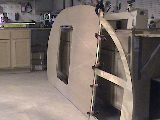

I finally got back on the TD this weekend !!
Postby Chuckles2153 » Sun Apr 18, 2010 7:53 pm
Well I'm finally over that miserable flu!!! and have been hitting the wood shop hard to try and make up some of the time i lost. Tell me what ye-all think, I hope to have both walls finished and on the trailer by weeks end :D.

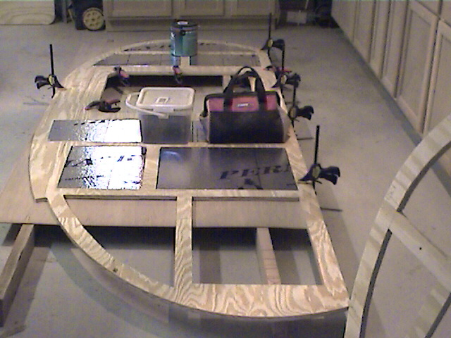

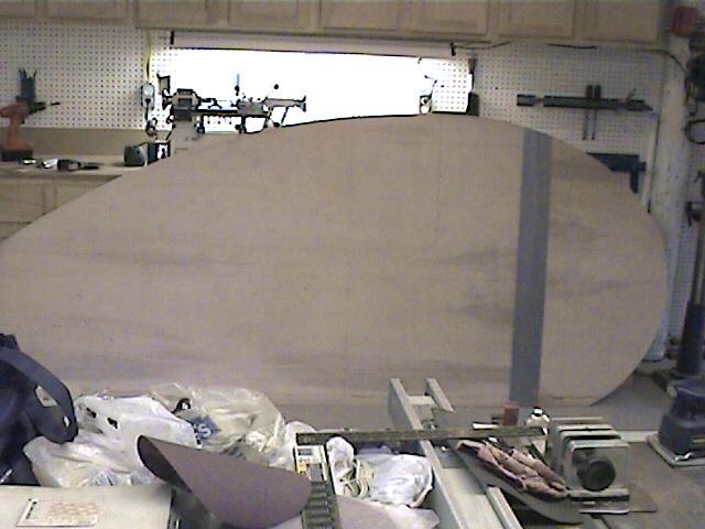

This is my profile all routed and smoothed out with allot of weight removed, The total weight at this point is 32-lbs.[/img][/url][/list]

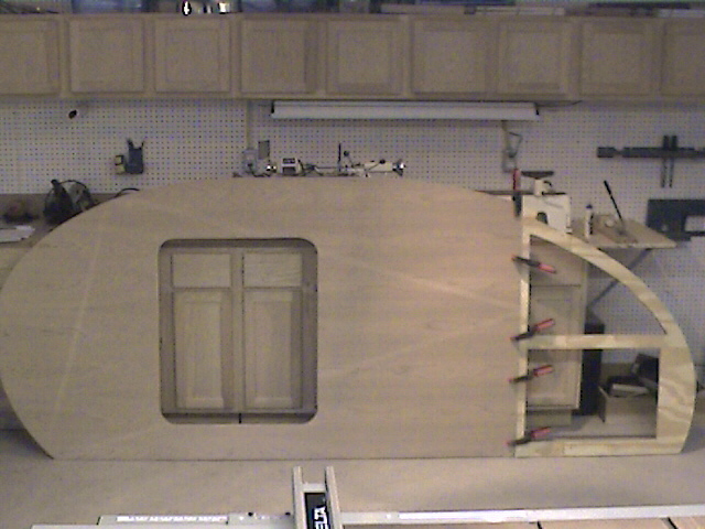

This pic shows the Styrofoam cut and in place and also the 1/4" Cherry plywood has been glued to the frame and clamped-weighted down. I'm getting closer !!!!

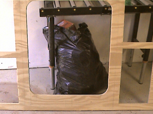

Here is a close up shot of my door opening it's 26" x 32" and will be 6" above the floor when finished.

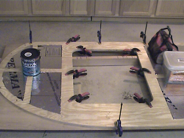

I routed the cherry ply to match the profile. The part that isn't covered will get 1/2" blonde wood there and then laminate over that.

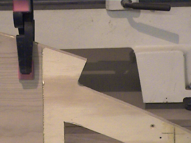

This is the offset for the galley lid, I wanted the lid to be stronger so it'll be 2" The center 3/4" ply will be 1/4" over and the outer 1/2" skin will be 1/4" under and the inner lining will be flush with the center piece. This way i can weather strip 1-1/4" and if water does get through it has to also travel upwards also. What do you think about how this will work?
This is a side profile so you can see the whole profile. :thinking:

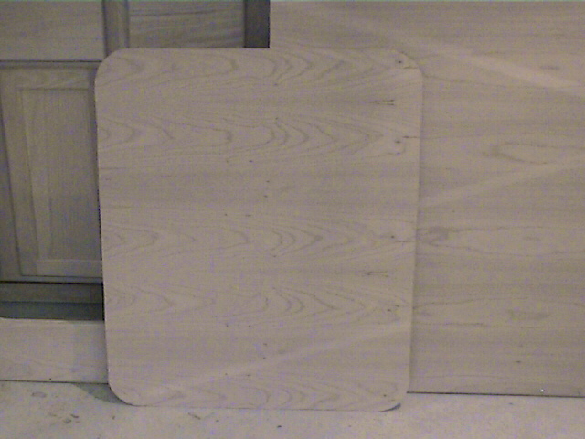

Now i do plan on ordering the tinted glass doors for my TD, But if i change my mind which i do aaallll the time i made a template to match the opening ! :) I may have been dropped on my head when i was a kid but i can st-st-still f-f-f-figure thinggggs out. :R

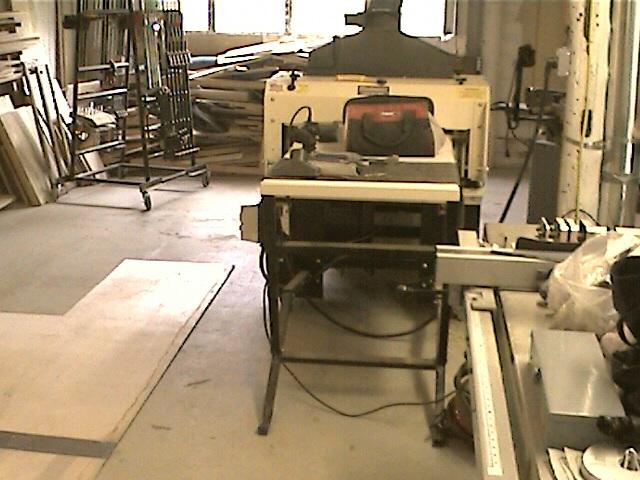

This is one very big bag of sawdust and Styrofoam !!!
