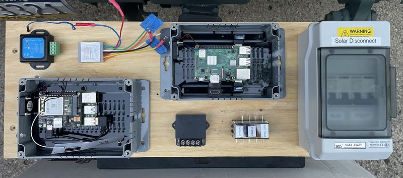

Thinking about how to arrange devices on the back wall of the passengers side compartment.
