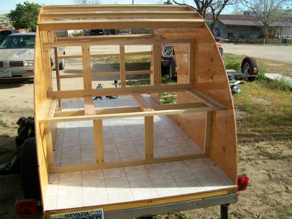

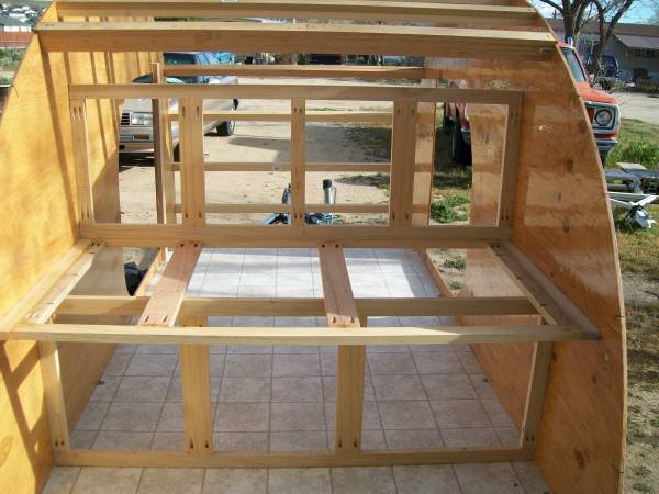

Hi everyone: Here is a mini-update for today. I have had an "H" of a time trying to get the counter made up and installed. I screwed up on my measurements as to the proper width to make it. I should remember the measurement is 47 1/4". Duh!!! I was able to save it by adding two 1x2s, one on each side. See, I am human and not a machine. I will admit it when I screw up. I try not to do that to often, screw up that is. :roll:
I need to go to HD tomorrow and get the oak boards to make up the face frames for the cabinets for the cabin & galley. I am glad I am about done with the frames for storage compartments. With this part of the build, my brain hurts. Not really, but it takes it out of you. I am tired though. :?

Postby grizz » Sun May 02, 2010 3:24 am
Hi Johhny, I am really impressed with your build, that frame up looks sooooo sturdy.
I love whatever tool it is you guys use to get the screws in at an angle.
Over here I just put them in skew, or countersing by hand and then sink the screws beyond the surface.

Postby down under tech » Sun May 02, 2010 6:46 am
Thanks, grizz & Rigsby: I used my Kreg jig to make up all of the frames for the cabinets. :thumbsup: Here is a link for the company. They have some more items that make this type of assembly very quick and strong. http://www.kregtool.com/index.php I used polyurethane construction adhesive along with the pocket hole screws, so it is not coming apart. If you have the right measurements and write them down, you can build about any thing with this set up. There is a couple of clamps that you will need to get to help assembly of your wooden frames as well as the jig to drill the holes. You can buy these tools on Ebay or check the company website for a location to buy one for yourself. I would imagine that this item is available in GB, too. Here the Kreg jig goes for about $100 US. I like their router tables, also. That will be the next thing I get from Kreg. I first bought the Kreg jig to make new kitchen cabinet doors for my house. I have not built the cupboard doors yet because I am having so much fun building the TD. That project got put on hold. :shhh:
