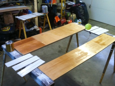

Trying to get the back end finished up, rain today so I got some of the last boards poly'd and painted. The short white painted pieces are some leftover waincote (not sure if I spelled that correct :thinking: ) that will be going up veritically behind the MW, or, that's the plan anyway.

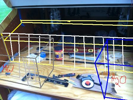

Below is a rough, I mean really rough sketch up of the galley lay out. There will be a wall behind the MW, a shelf extending into the sleeping area with just a stop to keep things from sliding forward. There is a curtain waiting to be hung across it to semi-hide it on the inside. Water container on the right, removable pull out sink below that. Pull out cooler on the left, storage on the right. Just a simple set up.

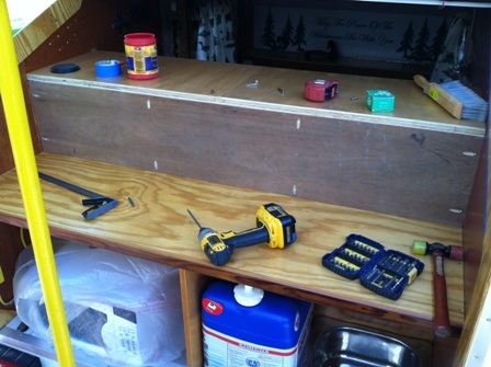

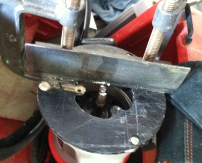

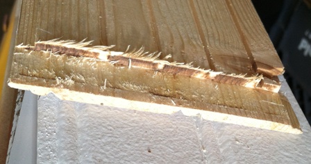

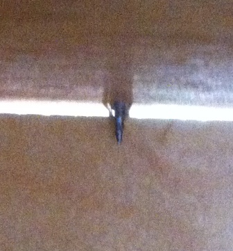

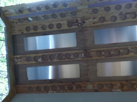

OK, remember this picture? Note the 2 screws going down in the middle.....
Well, I moved on to the next step of installing the boards to cover the back of the ply and hide the screws without looking inside to make sure everything was still kosher. :x
Guess I'll cut 'em off, there was only 2, and run some screws in from the bottom. :oops:
On another note, I picked up some of the white plastic "J" channel that is normally used to trim out the edge of FRP to use around the boards I was attaching to the back. One problem, FRP is only 1/8", boards are 1/4" :duh Duh! My solution was to route the backside of the boards to make it all work. Didn't feel like driving across town to borrow a router table, so I just clamped a piece of angle iron to my router and went at it. Still have 10 fingers too! :eyebrows:
Here's a pic of the end results

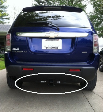

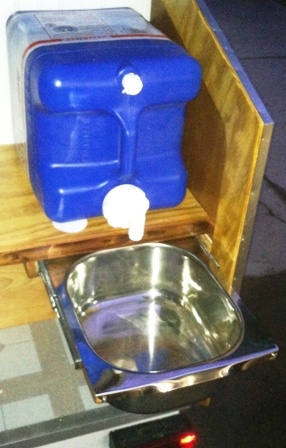

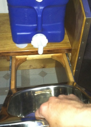

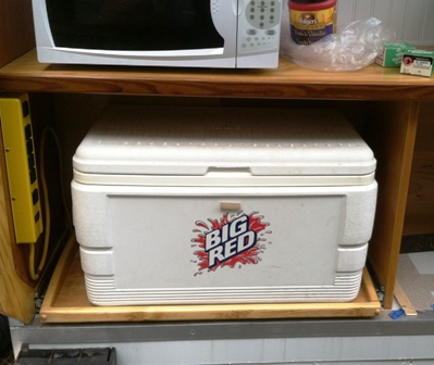

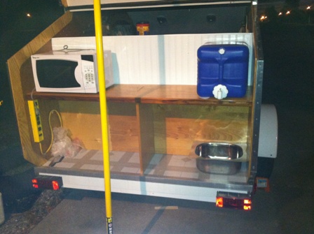

After returning from the auction, we got hitched! Ordered a complete package deal off ebay. Easy to mount on the Equinox, bolt holes where all there with factory weld nuts installed. Took longer to clean out the threaded holes than it did to install it.

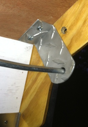

After "re-working" the hatch, I went ahead and re-did the latch as well. Put a little "English" on the latch rods and moved them forward so they would go into something with a little more meat to it. You can see the original holes (which I'll have to fill with ?) It's always nice to have extra "material" (al diamond tread) laying around to use. (actually picked it up off the interstate - hi, my name is whitney, i'm a pack rat)

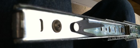

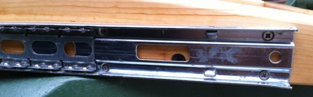

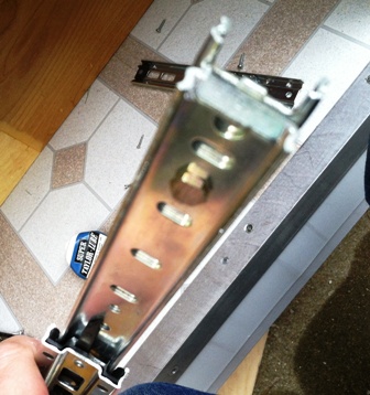

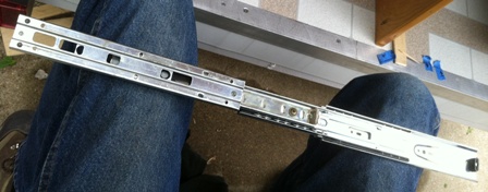

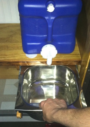

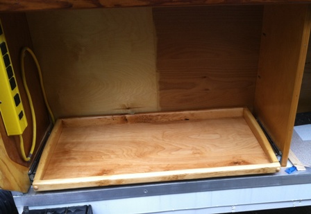

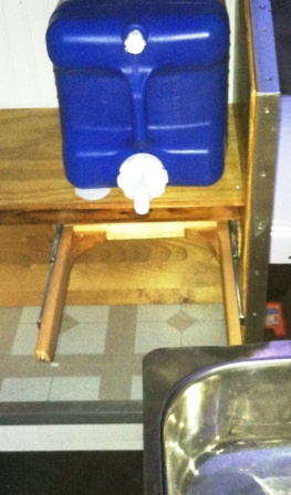

A friend gave me a bunch of the ball bearing drawer slides that extend fully, but needed a little more since they were only 10". Me being one not to turn away free stuff, figured out a way to make them longer. It's a little hard to explain, but I removed the largest section from one slide, flipped it over and bolted it to the other slide. Now, rather than having a 3 section slide, I now have 4 sections. Since the original middle part didn't have any mounting holes, I drilled and counter sunk some where they wouldn't be in the way.

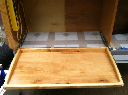

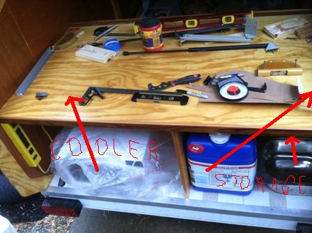

So, now that I have that mess hopefully explained away, the end result is this; the cooler drawer will now extend out far enough to get the lid open and it didn't cost me anything but some time. :money:
OK, now that the MW's in place (still have to figure out exactly how I'm going to get it to stay there), cooler / drawer is done, on to the sink......

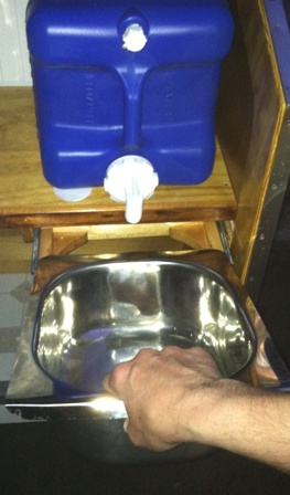

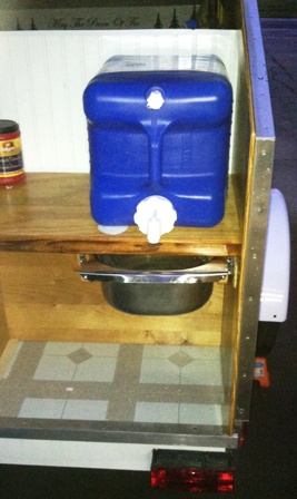

With the water supply sitting on top, I wanted a way to have a sink without "plumbing". Since I still had more FREE drawer slides :thinking: why not a pull out sink? Make it removable for easy "disposal" (dumping), and leave it out far enough so if the spigot drips, it'll catch it. Here's what I come up with, still need to work on the "quick release" system, but I've got it figured out in my head :?
Don't really have to tilt it that much to get it out, just exagerating for easy understanding? :wacky

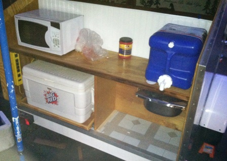

Anysomeway, here's where I'm at the end of Tuesday evening after the storm went through and had to quit for a while (rain delay) :rainy:
We've got a wooden box in mind for the storage under the sink area, just need to stop by the barn & pick it up.

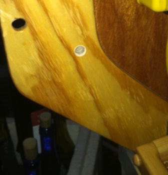

To fill the old holes from your latch rods, why not use wooden dowels, trimmed flush and stained to match the darker color of your wall panels? It would contrast nicely, celebrating the difference rather than trying unsuccessfully to blend it in and hide it by some other means. you could get real crafty and drill another hole symmetrically on the other side of your new diamond plate bracket, and it would look like the ribs were sections peg joined together like old timber framed barns used to be. Just a thought.

To fill the old holes from your latch rods, why not use wooden dowels, trimmed flush and stained to match the darker color of your wall panels? It would contrast nicely, celebrating the difference rather than trying unsuccessfully to blend it in and hide it by some other means. Just a thought.
KC, Good call, I took your advise, look close and you might be able to see the "repair". Used some pecan stain, it matched the luan on the walls :thumbsup:

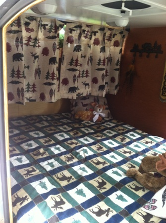

Thanks to my wife, here's some shots of the bed all made up and decorated, the view of the foot of the bed shows the curtains we hung to cover the storage shelves (sorry, no cabinets), and a shot of the curtains parted to show the shelves.

Glad the patch worked for you.
