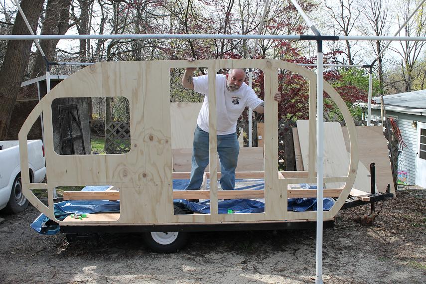

Today was a productive day, even if I only got half of what I was hoping to accomplish done. I laid out the plywood for one side, cut the channels and butt joined them. I did learn something interesting today. When you measure twice and cut once, you second measurement always confirms your first measurement was fine. It does not confirm that you can read your own handwriting on your plans. :x
No problems created, just some extra pen lines while doing my layout. :D
So, we now have a profile!
After fitting the hatch for the pull out kitchen, and locating the window opening, centered over the bed, and making sure there was wood everywhere I would need to screw into from inside, I started cutting away excess which will get insulation. So now we have a cookie cutter wall!
I don't know who that old guy is holding up the wall. :roll:
The door cutout will be cut flush to the floor eventually, but for the sake of holding everything together, I left about three inches down there. I still have a little more I can cut away around the window area too. I planned it out that the interior paneling joints will fall in different locations from the plywood joints, so once the inside walls are on, it should be very solid, and of course get even stronger with the addition of the outside walls. I've decided on birch paneling for the interior walls. It's really expensive, but the stuff in really beautiful. I just can't see using cheap paneling.

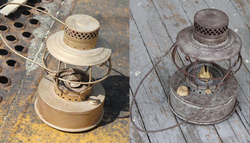

I picked up an old lantern that I want to convert to LED's. It was painted an ugly gold color, so I sandblasted it today. There was some red paint under the gold in some areas. I'm open for suggestions on how to finish it! I was thinking of forcing it to rust a little, and then clear coat it to stop the rust. I also thought about one of those "hammered" spray paints... So here's the before and after pic.. and suggestions please!

Sharon, actually it's 4' ply. Three sheets butt joined and cut down to 5' 1". Don't ask me why I added an inch, I don't have an answer, but when I started cutting this morning I decided to add an inch, so the interior height will be 4' 11 1/2". :lol:

Say, how wide is that door opening?
Looks a little smaller than your Sketchup model, or is that just me? Do you have to slip through sideways or is it shoulder width plus?
Great day of progress for us both. Congratulations on the major hurdle of getting your profile cut. Hope that extra inch doesn't come back to bite you. :roll:

The door in the pic is only cut to 18", as you can see by where my left hand is, I have several more inches available to widen it. It will probably end up around 22". Again I was nervous about taking away too much material while the wall is in a fairly fragile condition. You'll also notice the black line near my left hand. This is where the 4' paneling line will be. The seam for the plywood that I am holding is right above my head, and another seam in the middle of the window. I measured 4' from the front for the plywood, and will measure 4' from the back for the paneling so the seams will not overlap. The overall length is 10' 9".

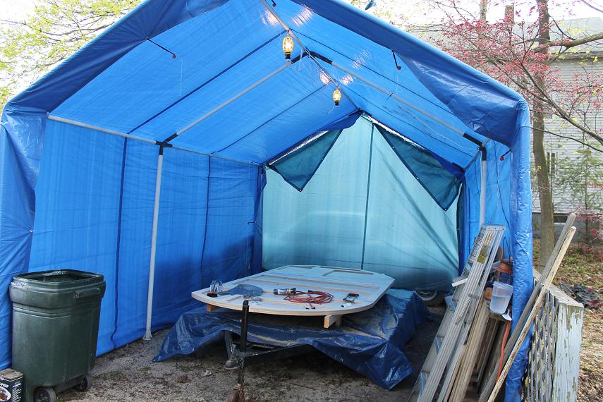

I did not accomplish anything on the build today, but I did get my shelter up, including lighting! Rain or shine, day or night, I can work when the spirit moves me!

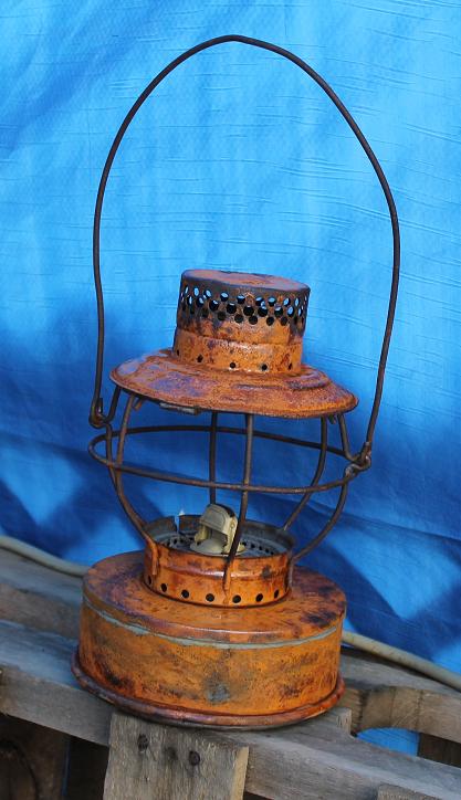

And I created a home made rust agent, 80% hydrogen peroxide, 20% white vinegar, and two teaspoons of salt. I rubbed this onto my lantern and came up with this! Tomorrow I will clear coat it to stop the process, and keep my hands, etc, from turning orange. It should darken up just a tad when it is clear coated.
The next step will be to find something to use as a globe, and install the led lights that I have with a switch.

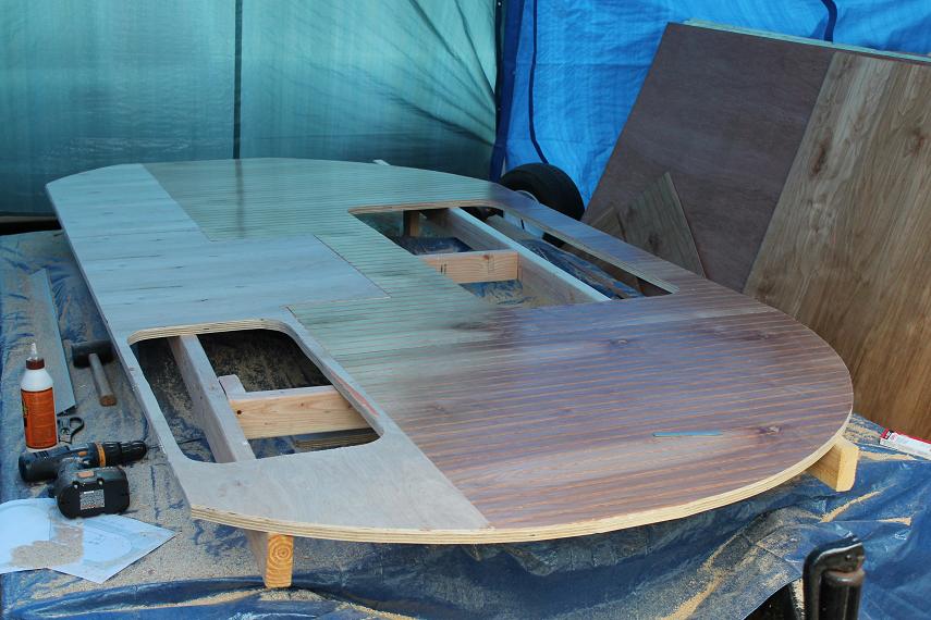

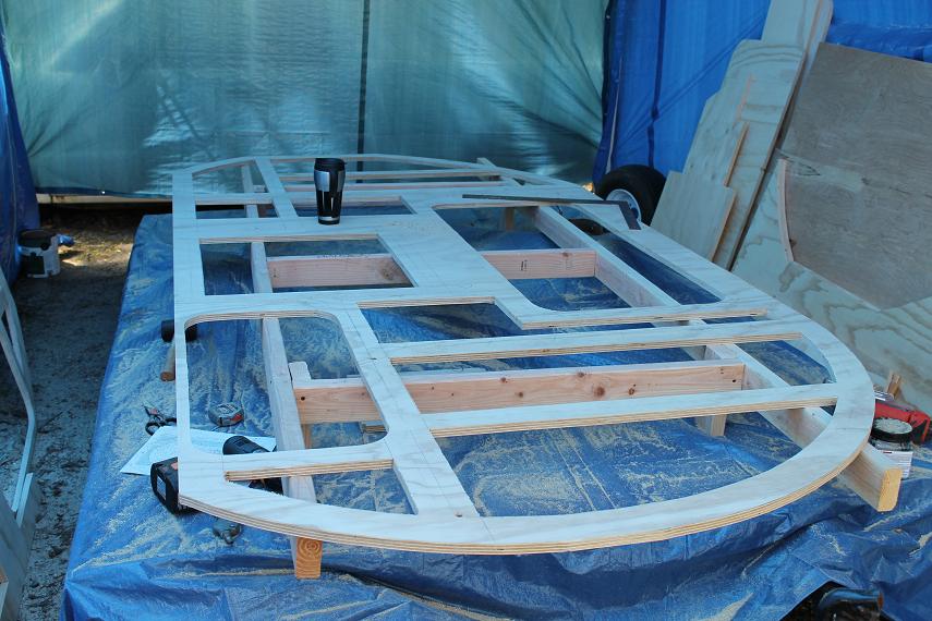

Today's progress.
Several days ago I got the left wall assembled and glued. Today I cut out as much as I could to reduce weight, and give me somewhere to put all the insulation I bought. So here it the picture of the left wall all cut out.

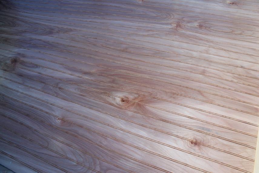

I decided on the birch paneling for the interior walls. It's a bit pricey, but by not paneling the hidden areas, I was able to save about half the cost. So far, only three sheets, at 40 bucks a pop. It does look really nice though.
And the last picture, the profile all cut with the router, and the window and the hatch holes cut.
You'll notice the different paneling on the lower side of the wall (left side of the picture). That stuff is 10 bucks a sheet. It will not be visible at all, it is hidden by the bed, the cabinet that houses the furnace, and the bench seat.
