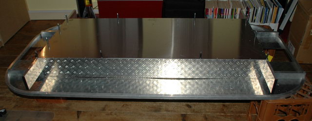

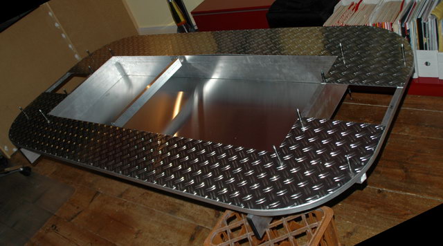

33: Stainless Steel Micro-Airstream behind motorcycle
Postby ST1100 » Sat Mar 23, 2013 12:09 pm

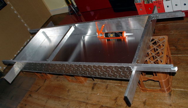

Yesterday I got the bottom of my box !
Clecoed it today underneath my alu bars.
The left will become my baggage compartment, the bigger right will get a well to step in, that I can pull up during towing.

34: Stainless Steel Micro-Airstream behind motorcycle
Postby ST1100 » Sun Mar 24, 2013 8:51 am

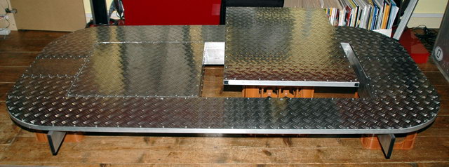

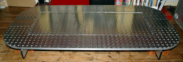

Drilled and deburred today all the holes for the connection between frame and deck ...
... and glued the deck with polyurethane Sikaflex 221 onto the frame and set all the rivets.

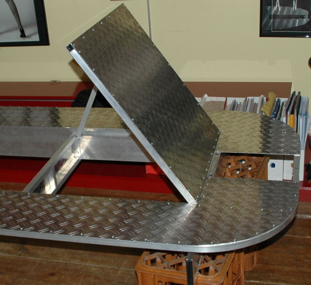

35: Stainless Steel Micro-Airstream behind motorcycle
Postby ST1100 » Mon Apr 01, 2013 4:19 pm
Long weekend and the polyurethan glue had time to harden last week !
I had to take away the front and rear bar because I forgot to seal between frame and bars with PU.
Glueed the bars now with PU to the frame and riveted all together again.
While the PU had time to harden, I built the lid for my baggage compartment.
It has to be solid, because I will sit and sleep on it later.
then riveted it with piano hinge to my frame.
Today I built the small wall, upon which the baggage door will rest and the support angles left and right.

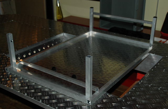

36: Stainless Steel Micro-Airstream behind motorcycle
Postby ST1100 » Tue Apr 09, 2013 4:30 pm

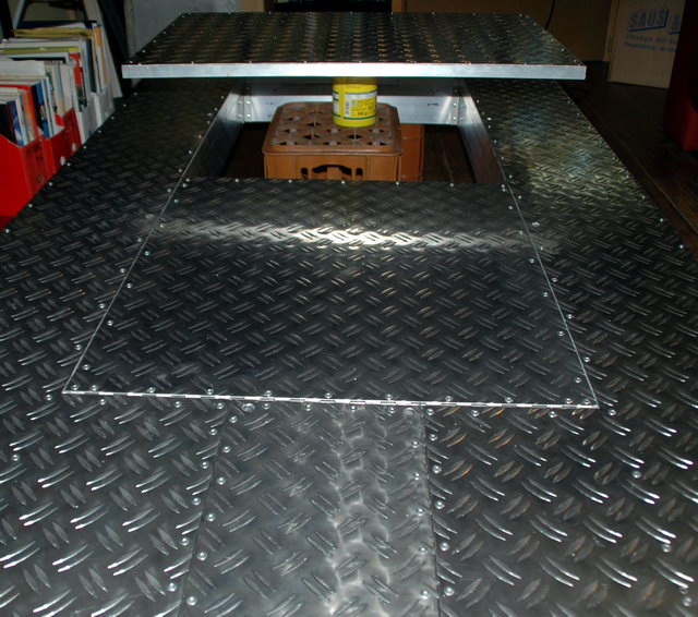

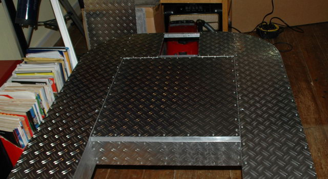

Okay - a weekend without work, celebrating my past birthday at saturday with family, friends, pies, coffee and lasagne :) and at sunday with a great breakfast :)
But now I closed the two holes at the end of my deck with small sheets and the big hole with a tabletop.
Have to build folding legs for the tabletop which fold inside the frame when I sleep upon it.

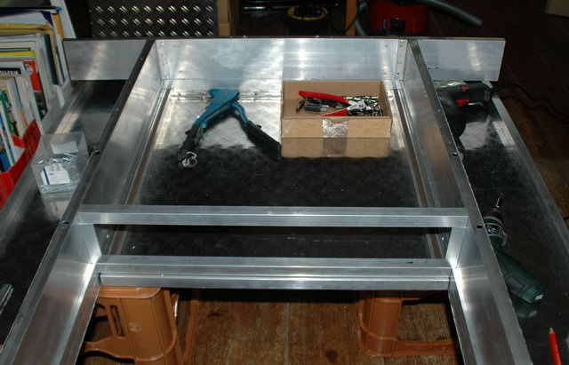

37: Stainless Steel Micro-Airstream behind motorcycle

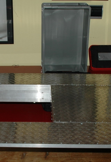

Postby ST1100 » Tue Apr 09, 2013 4:40 pm
The grey plastic box will become my step in bay, which can be lowered to the ground below the table to sit in a comfort way.
the connection between trailer and box I will make from tent fabric to prevent mosquitos from visiting my legs.

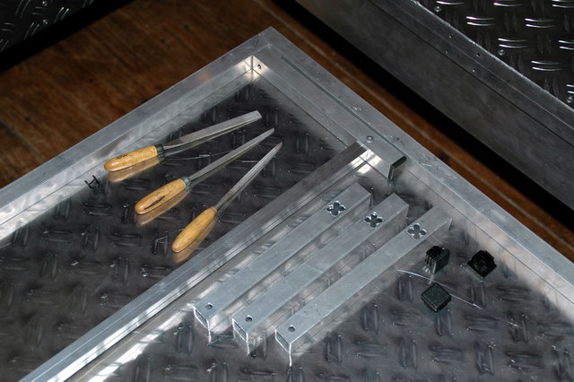

38: Stainless Steel Micro-Airstream behind motorcycle
Postby ST1100 » Thu Apr 11, 2013 3:35 pm
Making the legs for the table is painful and needs much time with my tools !
:cry:
But the result will be satisfying ! It's worth the annoying work !
Cut the four legs and drilled the holes for the screws. That was simple.
But to cut a rectangular hole in which the crossbar fits perfect was a hour work.
But only three more to do !
The second one was faster - maybe tomorrow follows the second double leg.
