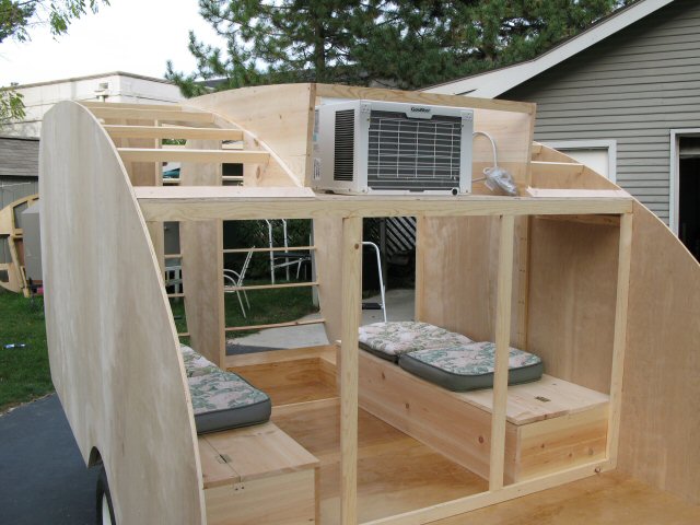

Postby mikeschn » Sun Jan 01, 2012 3:10 pm
Looking good Zach!
Just wondered, are you planning on adding some wood strips to support the outside skin? See pic...
A little like this...
Images: 479

Postby absolutsnwbrdr » Sun Jan 01, 2012 9:02 pm
Thanks everyone! Definitely helps having a few extra hands!
Mike - I think the spars that are there will be enough to achieve a smooth curve. We got the pieces cut tonight for the outside skin and since they're only 6" wide, they curve really nicely.
