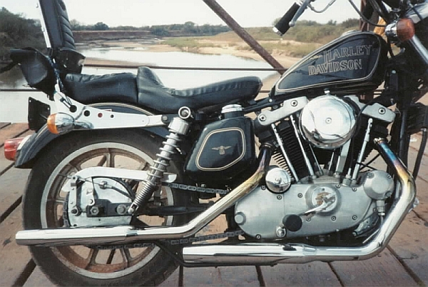

Today was absolutely gorgeous and I enjoyed a ride in the country on my 78 Harley Davidson Sportster. It's a 75th anniversary edition model that I restored,,, complete basket case. Got a lot of thumbs up from folks who enjoyed seeing an older HD on the road.

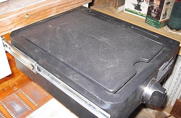

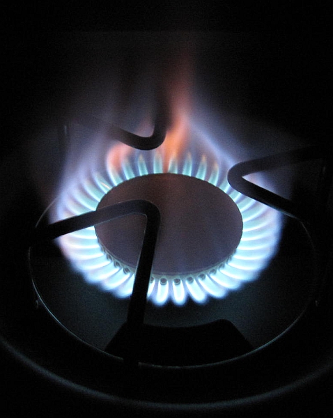

This is the burner I'm using. Originally intended for use as a side burner on a full-size grill.

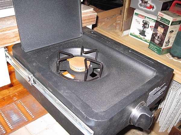

I used full extension slides for mounting. This allows the lid to flip up once the burner is fully extended. I mounted the slides directly to the unit, no worries of catching a support tray on fire. No wobble when extended, it's very sturdy with the 100 lb. rated slides. Allowance was made for the propane cannister to fit without contacting the a/c plenum. Part of the fiberglassed drip pan for the a/c can be seen.
Lid open
Simmer
Full blast
I think I'll really enjoy this, it's so simple to use. Pull out the unit, lift the lid, rotate the knob,, that's it. Auto-ignition. I believe it's rated at 10,500 btu's, should work great! Later, I may route black pipe from a tongue-mounted 20 lb. tank. For now, this will work.

Postby Cliffmeister2000 » Wed Dec 15, 2010 12:06 am
That's really nice, Gary! :thumbsup:
I'm guessing you chose slides with a 100 lb rating. I'm curious how stable it is with a big pot of boiling water on it?!? :thinking:

Postby StPatron » Wed Dec 15, 2010 1:58 am
Cliffmeister2000 wrote:That's really nice, Gary! :thumbsup:
Thanks, Cliff.
Yes, those are the 100 lb slides. I tested it in the full extension position and it's not going anywhere. No slop in the tracks and no downward tilt. I'm using the same slides for my cooler and am very pleased with both applications.
If a big pot of boiling water goes down,, the tongue will be pointed skywards. :lol:

13-1/2" wide, 16-1/4" deep, 4-1/2" high. That height is the burner unit alone without the disp. propane cannister installed.
The top actually has a nice finish, I forgot to clean up the sawdust before snapping the pic. The corners on the left side are radiused, the corners on the right are squared,,,, it's designed to attach to the left side of a grill. I had concerns about insetting it into the countertop (clearance/fire and cannister access) and therefore decided to go with the slide mount.

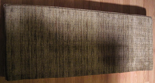

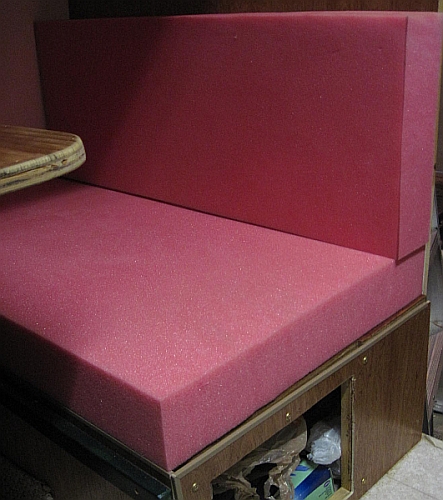

Cold in the shop today, so the back-up plan was to work inside sewing the dinette cushion covers. I selected a medium-high density 4" foam and had the supplier cut the pieces to size. That worked great, no ragged edges. I did one last check of the fit and was pleased. I think the 4" thickness will provide me with the desired combination of both comfort and table clearance for my legs when seated.
Dewey enjoyed helping with the paper pattern cutting.
I've done a bit of sewing but never attempted major upholstery work, so I spent some time last week researching online. I like the challenge of learning something new. I decided on a box cushion style without piping and began cutting out the material, then sewing. Dew quickly lost interest, hopped up on his perch and snoozed while I worked.
This is back cushion #1. I still need to add the zipper panel and detail the corners but I was anxious to see how it fit and looked. Almost one down, three more to go.

Postby S. Heisley » Sun Dec 19, 2010 11:31 am
It looks like you're doing a good job on those cushions, Gary. I hope mine turn out as good! :thumbsup:

Sharon: I know your cushions will turn out fabulous, just like the rest of your camper! There are so many nice fabrics to chose from, I saw a tapestry on eBay that was to die for,,, but, it wasn't in the budget. The "plain Jane" remnant piece I used wasn't large enough to cover all the cushions so I pieced in a different material on the backs/bottoms. Keeping the two different materials aligned properly was tough but worked out ok. I finished the other back section today and started working on the seats, I'll post pics of all the cushions when they are completed.
I didn't realize there were so many foam options. 4" seems to be the standard thickness, then there are varieties of density and compression. The salesman had samples and he would put them on a chair for me to test. It became rather amusing. :lol:
