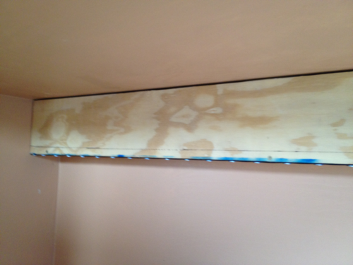

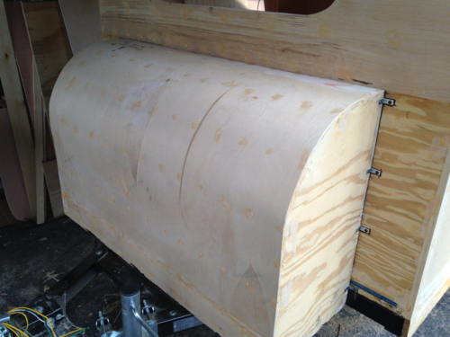

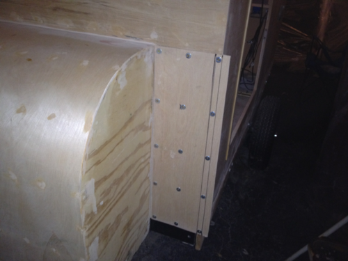

You got a lot going on there brother! :? Unless yur a lectrician, help with lectrical is good.
Are sure you have enough screws on that living hinge?

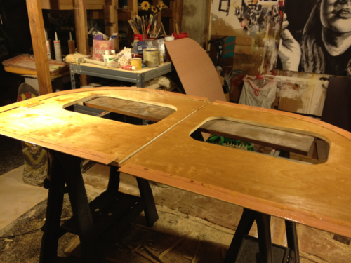

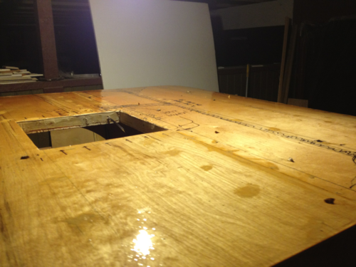

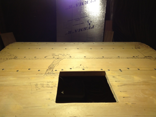

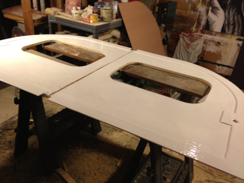

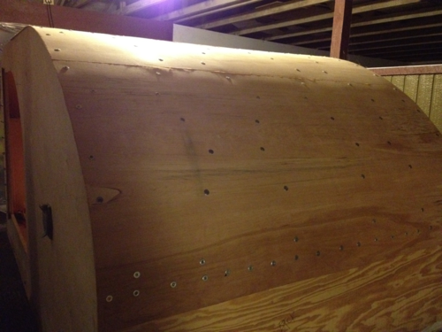

and here's what i got done since last post...
not glued yet...
nor is this...
we're camping saturday nite, but the girly girl is gonna help put a smack-down on the glue-down either tonite or sunday when we get back.
dun!

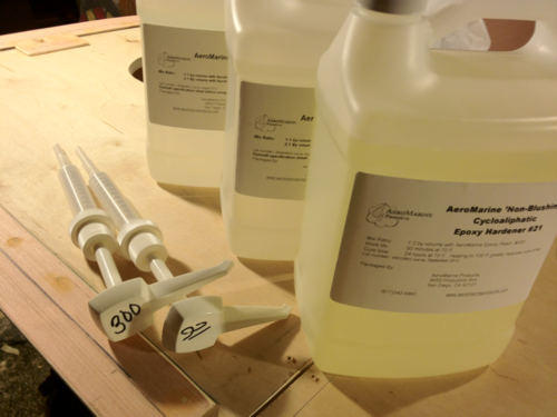

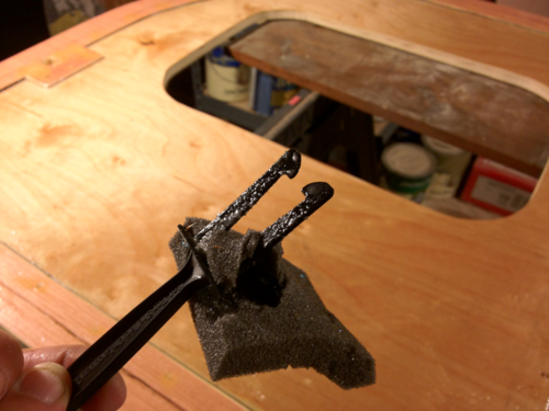

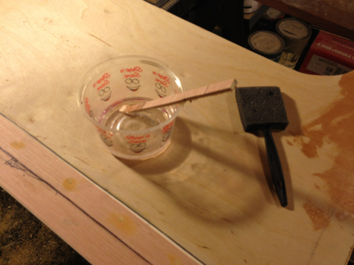

and started messing with this stuff last nite...

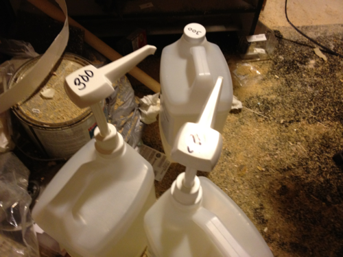

honestly, after reading so much stuff on here i was a bit apprehensive about jumping into the epoxy stuff... worried i would screw something up. i've used the little 2 part epoxy syringe thingys from the box stores before to glue random small crap together but due to t&ttt information overload i thought this was gonna be difficult...
annnnd... IT'S NOT. it's simple. the aeromarine 300/21 that i bought has pumps that precisely add 1oz per pump... so it's 2 squirts from the 300 bottle & 1 from the 21, mix with a stick & apply... a little while later it's plastic.

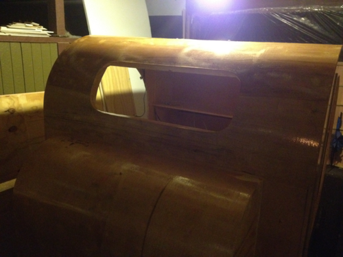

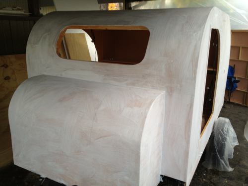

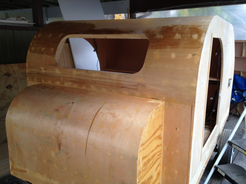

went to sand ridge state forest illinois one weekend & eureka springs arkansas the next so progress has been a bit slow for a couple weeks. i did get the whole camper shell finished & epoxied though (except the galley lid) so i'm hoping to prime it tonite.
eureka springs...
front box attached...

apparently moths love epoxy...

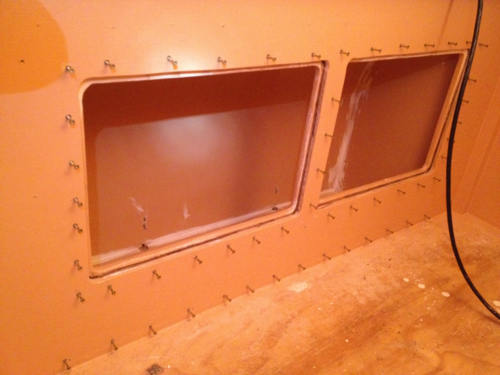

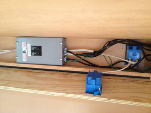

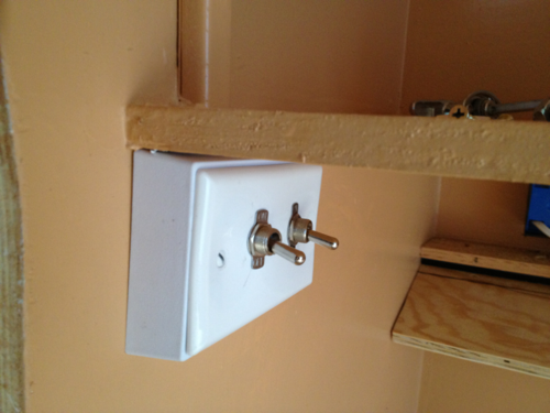

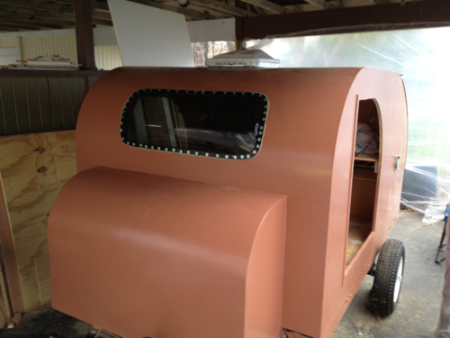

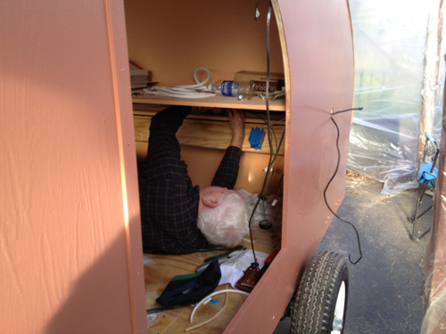

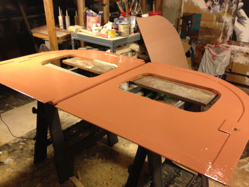

got some more stuff done... primer, paint, more epoxy, most electrical, vent, front window...
no screws thru wires! YAY!
so anyway, i still have A LOT of little things to do but my goal is to knock those out this week & have it campable by this saturday. there's a 40% chance of rain so i wanna test it out in a few showers to see if there are any leakity leaks in a state park that's like 15 minutes away... plus it's supposed to be highs/ lows in the 60's/ 50's which is pretty weird for st louis in mid november so i figure we might as well take advantage of it...

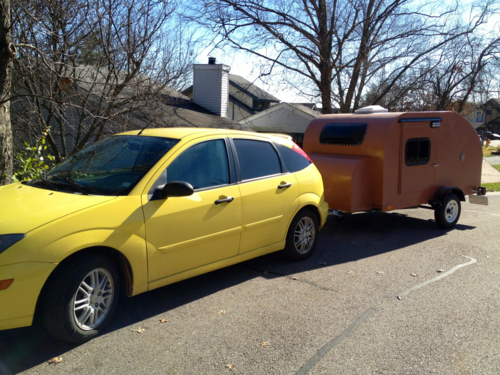

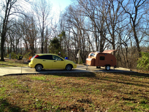

we took it out for the first time thursday. i was ANXIOUS. i hadn't built anything this big before, much less tried to tow it... i'd never towed anything before...
so.....
*deeeep inhale*
here goes nothing...
result = it pulls like buttah! bouncy on neighborhood streets, but smooth as silk up to 55+ mph on more major roads. i wasn't trying to push that too much cuz the tires that came with the trailer are rated at 45 mph. i need to get new ones before spring.
also, it's no lie that these things attract attention... we paused the first 20-30 mins just meeting walk-ups and explaining how it was built.
i kept saying "naw, this is just a test... it's not done yet..." :rainy:
