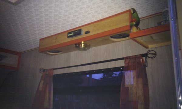

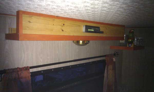

Well had to get on the stereo install,
matched it up with the breakfast bar.
Still not complete but the basic cab is built, trying to decide now whether to get another stereo with an Ipod dock or maybe an Ipod fm transmitter.
Then I need to put a master power switch in the cab for battery saving.
Also need to make up end plates, not sure on solid or ported ones...

Hey Chris what about another set of speakers on the end
Looking really good so far..

I think that's a wise question to ask about porting them. And I think I would but maybe do the whole end with just speaker cloth material. And you have so much surface area on the front there, but what to do with it that doesn't vibrate. I was going to suggest putting in cabinets, paint on decals of deer and scenery... sonar/radar displays? Fish trophies (watch the vibrations) cd rack (vibration), how about muffled storage items in the side area, toilet paper, towels, clothes, blankets.
Maybe just put foam packed into the cabinet between the stereo and the speaker on each side. That would improve your sound separation by pushing the extra sound out the side of it's respective speaker, instead of leaving the whole thing hollow and having a canceling crossfeed of air pressures. (common cabinet for both speaker channels without separation.)
(boy, now you really do have a big boom box! :-)

You can design the port size using the link below If you can find the speakers Thiele-Small Parameters.
How to Size Speaker Enclosures

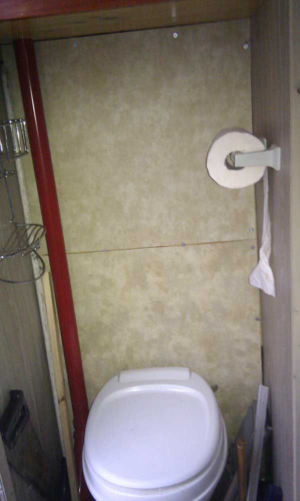

Man this has turned into a labor of love and a chore
Finished the removable wall behind the toilet today, removable so I can get to the plumbing

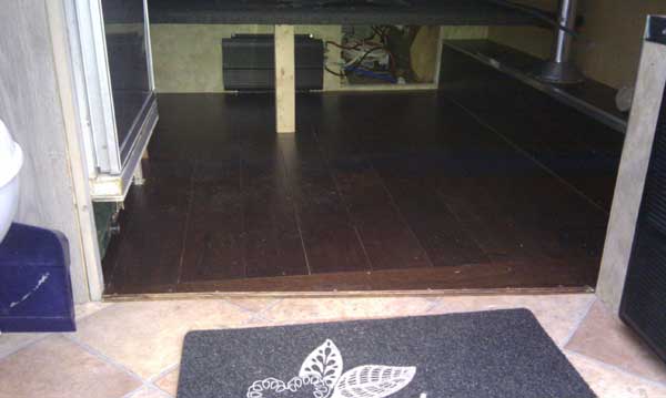

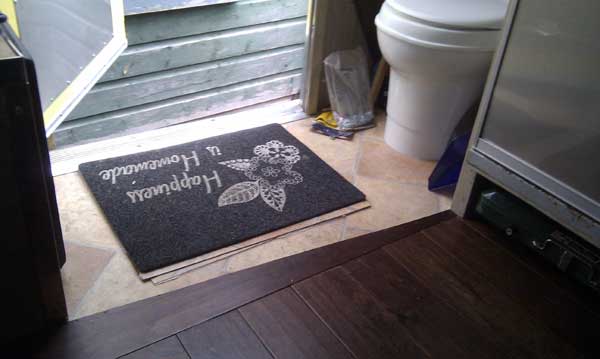

And had an issue with my plywood in the middle of the floor that was buggin me, must have been a void in the ply that was causing a major depression in the floor, wouldn't have been such an issue if it was off to the side, but it was right in the middle, so I cut out the lino :(, and then PL'd engineered hard wood down, left lino inside the entry door and under the toilet, that makes the floor over an inch thick, should be strong enuff now.
Hardwood was a freebie though, neibore at the campground is a finish carpenter and was chopping it up to burn in the campfire, leftovers from a job he did, i caught him while there was enuff left to do my trailer, he'd already cut up 70 square feet of it before I stopped him....

Postby PcHistorian » Mon May 07, 2012 2:06 pm
wow, the floor looks fantastic.

As for the floor, it is prefinished so it has a poly coating on it so should last the life of the trailer
