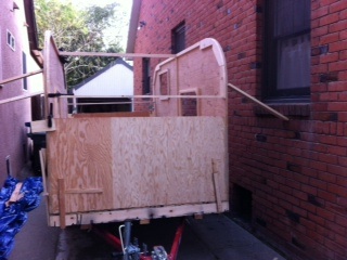

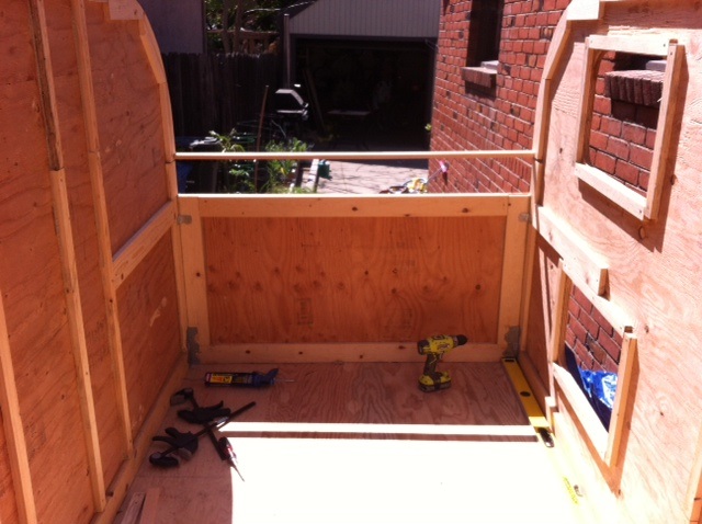

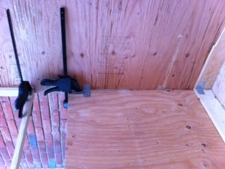

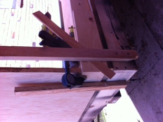

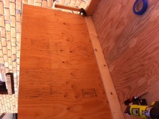

Started building up with the bulkhead walls. I put in 2x2 pieces screwed into the subframe to create a channel for the walls so it would give them support and point at which some pressure could be placed against the wall and framing to secure it. Also makes it easier for me to work on since I mostly work alone.all walls are glued with PL and screwed into the framing.

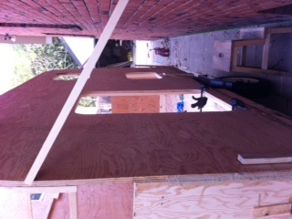

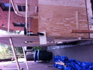

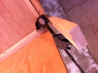

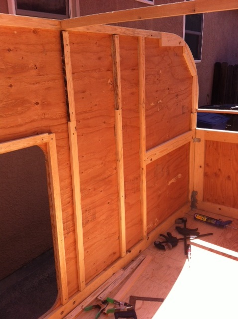

I installed the exterior sidewalls. It was a two person job to lift them above the 1x2 I used to create a channel to hold them in place and lower them into it. They sit in the floor. They are glued and screwed into the1x4 framing on the floor and glued on to the floor itself. To form the joint I used two pieces of 1x4. One piece attached to the sidewall an overlapping the second piece to the bulkhead wall. The framing is glued and screwed to the walls and where they join each other. I screwed in from the outside to secure the walls and framing using either 1 1/4 or 2 inch exterior construction screws depending on what I was securing. I used A lot of PL everywhere. To build tension against the joints I used scrap wood pressed between the house and the walls on both sides, clips where possible and shims. See pics.

Postby mariannf » Sun Mar 27, 2016 11:39 am
More pics of sidewall installation
I also put up three spars for some additional ability and to be sure the walls were drawn close in enoug. The spars are cut to 57 inches using 1x2 installed 2-side running up and down. I put enough cross pressure on the sidewalls so that the spars can be just placed in and not drop. I put one spar on each end about 6 inches above the bulkhead walls and one at 60 inches in or at center. The total width across is 60, and the sidewalls are 3/4 and the framing material is 3/4 actual (1-by nominal), so that required the spars be 57.

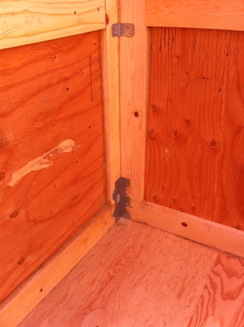

I finished the framing this weekend, and also reinforced the corner joints where the sidewalls and bulkhead walls meet (it was just bugging me that they weren't reinforced). I used construction ties at the top and bottom, and used 1.5 inch screws so that they went through the framing and into the sidewalls. Note: the bulkhead walls are 30 inches high. In the drawn plan a few pages back they appear taller (i was going to go to 40 originally). I decided on 30 inches to save weight. The bunkbed will be framed from 27.5 to 29 inches using 2x2 for the ledging attached through the inside skin so i didn't want to go less that 30.
