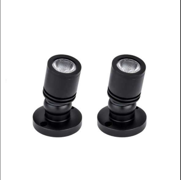

My substitute reading lights turned up. They are fantastic. $17 a pair, and absolutely tiny.
No bigger than my thumb. Very bright. I measure the current draw at ~80 mA for one.
new reading lights.JPG (26.23 KiB) Viewed 377 times

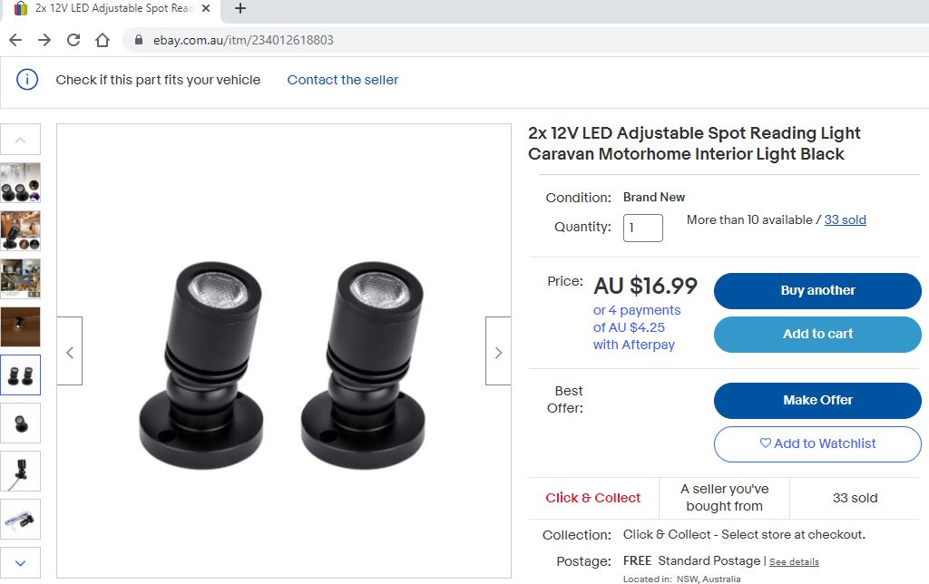

MickinOz wrote:My substitute reading lights turned up. They are fantastic. $17 a pair, and absolutely tiny.
Hope your back side improves quick! Do some light stretching when you can to help.
Do you have a source for these lights? They look pretty nice!
Tim
Niagara, WI
TimC
Posts: 1439
Images: 751
Location: WI/MI border
Re: Now the fun starts
Postby MickinOz » Thu Feb 10, 2022 9:12 pm
Ebay buy, Tim.
So small - base is about 32mm in diameter.
I'm assuming the US has access to the same stuff we do?
