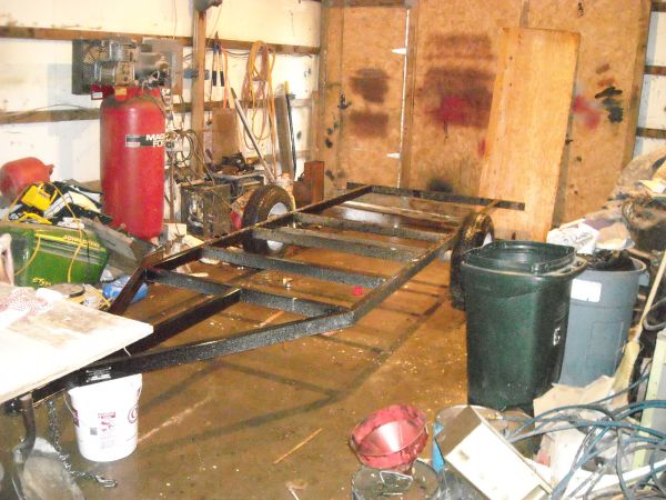

Postby RAYVILLIAN » Thu Mar 11, 2010 7:43 pm
Well I picked up the frame this morning. This is going to be interesting the the frame takes up most of the shop. Boy 12' is long. I had to pull it back to the shop by hand through 50 yds of squishy mud. :cry:
Gary

Postby Miriam C. » Thu Mar 11, 2010 9:39 pm
:thumbsup: :applause: And a beautiful frame it is! Looking forward to watching this one. :thumbsup:
Postby starleen2 » Thu Mar 11, 2010 9:40 pm
HA - now I can find where you live Gary! - I'll just look down from the google satellite view for your city and find the only workshop with a 12 ft long trailer sticking out the end! - Really - that's a good looking start you got!

Postby RAYVILLIAN » Fri Mar 12, 2010 7:59 am
Actually Starleen the google map is at least a year old. I've been trying to see a $2 million house that was built back in the woods a mile north of us and there is always a convenient cloud over it, but the bakery/winery where I make pizza Friday night has had a patio cover on it for over a year and it isn't there yet. If you find my house though the white blob on the southeast corner is the old Winter Warrior.
GAry
