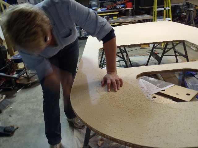

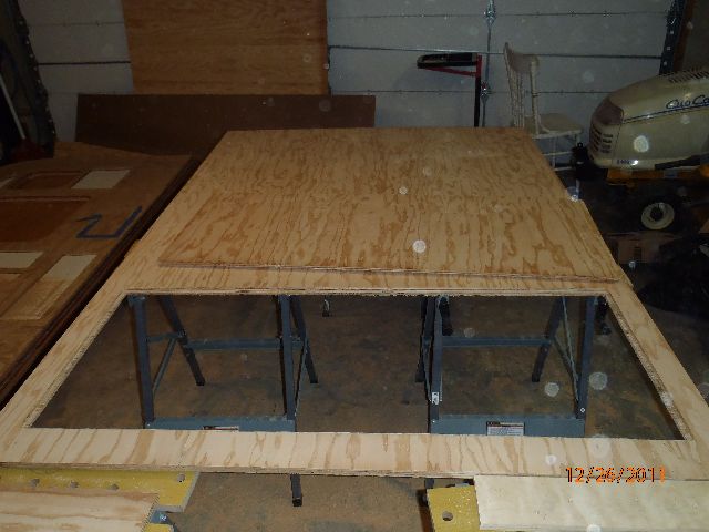

So here's the write-up I promised.
I had a three day week-end to work on the trailer, unfortunately, my hubby only had Sunday off. He helped as much as possible, but I ended up enlisting help from my teenage children quite often. I don't know how any of you out there are able to build by yourselves, its exhausting ! You solo builders have my admiration.
My 14 year old daughter turned out to be an excellent glue spreader, as well as being able to handle her end of the 5x10 sheets of plywood. My 16 year old son cheerfully lent a hand as well when I could pry him away from his new video game. (as if battling dinosaurs is as fun as this.)

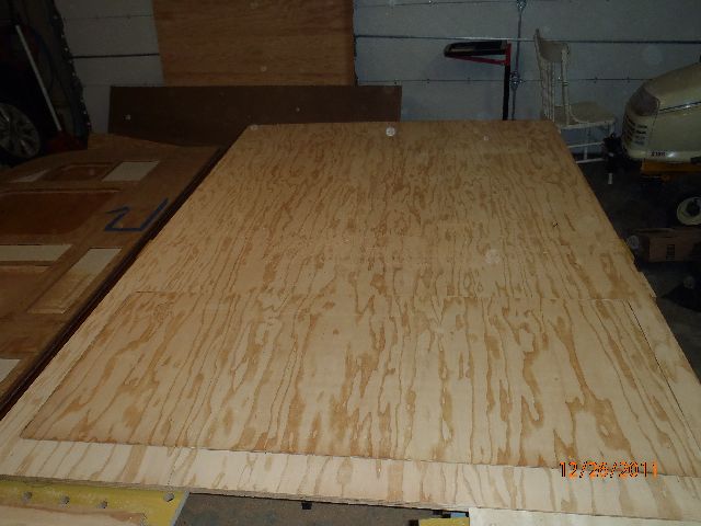

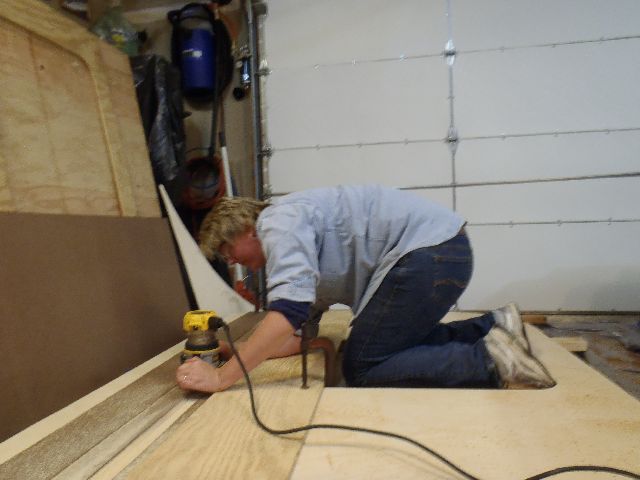

We finished gluing the 5x5 plywood to the inside of the first wall.

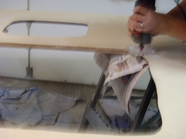

After sitting overnight I used the flush trimmer to finish the edges.
Sorry for the lack of focus. It looks ephemeral doesn't it?
Then I used a sanding block (old school) to tidy everything up.
I'm trailer building so fast- I'm just a blur!
Then I routed the dados for the bulkhead and bedroom floor.
(This router makes my butt look big.)
Close-up of router jig.

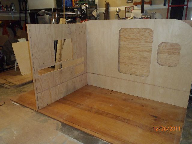

Then the layout for the bulkhead. Captain Morgan helped with this. (I definitely need to double check my work in the morning.)
Next day: fenestration.
Cutting out the access panel for the spray-away and fill.
Bulkhead in situ.
So far so good!

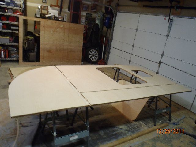

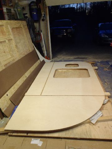

Next : cutting out bedroom floor with access for water tank.
Holy hole! That's a whole lot of hole!
Now with the hatch cover:
Is it still a hole when it's filled??

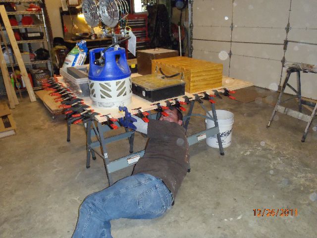

Last chore for the evening. Gluing baltic to the bedroom side of the bulkhead.
That's my husband crawling around on the floor wiping up drips. What a trooper!

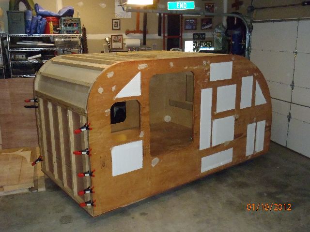

Even though I haven't posted anything for a couple of weeks, we have made some progress. New years weekend brought with it some very mild weather. Even my flowering quince thinks its spring.
Christmas Quince?
My folks were in town visiting ( from northwestern Pennsylvania) so we were busy eating and drinking and card playing. James had a couple extra days off work so he was able to get everything sanded and prepped and then applied 3 coats of polyurethane ( the fast dry variety by Minwax).
It was fortunate that it was warm outside so the garage didn't get too fumed. However gnats seemed to find it irresistible. We didn't figure that bugs would be a problem this time of the year. Luckily they weren't too deeply stuck so we could just sand them off.
This is really expensive fly paper.
Then it was back to work for the rest of the week.

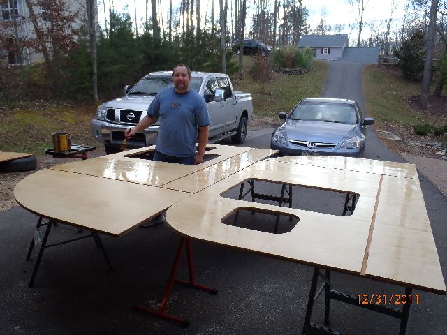

Last weekend we made a trip to lowes to buy some 2x10x10s and some luan. They were out of cabinet grade plywood so that will have to wait for another week. When we got home we ripped the 2x10s into 1 ½ inch spars and 3 inch studs. I then traced and cut out of ¾ inch plywood the supports for the curved sections.

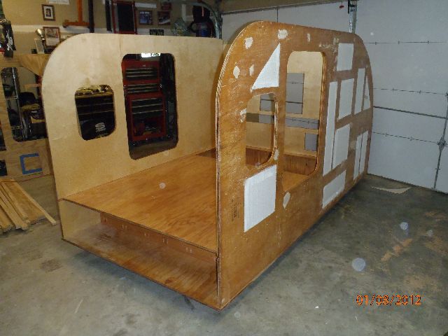

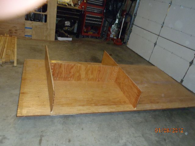

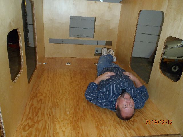

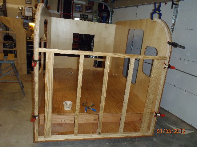

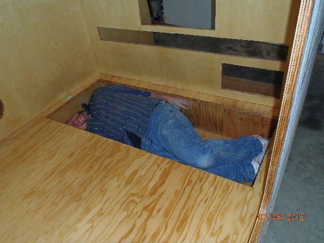

Then we temporarily assembled the beast. The basement supports/ storage area walls were joined with kreg pocket holes and screws. Then this assembly was attached to the floor (trailer not garage floor).
One wall went up next ( aided by the kids). This was attached to the floor with pocket screws. Then the bulkhead went into its dado. Then the bedroom floor was slid into the dados on the wall and bulkhead. Then the second wall went up. The whole thing was squared up and tacked into place with screws. That was enough work for one day.
Tah-Dah!!
Hubby laying down on the job.
This is where we can hide the body or water tank.

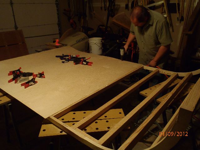

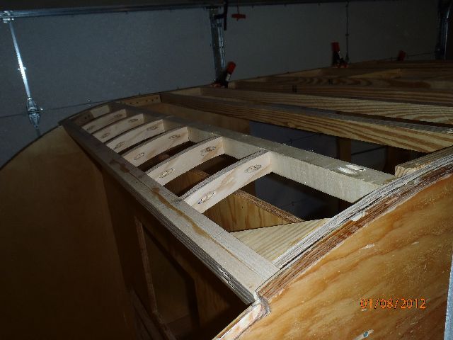

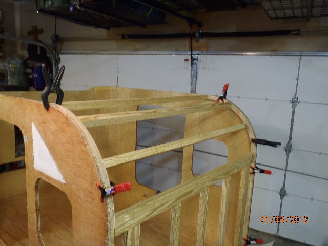

The next day we started on the roof. We decided to build it like Aggie79 did the Silver Beetle, with the frame being removable at this stage so the ceiling could be easier skinned and finished. I had planned out the spar placement on the computer.

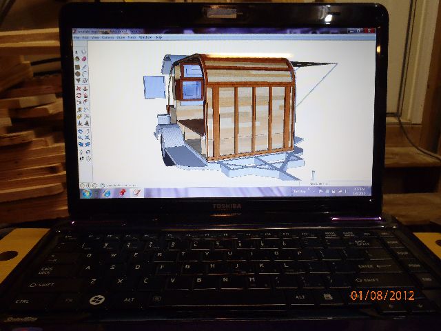

Front wall in virtual reality.
The front section was done first. The thicker studs are where the tongue box will be attached.
Front wall in real reality .
Then the curved front and top were completed.
A rough opening of 14 ¼ x14¼ was made for the fan to mount ( we will be using a maxxair fan). The final spar is a doubled up piece of oak to provide a solid area for the hinge screws to bite. It was obvious that while, strong there was too much flex for our liking so we decided to put in more bracing. That had to be left until the next day.
On Monday we tackled the last section. We installed corner bracing then curved braces to stiffen the spar.
It should be able to handle a lot of strain now.
ImageThis spar is super strong!

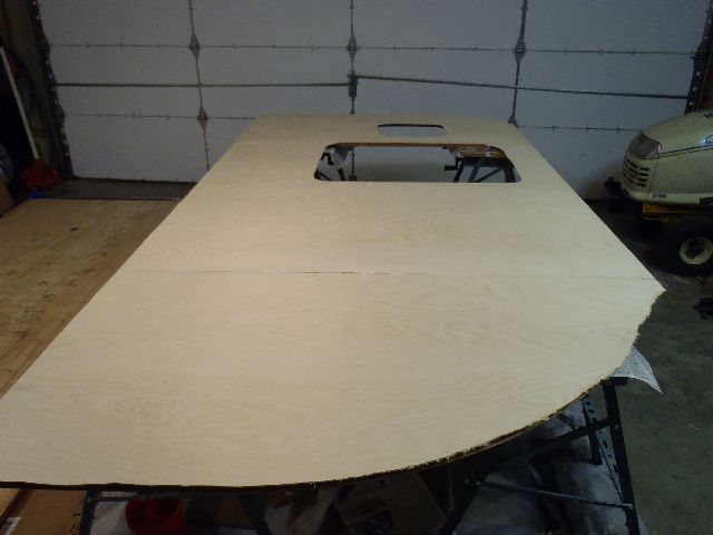

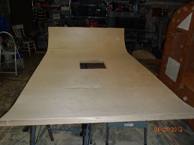

Then we faced the main part of the roof.

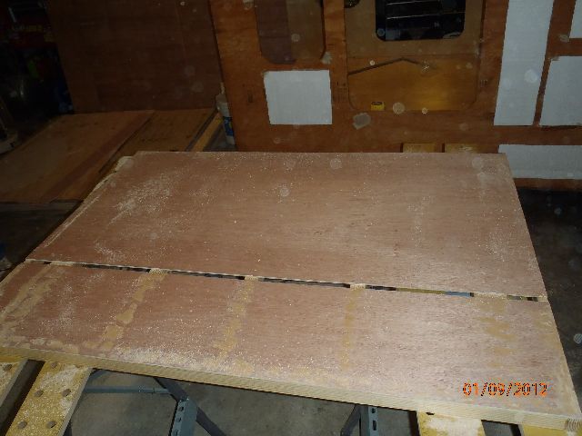

We used liquid nails ( should be called pasty nails) , and crown staples to attach the first skin (1/8 inch Baltic birch) and then trimmed the edges with the flush router. My hubby James was feeling where the edge of the panel was, and managed to staple through his thumb. Ouch!! Better the stapler then the router.
ImageSticks out lick a sore…
We applied a second layer of the same plywood this time spreading Titebond III to adhere them and staples to secure them.
ImageDone.

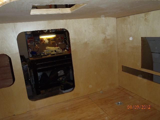

Then we put the roof back on. The kids helped with this also. Two extra set of hands can make a big difference. We attached it with screws through the outside. We wanted to let the glue dry with the roof in place so the curves would be right.
ImageInterior view
