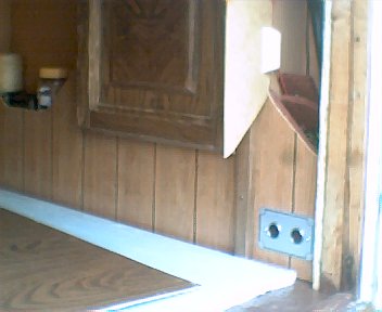

YAY, right side cabinets 4, 5, & 6 have paneling outer coatings and doors attached!
(looking forward from the rear, start counting at the front, to back.)
Left side only needs #3 door'd yet. As soon as I figure out the fold-up sink and get all the hardware I'll be able to finish the door.
left 1 = 12v control cabinet, #2 is window, #4 & 5 are the "Den" fold down desk with storage underneath, #6 is the 120 volt primary distribution closet.
Right side still needs 1, 2, & 3 done. 4 is to be tools, 5 -first aid, 6 - poles, tarps, stakes, ropes for fly.
The left and right #1's are about 3/4 width, the #6's are less than half width.
Ceiling and entrance ways to go.

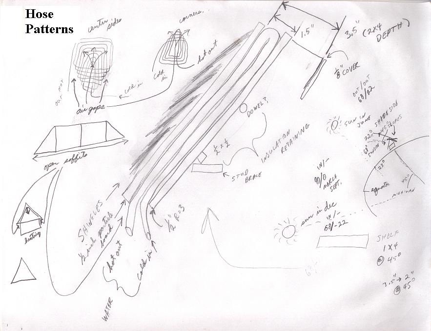

Postby PcHistorian » Mon Mar 19, 2012 10:22 am
latest hose design information for the solar ceiling water heater. (beware the shingle nails!!! ) It will all have to be removed to reshingle. cut off nails inside before mounting hoses.

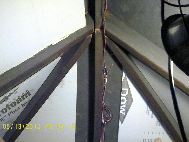

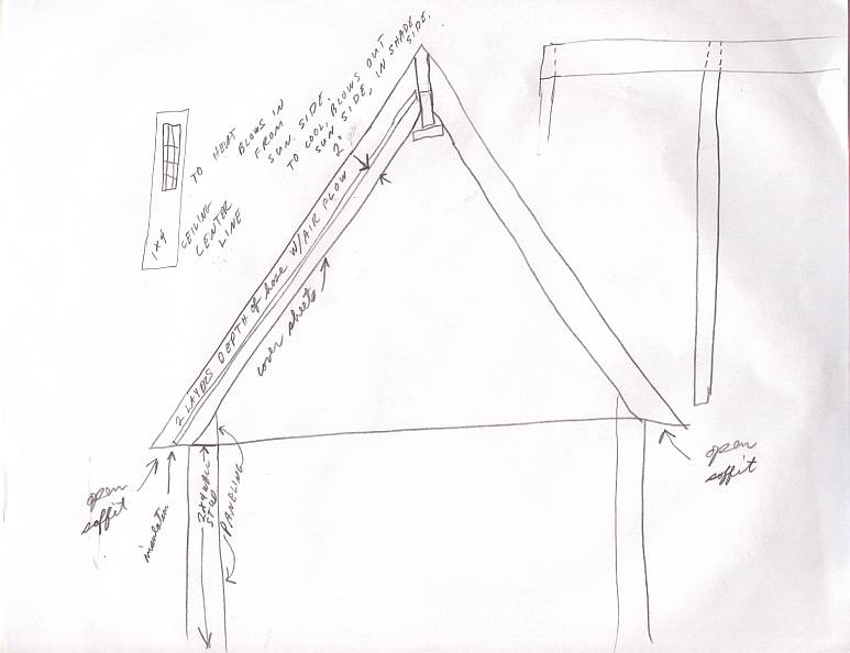

Postby PcHistorian » Mon Mar 19, 2012 11:34 am

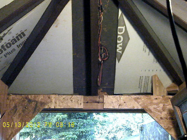

current plan for the fore and aft ceiling triangle contents. I may respace the depths here to allow for the hoses for the solar water heater. Granted more heating is going to occur on the sides, but there is morning and night if I angle differently. I'd like the whole thing to be automatic (for the misses... or is that mrs... ;-)

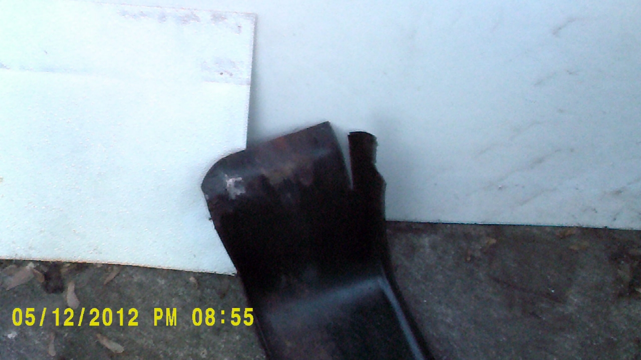

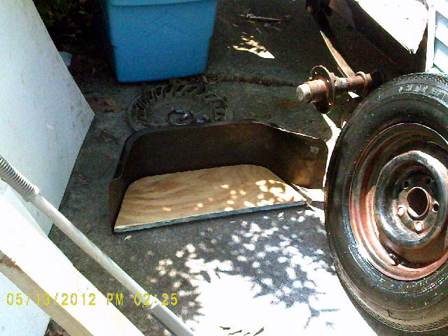

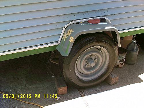

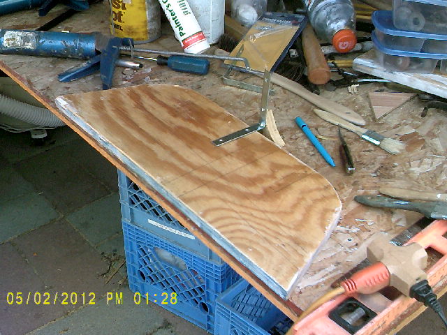

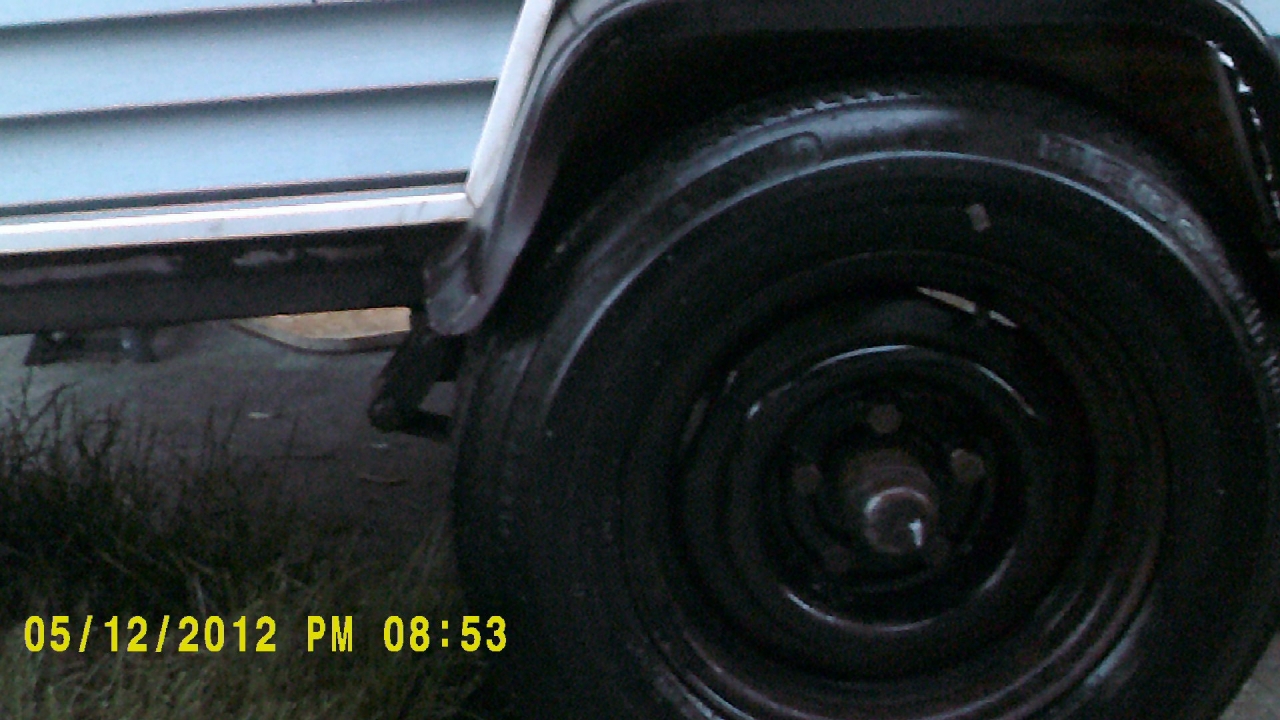

Postby PcHistorian » Sun May 27, 2012 2:06 pm
back on the web for a bit, getting ready to upload pics and progress.

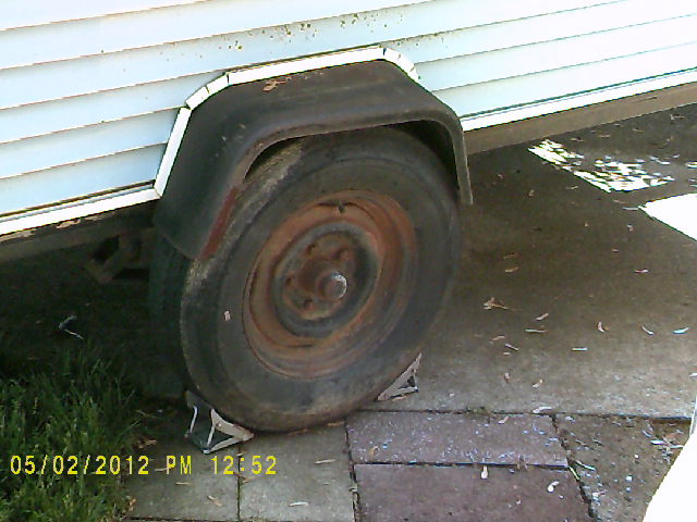

I think I got the wheel well woes figured out. I put a cut in the wheel well at the back and against the trailer, then pulled up and flaired the wheel well where it was rubbing. (I had done a "Max load test" on my first time out... rubbed a bit, and actually broke two welds and sprung one of the wheel wells off. Which I didn't mind as a solution was majorly required. There was no protection of the foam walls inside the wheel wells. The walls actually opened to the road when the foam flapped in the wind. couldn't put anything in the bottom of those wall compartments, cuz water would splash up from the road or the things would fall out.
Little flare on the wheel well hides a world of problems. I get to keep my "stardard size, heavier load" tires and the original wheel well system, AND got the under foam sealed to the weather and outside (no vinyl under there, was just foam insulation). I also did the bearing while I had the tires off. (best excuse to get gooey in the world, wheel bearing repacking. :-D)
Also got sealer for under the floor, glue for the foam insulation attachment. Fender washers to go on top of that.

Postby PcHistorian » Wed Jun 13, 2012 12:13 pm
Ok, sequence of quick posts here.
I just posted a bunch of pictures to the may 27th, 3pm-ish post on the wheel well.

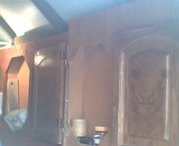

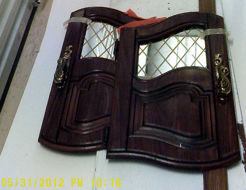

Here is the new, last "set" of cabinet doors for the Elf Cottage. (I still have a "single" to figure out for the sink/"kitchen" cabinet. Any Ideas?) That area at the top isn't window, it's mirror.
I have to figure out if I want to mount them normal or back to back (saloon style, but cabinet doors). One is for the "dining room" (plates, silverware, pots, pans) third "door" on the right. The other is for the "guest room," (any one staying with me) 4th "door" on the right. ( Possibly the Linen closet but I don't think so.)
The brass handles will be coming off, too. Into the barter bucket. :-) (too uncomfortable to lean against.)
I think I have a can of stain pretty close to that door color too. It's a quart with little used. I may use some for the shelves inside... but that's it. The rest of that stain will be up for "barter" at a tear in.

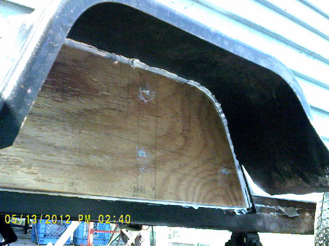

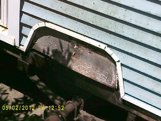

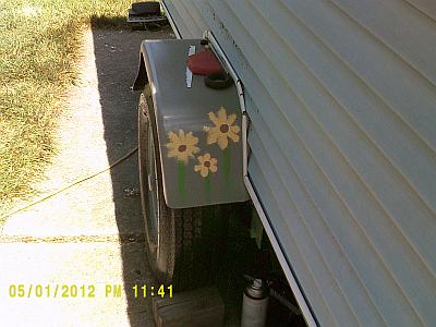

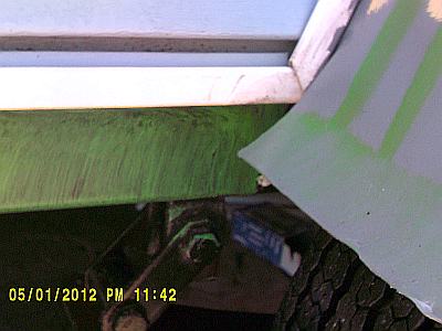

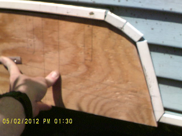

Postby PcHistorian » Thu Jun 14, 2012 11:07 pm
Ok, next sequence is the resolution of the wheel well woes...
start
fix
finish
and a new paint scheme (garden and lawn (never needs mowing))

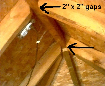

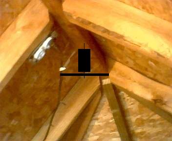

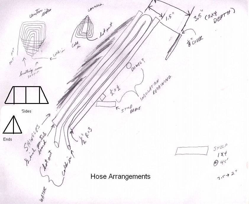

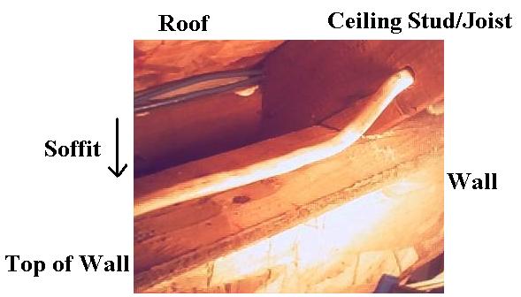

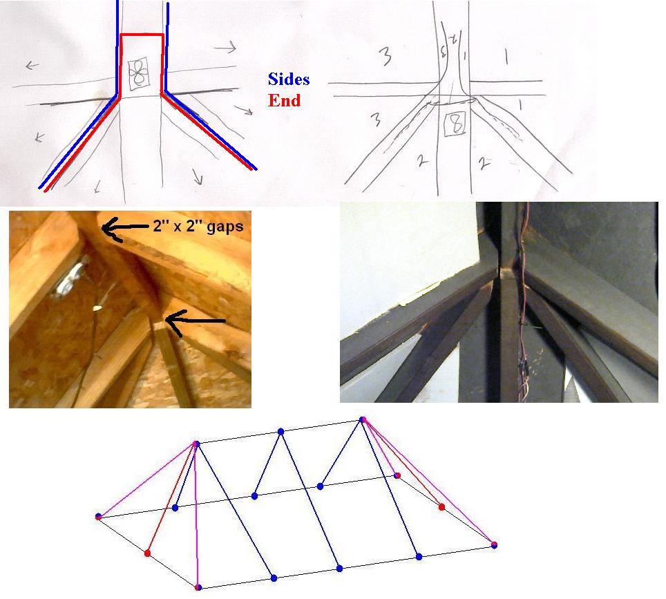

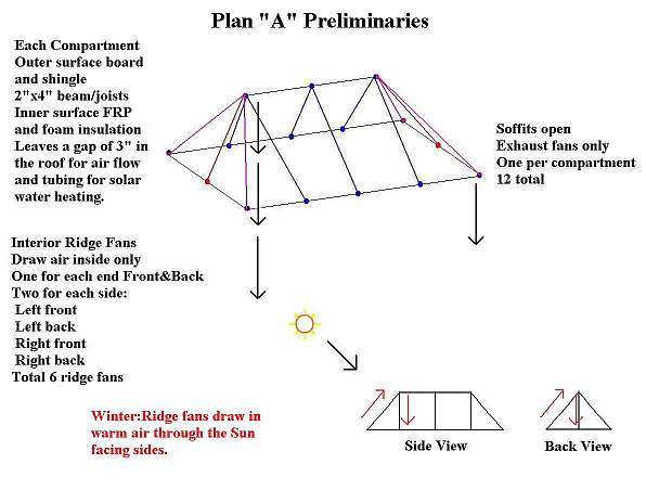

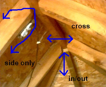

Postby PcHistorian » Sun Jul 08, 2012 9:29 pm

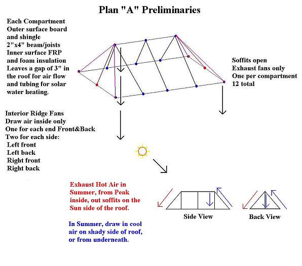

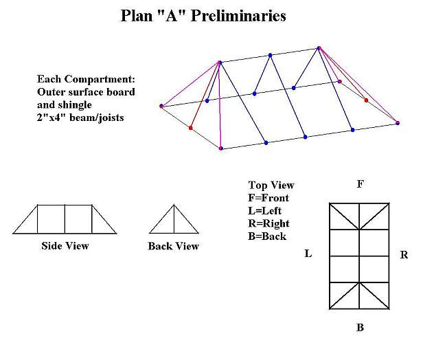

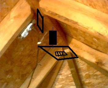

two pages opened to do this next section. this is just the analysis and design prep for this part. this is for the solar hot water heating design and the heat / cool air ventilation system. This falls into the area of the spaces of the roof, between the inside of the roof board, to the inside surface of the roof beams/joists. Roughly "what can you do with a 3.5 inch deep space of the roof area of an Elf Cottage (TD/TTT), to heat water, and heat or cool the interior air." (adapt to your own design.)
the tanks for the hot water are actually to be under the trailer. I'm just planning some hoses under the roof-surface to heat the water for hot water tanks.
sequence one is to define this in pictures, figures and diagrams.

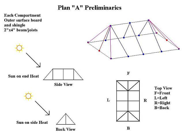

This roof in the sun will get plenty hot, un-insulated inside the board under the shingles.
Here's the beam arrangements and the general ideas.
resolution

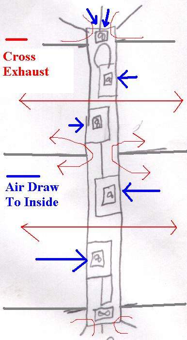

These first two are diagrammed as looking straight up. the figure 8's are to show a computer muffin cooling fan (12vdc @1/4A) and are shown surrounded by an area to restrict where the air comes from, side, or end.
I also wanted to try at least one "alternative" diagram to see if it improved the design in any way. So I came up with the staggered fan design.

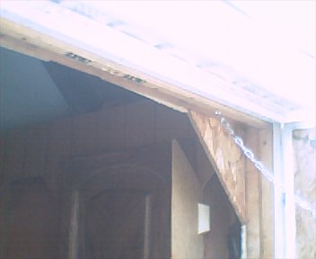

then there is the ends. the joists from the corners are about 30 degree angles from horizontal, where as the beams from the middle areas are about 45 degree angles. the ends posed a bigger problem of the ventilation because the point was so closely interwoven with the diagonal parts of the side-ends.
Then lastly a cutaway of the full system: shingle, roof-board, water hoses & air gap, 1/2 inch insulation,(so of 3.5 inches, that accounts for about 1.2 inches), gap of about 2", inner surface of fiberglass reinforced panels.

These three boards (seen from the back) make up the trim and tracks for the two pieces of FRP for one side. There is channels cut into the edges of each board, two for the center piece, one for each outer piece.
when mounted the bottom edge matches the paneling of the walls in angle.
and the tops are tapered to prevent severe harm when bumping my head on these.
you can also see the 1/2 inch insulation already measured and trial put in place.
here are the 4 cut panels for the center of the sides-roof inner surfaces. (prebowed for ease of installation by tilting against a wall in the 104F sun.)
