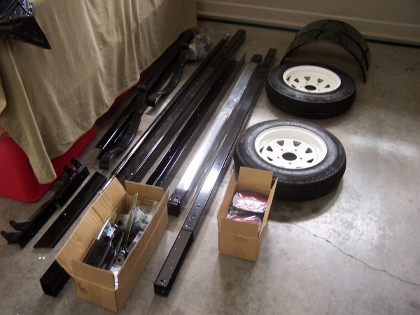

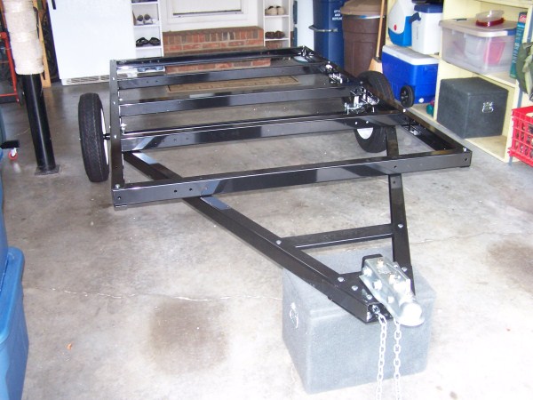

After some distractions, I finally started construction of my weekender this week. After hearing horror stories about delivery damage and missing parts, I was relieved to see everything in good shape and nothing missing. I guess it helped that the NT distribution center was only about 100 miles away in Ft. Mill, SC. The assembly was pretty much straightforward until I got to the part where you flip the frame to install the axle and springs. I didn't have a helper that day so I kept the frame upright and did it upside down from the directions with the help of a trolley jack. Actually I think that might have been easier than flipping it even if I had a helper. I did not install the lighting or fenders at this time. I plan to run the trailer wiring in conduit through the cabin and all my lights will be mounted on the shell. Also I plan to replace the round fenders with angular fenders to match the lines of the weekender. I replaced the grease in the hubs with something called "Red and Tacky". It is a high temp grease favored by a lot of boaters. Also replaced the painted coupler with a zinc plated Reese coupler. Just a cosmetic issue there as I think the light coupler looks better with the black frame. One minor problem with the coupler that I'll explain in the pics below:
Boxes received in good shape:
All the parts:
Squaring the frame:

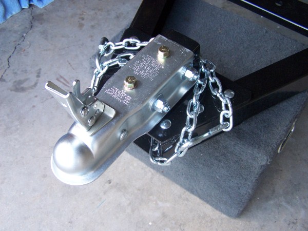

Different coupler (while the main horizontal bolt holes lined up OK, the vertical or top bolt holes were off just enough
that the one 1/2" bolt that was to be installed there would not go; instead, I installed two 7/16" bolts)
This is as far as I go with the frame for now. Sawdust starts flying next with the installation of the floor.

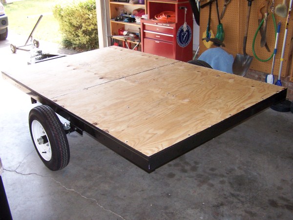

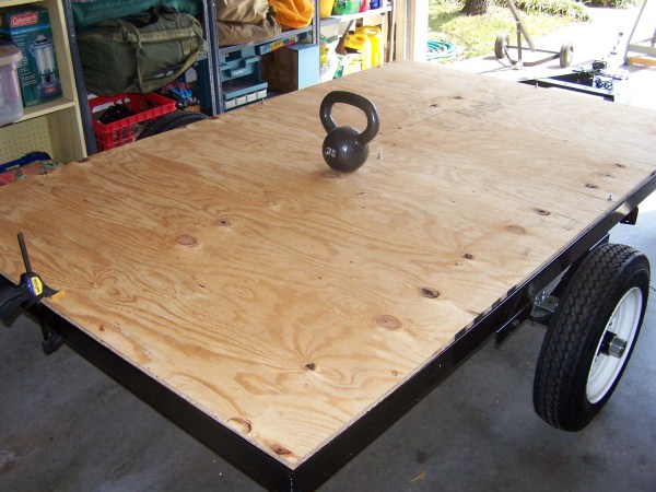

Whoever said that a weekender could be built in a weekend must have had a habitat crew helping out. It took me more than a weekend just to do the floor. I will point out here though that I am a retired engineer with a touch of OCD so I tend to take longer to do everything. I'm just too picky. The floor of my 5X8 was two sheets of 5/8 plywood sheathing. Pretty much a standard cut and bolt operation. I will point out that these DIY trailers require a few extra touches when bolting the plywood. I had to drill holes in the plywood for the bolt heads in the frame and I glued wood shim strips over each crossbar to keep from getting that sag in the center due to the overlap where the metal cross bars fit into the perimeter channel. I ended up using carriage bolts and nylon lock nuts and found that the carriage bolts tend to turn in plywood. I ended up using my Dremel tool to cut screwdriver slots in about 3/4 of the bolt heads (this is also a good way to remove one that is turning on you). This was also a problem when trying to tighten the bolts that are near the center where you can't reach with both hands. I rigged up a third hand to deal with this as you can see in the pics. For an undercoat, I used Henry's #107 asphalt emulsion since it was the only thing available in my area in one gallon containers. Didn't notice until I got it home that it is not made for use on plywood. I was concerned that the liquid in the emulsion would delaminate the plywood so I applied a two coats of Zinsser primer before applying two top coats of the Henry's. I think that should be enough. I'll paint the top side later with some type of exterior latex enamel to make it smoother and watertight.
Here are the two panels cut and dry fitted (finally found some use for the wife's 35 lb kettle bell)
Gluing wood shims over crossbars
Hole drilled for frame bolt head and end of crossbar shim strip being glued
Two coats of Zinsser primer (forgot to get a pic of the final Henry's topcoats)

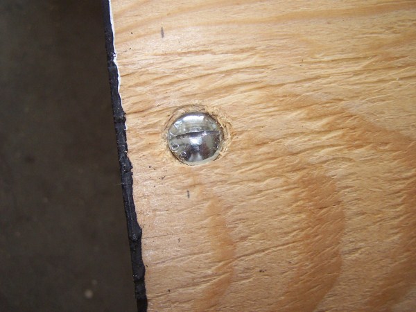

Screwdriver slot cut in carriage bolt head
Third hand used to keep internal carriage bolts from turning
Closeup of third hand
Floor installed
les45

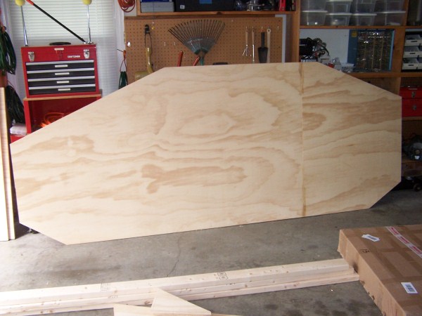

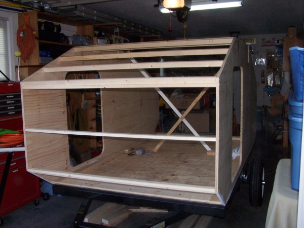

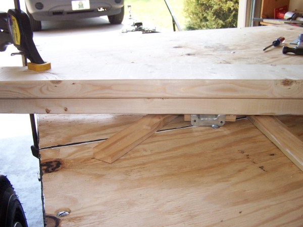

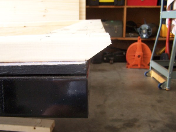

As I stated previously, trailer weight is not an issue with me so I'm probably offending some of you by overbuilding nearly everything. Since the floor and cleats are critical to securing the entire superstructure, I used 2X4's on the sides and 2X6's on the ends. I beveled the edges of the end cleats about 33 degrees to match the bottom bevel on the weekender body. Since I couldn't find 4X10 plywood anywhere in the Southeast, I bought three 4X8 sheets of 3/4" cabinet grade at HD and spliced enough to make my overall 10' length. I decided to make the splice in the center of the door opening so I have just a really short section top and bottom to sand smooth. Cutting the walls was pretty much straight forward and I used the inner ring from the Vintek manufactured doors as a template for cutting the door opening. Again, I developed several "third hands" to help set the walls in place and to install the spars. I applied two coats of Zinsser primer to the bottom edges of the walls and the ledge and cleat where the walls fasten. Also applied a bead of silicone window caulk along the bottom of both side cleats. I installed most of the spars on the front half to start firming up the walls, but left my temporary cross bracing for now.
All cleats fastened to plywood deck with 1/4" bolts.
Ends of side cleats and sides of end cleats beveled 33 degrees to match bottom bevel of weekender body.
Gluing lap splice in plywood.
The corners are cut. Starting to take shape.
Inner door ring used as template to cut door openings.
Primered and caulked ledge and cleat.
The walls are up!
Third hand used to hold walls in place.
Third hand used to hold spars.
Spars installed in front half.
Rear view of walls and spars.
Another third hand for temporary wall supports.
