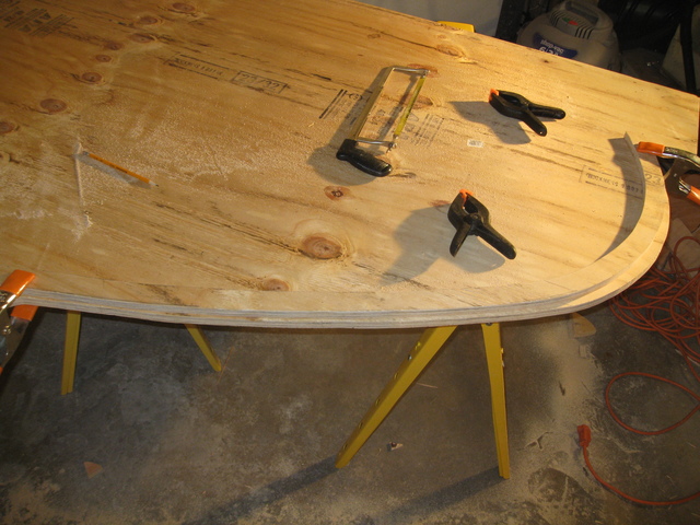

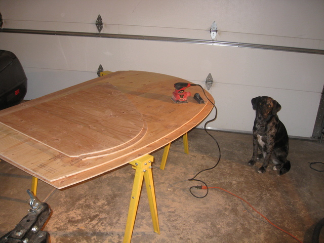

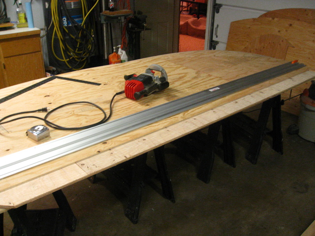

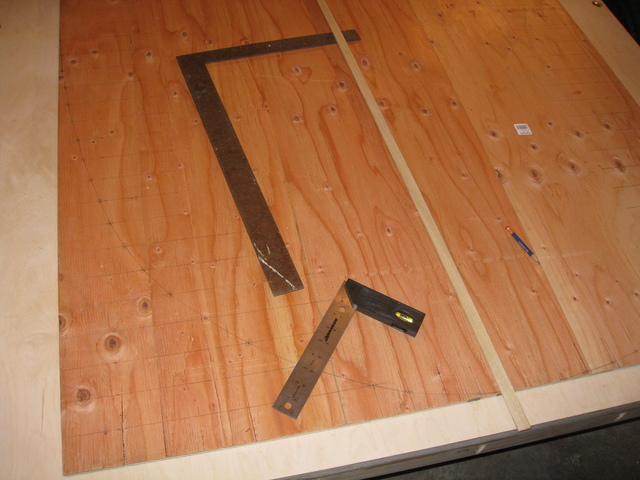

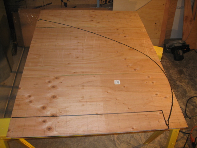

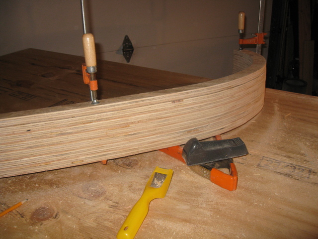

Transferring the profile to my wall templates. I made 2 section templates for both the inside and outside . I used a 2 inch grid and drew the curves connecting the marks with a thin piece of scrap.
I used a sharpie to thicken the outside of the line to run the jigsaw against. This also allowed me to easily see if I needed to take extra material off with the hand plane later.
Went back with a small hand plane and a sander to finish the curves.

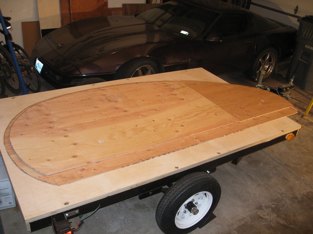

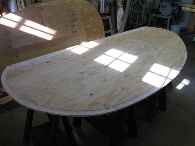

Completed templates layed out.

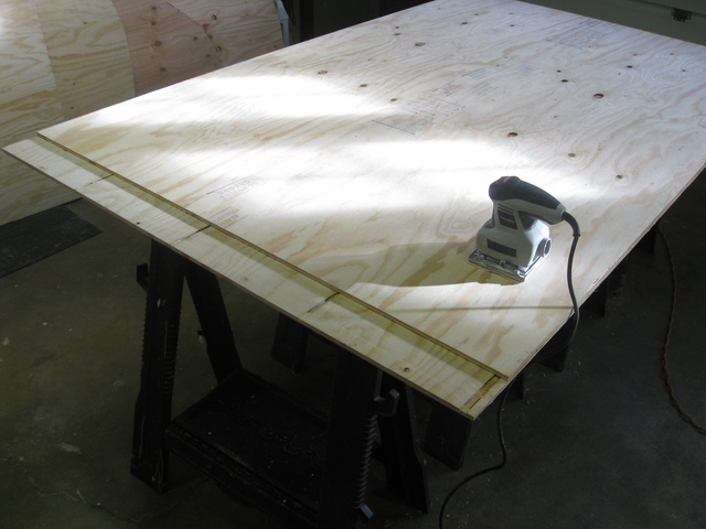

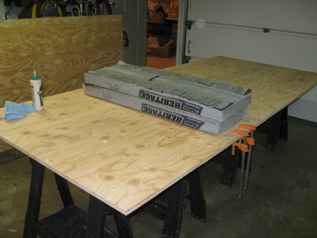

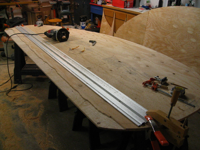

I had to splce 2 3/4" 4x8 sheets of ACX plywood to make each wall panel. I used a half-lap joint 3.5 inches across.
Gluing the wall sections togather.

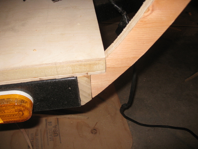

Routing out the 1/4" deep mortise on the bottom and edges of the walls. This technique worked well with a new sharp bit in the router.
Getting the curves were a bit of a problem as I used the inside of the inner template as a fence. It didn't quite match up so I had to do it in 1 foot sections.

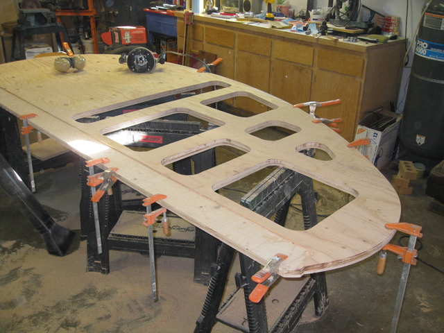

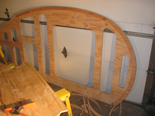

Lots of good progress was made over the weekend. I managed to completely finish the walls, and get the majority of materials I will need for the rest of the project.

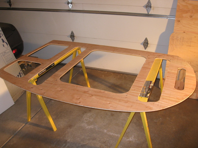

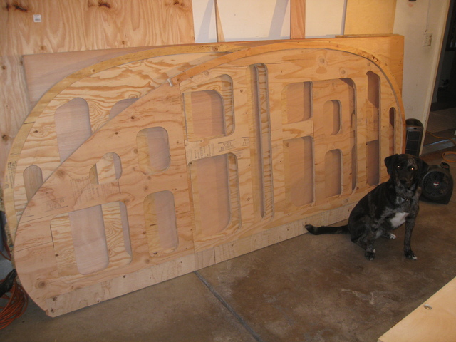

Measuring and marking the cuts for the voids in the sidewalls on my wall template. Thanks to a suggestion by Dave (DMcCam) I used a 2" radius on the corners which should help the wall retain some strength over square corners.
Cutting out the holes with a jigsaw. I have to say in all modesty these were the best cuts I have ever made, and compared to my previous cuts, they didn't require much cleanup afterward. :thumbsup:

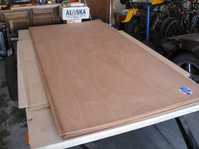

I took a quick trip down to my lumber store and picked up the wood for my cabinets as well as the skins for the interior and exterior walls. After talking with Doug Hodder (BIG thanks Doug!), and looking at his work, I decided to go the Okoume plywood route for the exterior skins. They are 4mm thick and a close relative to mahogany, it is also a marine grade plywood. I think they will look great after some finishing with aniline dye and under some varnish and epoxy! By the way Okoume is hard to find in the middle of the country.
Cutting the voids out with a router. I was worried about the rigidity of the sidewall with all those holes but it still feels quite strong and much lighter!
Finished sidewalls! If you look closely you can see the 3 1/2 inch wide half-lap slice I made to join the plywood sheets. I planned ahead so that the entire width of that splice would be lined up with a wall support.

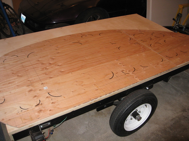

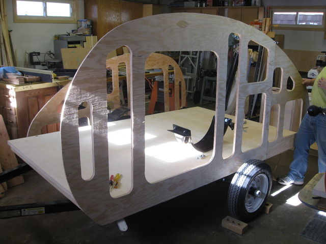

After we finished we dryfit a sidewall to the deck and to my relief it fit like a glove! It's starting to look like a teardrop trailer now! :thumbsup:

_Ryan_ wrote:I was worried about the rigidity of the sidewall with all those holes but it still feels quite strong and much lighter!
Once you bond the inner & outer skins, it'll be stronger than you'll ever need.

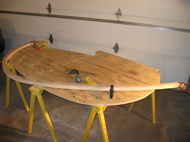

While the walls are still mobile and not skinned I decided it would be a good time to build the blocking for the roof as well as the ribs for the hatch.

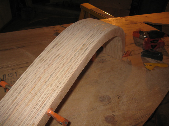

Lining up the pattern for the second hatch rib. The first was cut using the sidewall as a pattern. Originally I thought I would use a router to cut each piece but the pattern was a bit too flimsy so I traced the pattern and used a jigsaw instead.
After the ribs were cut I clamped them together and used a rasp to make them as uniform as possible and smooth out the curves. It was important to get these smooth or else my plywood skin might be lumpy or uneven. It turned out better than I expected.
