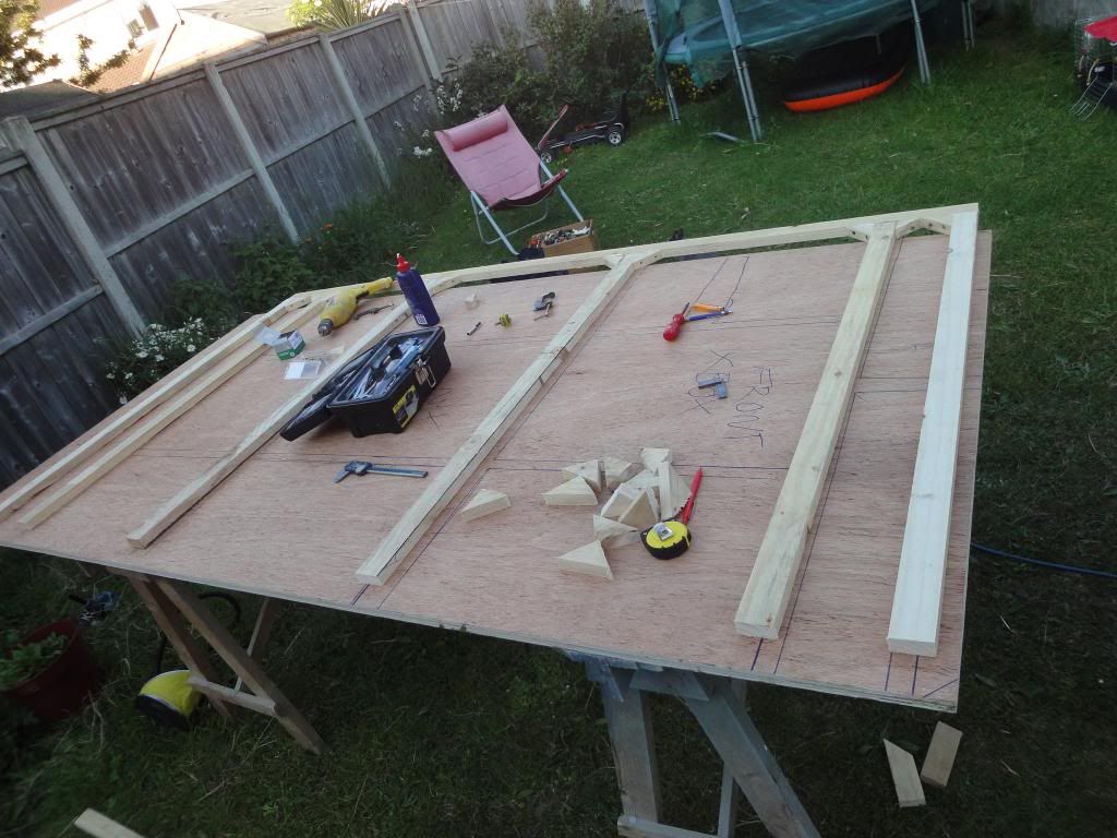

Well here's todays effort
Saw dust has been officially spilt :D
It was getting late so i had to pull the plug on the saw to keep the neighbours happy.
Measure once, cut twice....throw away and repeat.

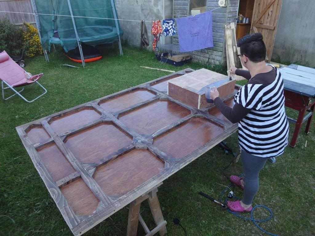

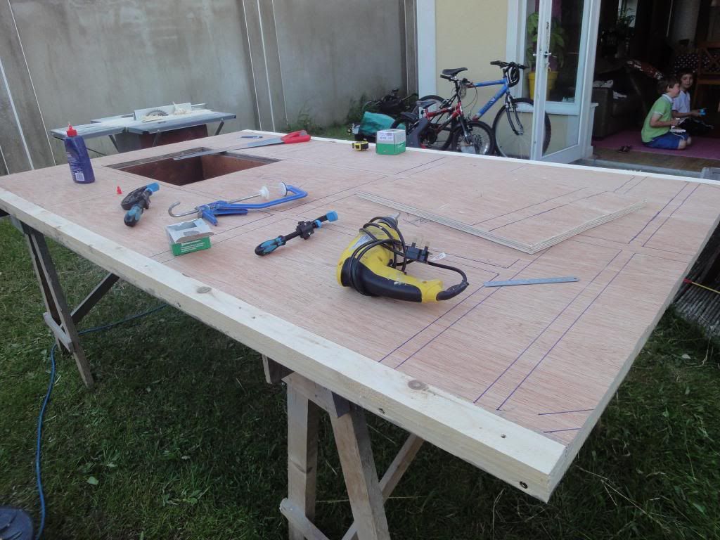

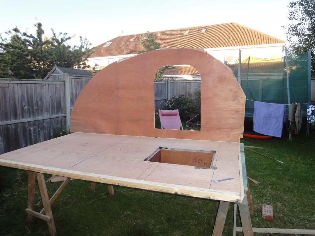

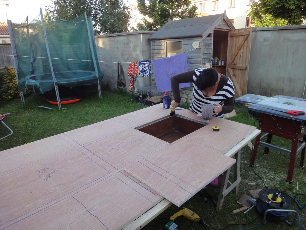

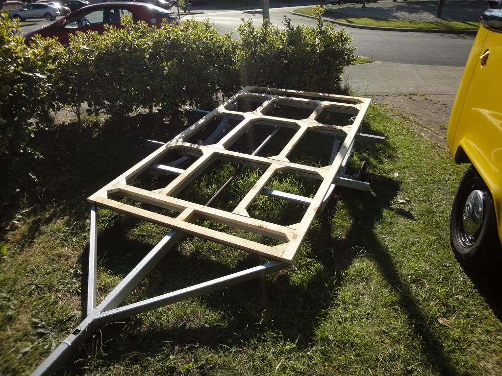

Managed to get a bit more done today.

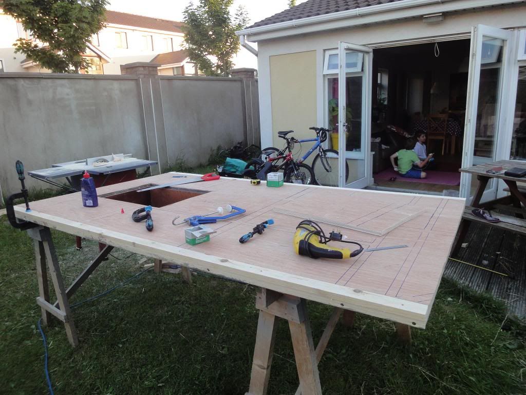

Finished of the frame and tried it on the trailer...
It seems to fit.

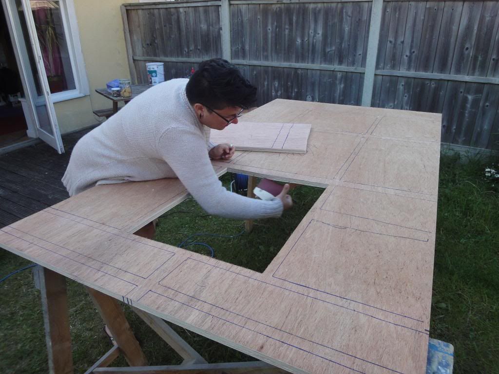

Then i cut the hole for the under bed storage box.. used one of my slaves to sand the edges :R
Then glued and screwed the frame to the floor... first coat of varnish going on while i make the storage box. We are using varnish with a stain in it because we got a free gallon of the stuff.

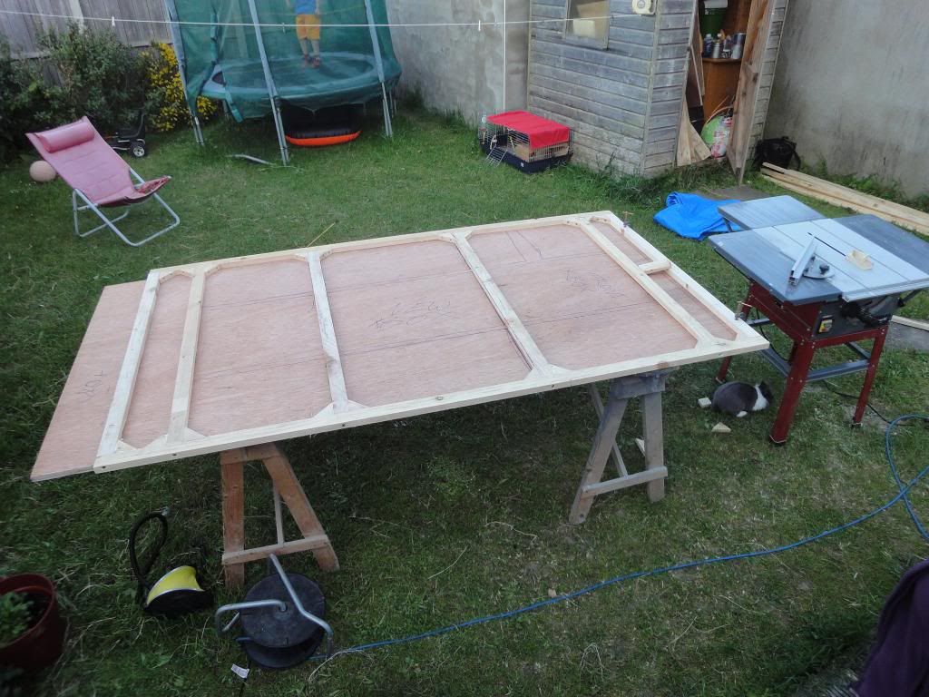

Box done and in getting varnished.
Inside and out for the box..

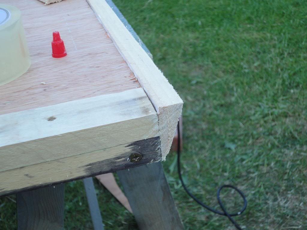

final bit for today was to rip down a 2x1 to 2 and em... less than 1 to match the floor height either side of the ply sheet.This gives me a width of 4'4" now and better wood to attach the walls to later.
So that's all for today, hoping to make a start on walls tomorrow 8)

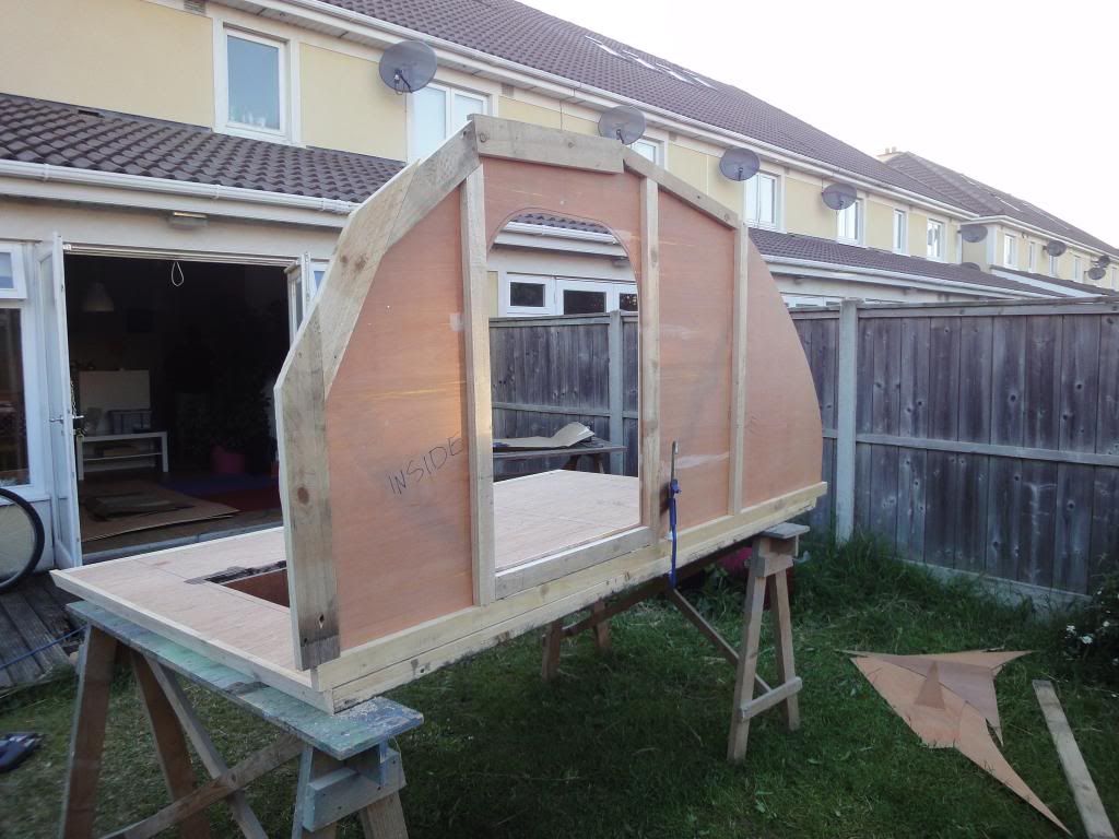

Well didn't get as much done as i wanted to day but did make some progress.

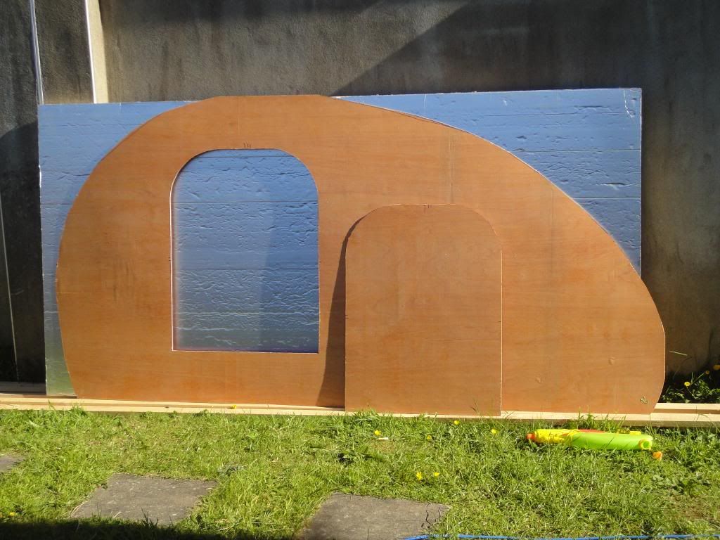

First i stuck on the angled bit on the front for the roof to meet later on.
Then i got a profile cut and cut the door out off it.. I'm using the piece i cut out to make the door later.

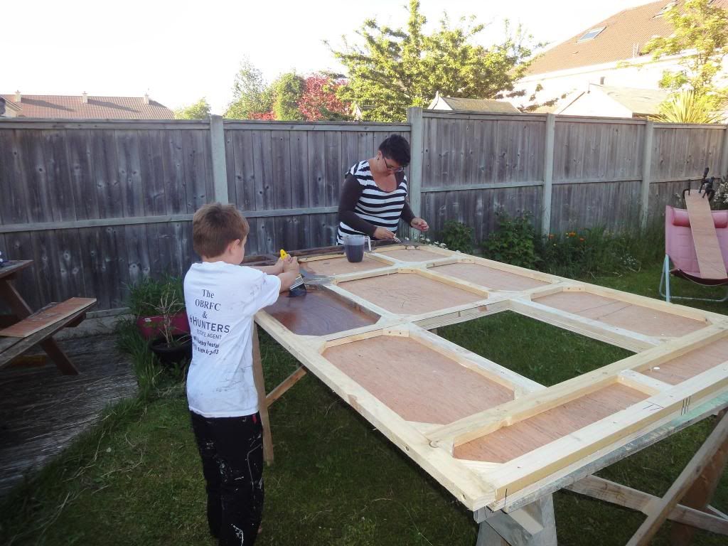

Then i cut the inside profile and started the framing. I cut the inside door opening 1cm smaller all round to act as a door stop... i hope it works.
I will trim the bits of framing that are sticking out later...
then we ran out of glue and screws. which meant an end to the days work.

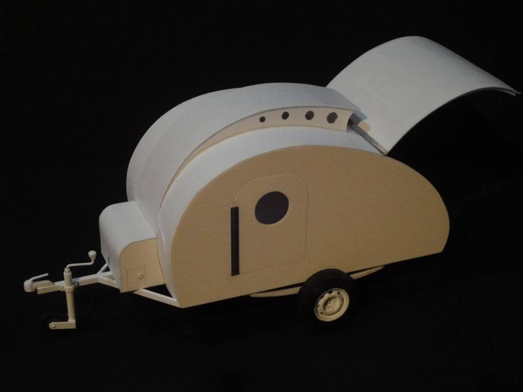

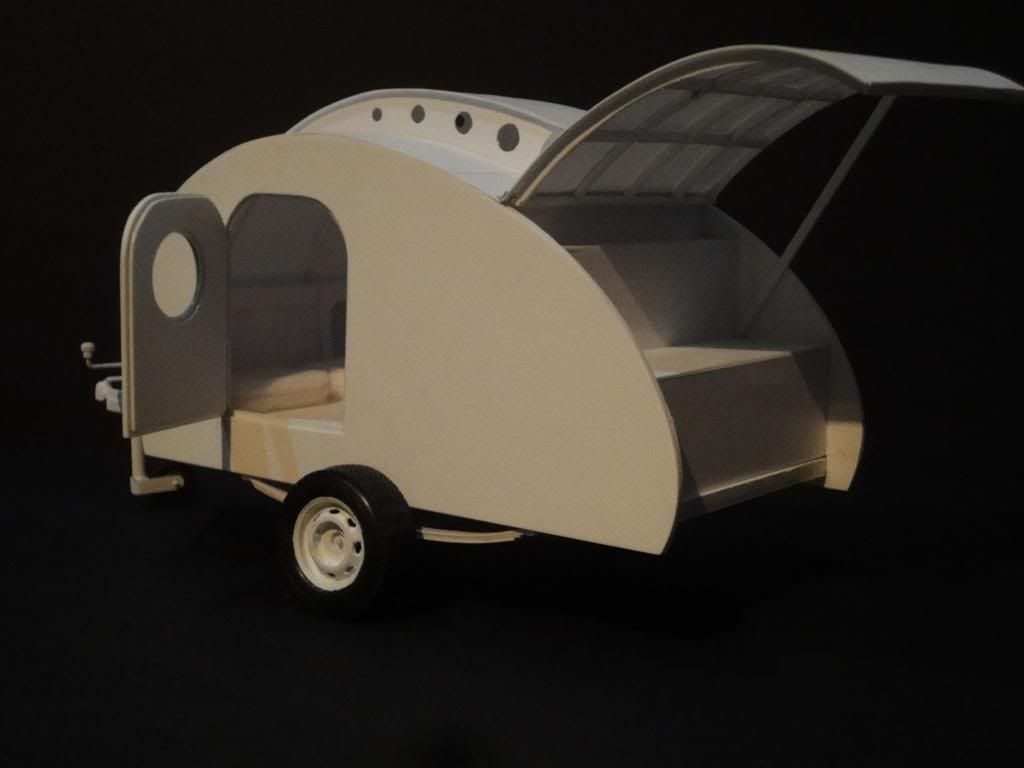

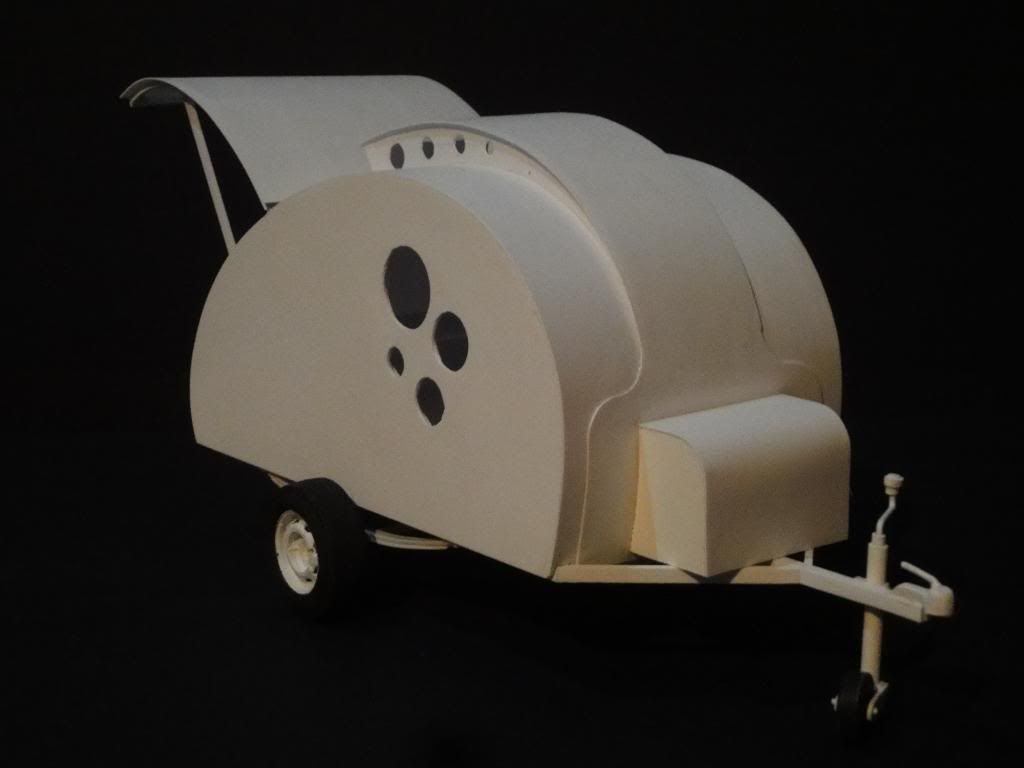

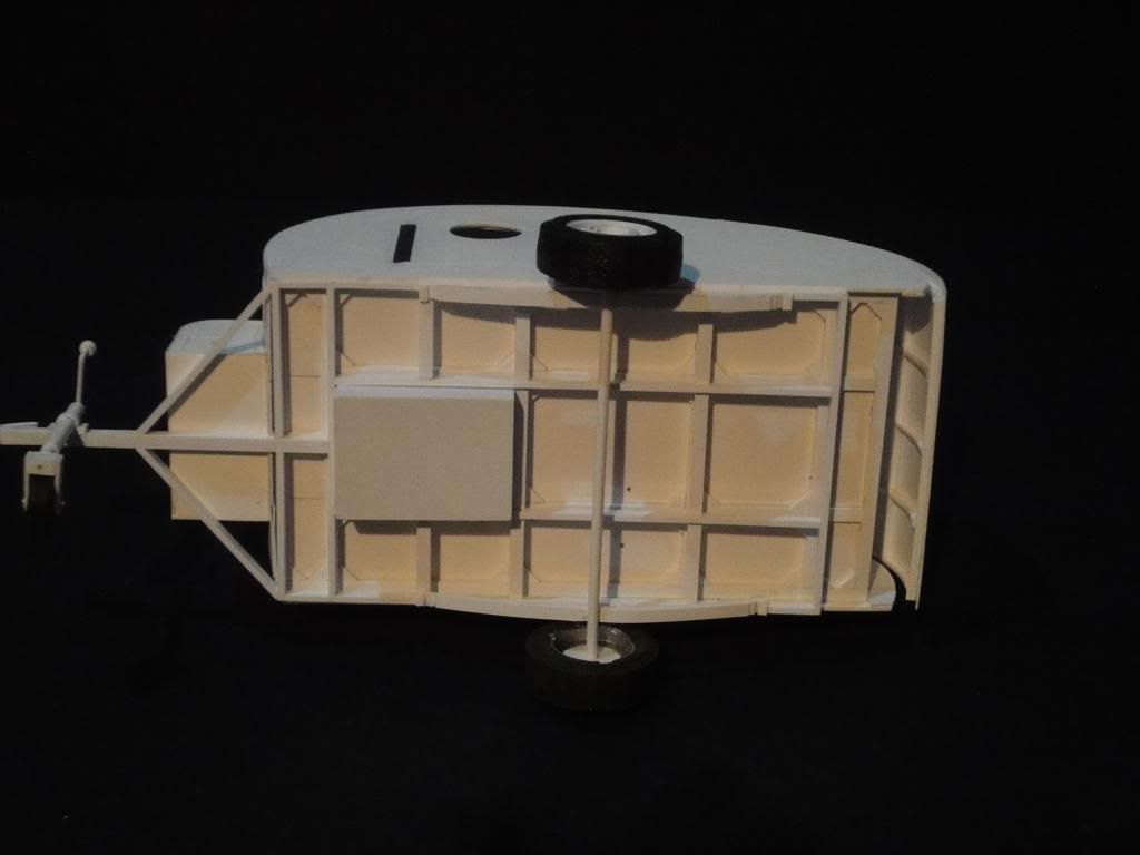

Anyway due to weather and work i did'nt get anything done on humphrey in the last week...6 straight days of rain..So instead i decided to go small scale because some parts of the build where sticking in my brain and i needed to get them out.
I started by cutting up my plastic into scale sized sheets in the amount of the real size sheets i have. I then built a model the same way i'm building the real trailer.
The model has taught me a few things....
...the first thing i learned is i don't have enough wood to skin the inside of the rear hatch and the second was i need to redesign the rear galley floor slightly because there will be a large gap between the cupboards and the hatch which could suck up a lot of road dirt when on the move. The model has been named little hump and willl be used to design the galley later when we get to that stage.

Postby KCStudly » Tue Jun 18, 2013 7:43 pm
Wow, that is a seriously detailed model!
Is it scratch built or did you start with some sort of kit for the jack wheel, hitch, etc.? Maybe a 3D printer?
If a kit, which one? If not, and hand built, WOW! Great detail.
I noticed that the leaf springs are really long (which should yield a nice soft ride). Is that to your plan, or...?
Nice model. :thumbsup: :applause: :thumbsup: :applause: :thumbsup: :applause:
Re: Here's Humphrey..Now a trolly top
Postby 3nero » Tue Jun 18, 2013 7:57 pm
KCStudly wrote:Wow, that is a seriously detailed model!
Thanks...it's 99.9% scratch built in 1:12 scale (or 1inch=1foot). the wheel for the jack was borrowed from a 1:50 scale truck model. the rest i made myself. my everyday job is as a modelmaker so this was just a quick model to see if my plans are going to work. The leaf springs are how they came on the secondhand chassis. I didn't bother with shocks and i still havn't settled on the fender design yet. Oh and by the way..we model makers hate those 3D printers..not nice being replaced by a machine :(

But today i got the rest of the one wall framed and installed the insulation and noticed that the foam is 1/8 thicker than the wood i'm using to frame with. I'm hoping it will squash down when i screw on the outer skin, if it doesn't i'm going to have to try something to make it fit.

Postby pchast » Wed Jun 19, 2013 8:34 pm
:thinking: I'd be reluctant to try to squash the insulation. The pressure inside your structure may loosen the wall up.
Pop glue joints? Unless its something porous like a fiberglass bat. I've read on here of people sanding or
even planing insulation to thickness.
I have no personal experience about this...

Postby doug hodder » Wed Jun 19, 2013 9:59 pm
It's been my experience that if you want it to "squash" down, it won't do it when you put on the skin. I'd think you would be better off to "pre-squash" it prior to installing it. I do it by setting the material on the floor and walking on it to compress the material. You won't get enough pressure/ sq. in. to get it to compress and hold it with just the skin. Just what I've experienced. It does depend on the type of styro. that you are using for insulation though. There are lots of more involved methods, but this is a cheap quick one for something that will never be seen. Doug
