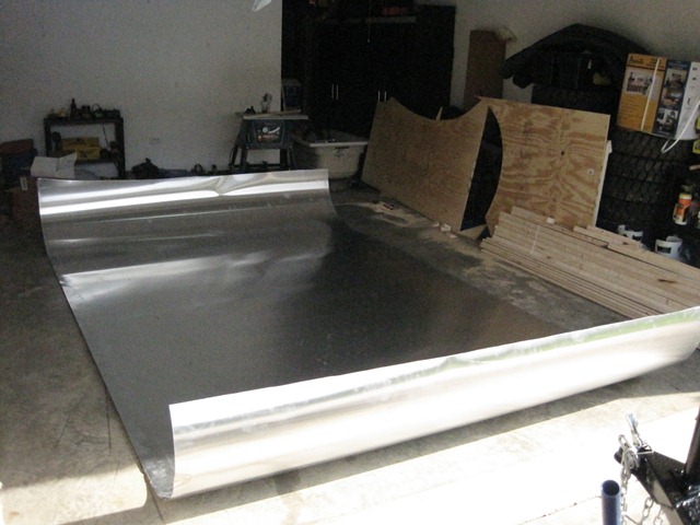

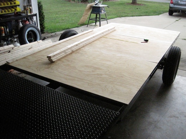

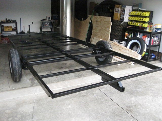

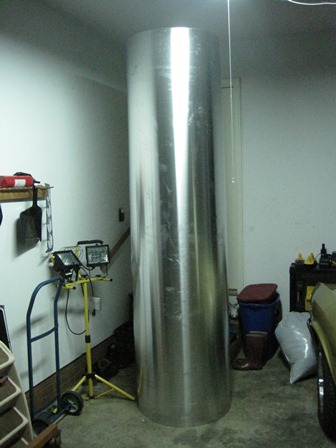

Some photos of last nites work.

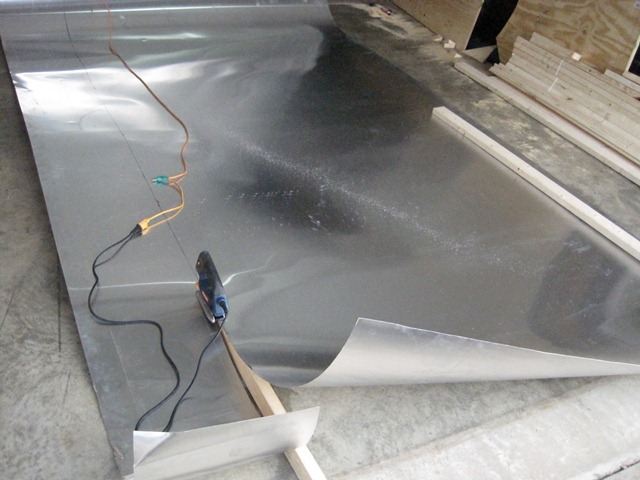

Aluminum floor layer rolled up.
Rolled out.
Cutting to fit the floor.

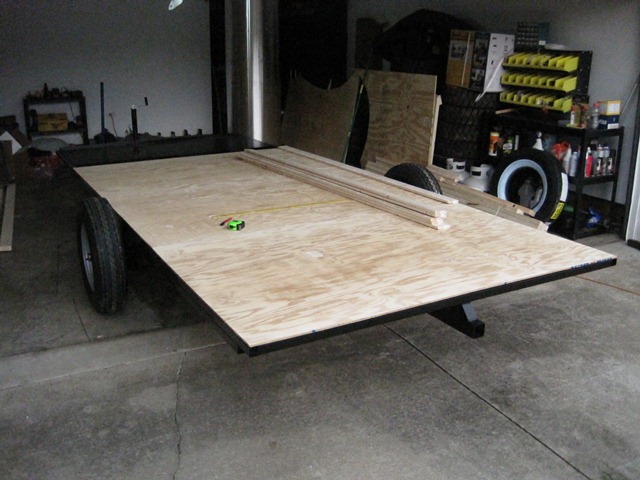

More.

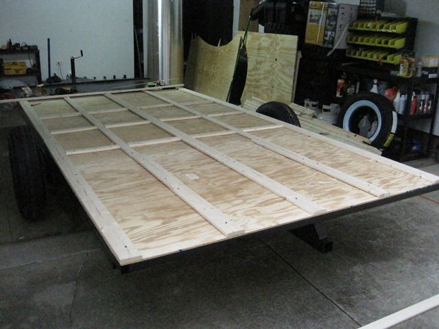

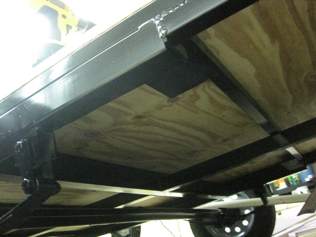

First layer of 1/4 inch ply wood.
Bare Frame

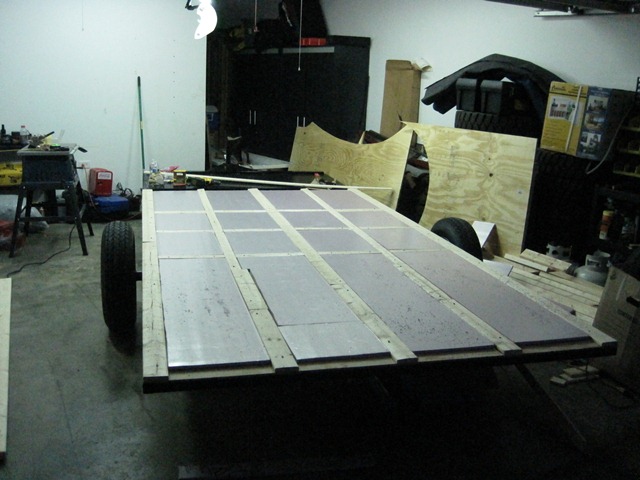

Postby BuildingForFun » Fri Jul 25, 2014 1:02 pm

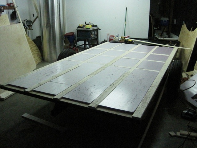

Trailer is moved all the way inside so garage door can be shut. Good thing I did, few min later the rain came.
Floor Joist on.....and then the foam insulation.
Tonite will try to get top layer of 1/2 inch birch cut and fit.
Joist cut and fit.
Foam cut and fit.

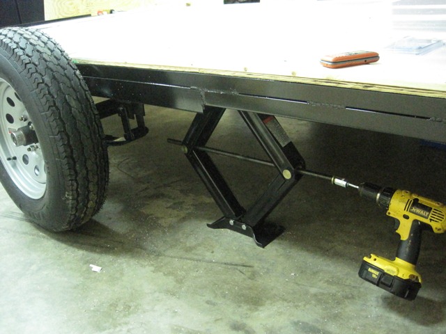

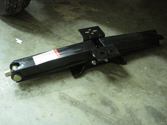

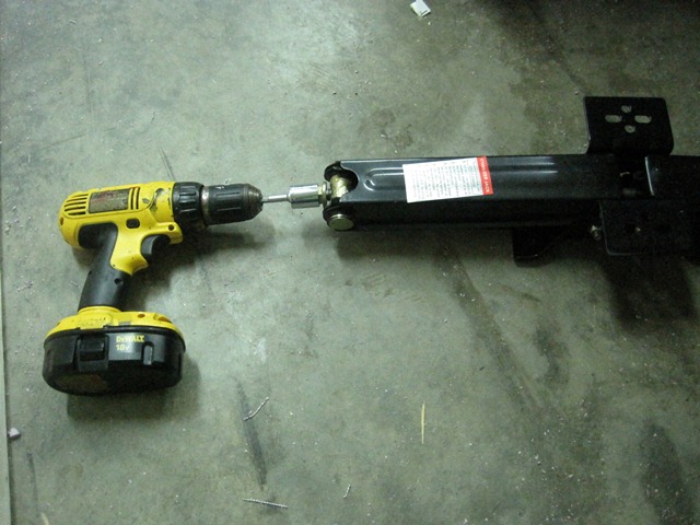

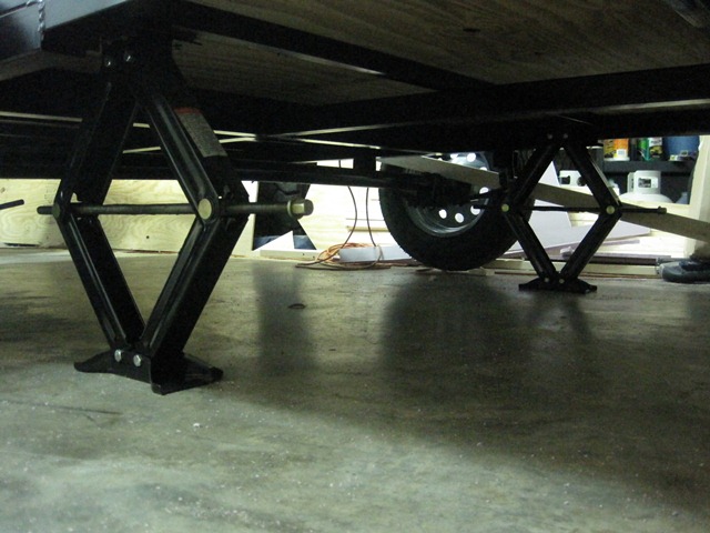

I also wanted to show the RV Camper scissor jack stabilizers. They are not mounted yet, but I put them into position and ran them up and took the weight of the tires....made trailer nice and steady.... also I saw the cool little socket adapter to use with a drill. Man! works sweet and fast!!!
Scissor Jack.
Mounting plate for scissor jack.
In Place.

Jacks and speed socket
Both Jacks in place.
Speed socket
Speed socket and jack.

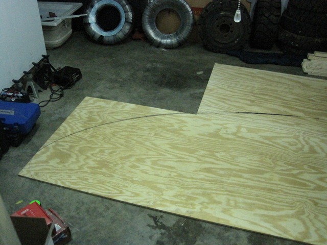

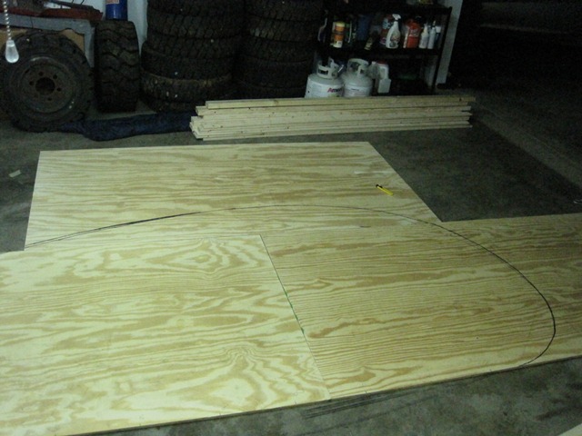

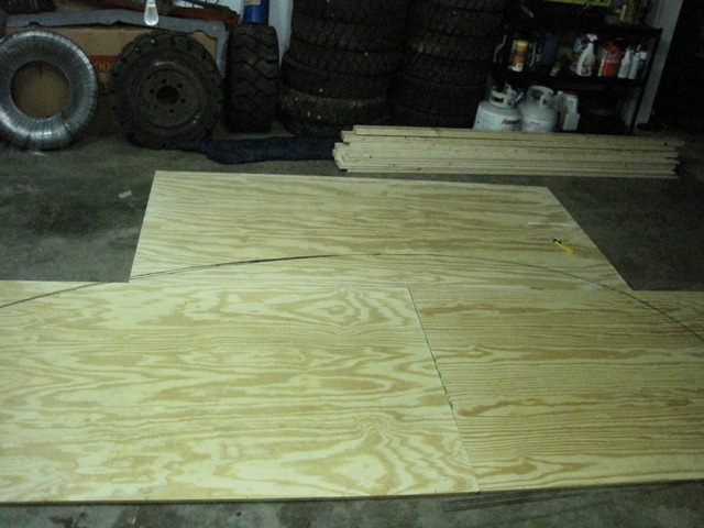

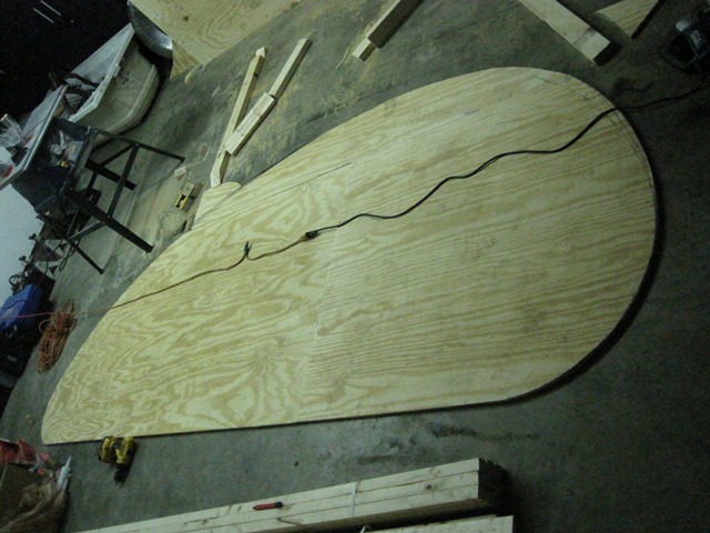

This is the profile of the wall....and then one of it cut out....instead of going with birch plywood for the outer wall, I got the cheaper 1/2 inch plywood, then I was going to do a 1/2inch foam insulation and wall stud, and then a 1/4 inch birch plywood for the interior wall. unfortunately :( I didnt check the plywood for straightness and one of the pieces has a bad bow in it......so after drawing the profile out, cutting, and glueing together....I can use it :cry: :cry: ....Now I am going to go with the more expensive birch now, and at least I can use the first wall as a template. Oh well. You Live and Learn.....bet ill be checking my wood for bows in them....Lol

Postby BuildingForFun » Fri Jul 25, 2014 2:45 pm
Cut Out.

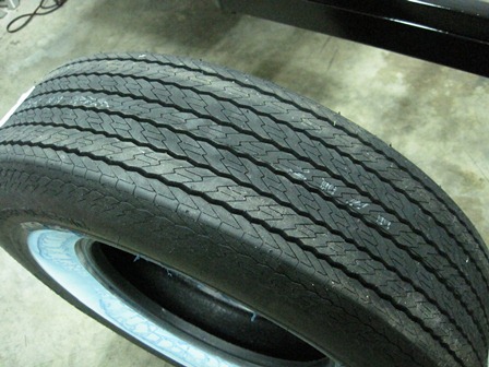

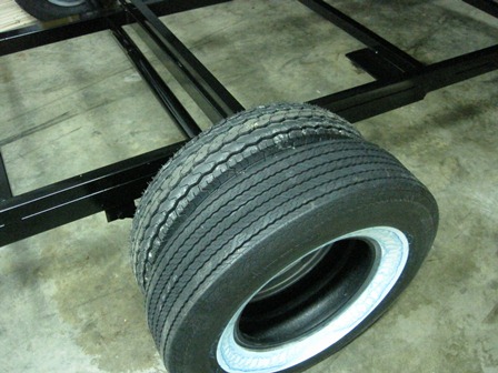

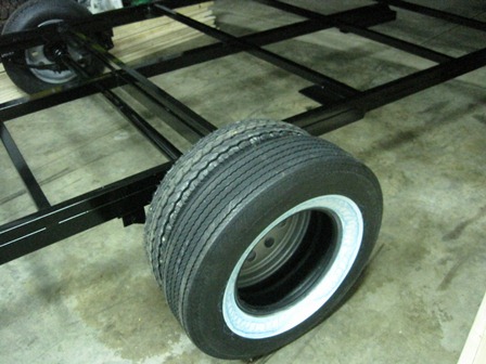

These are the Bias Ply tire and wheel combo with baby moon caps I will be using.... am still waiting for the wheels to ship....
Coker Tire 1.jpg (59.8 KiB) Viewed 1614 times
Coker tire 2.jpg (63.98 KiB) Viewed 1614 times
Coker tire 3.jpg (65.83 KiB) Viewed 1614 times

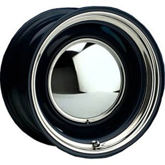

Postby BuildingForFun » Fri Jul 25, 2014 3:50 pm
Jegs Wheel.
Jegs wheel and moon cap
