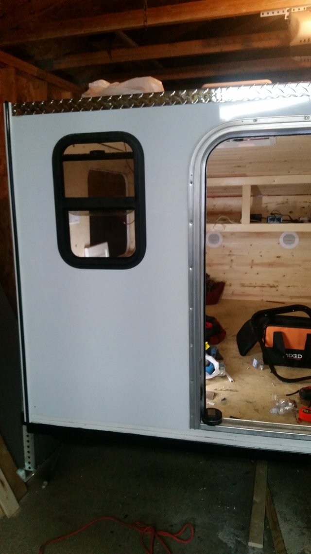

Last window installed and partially built cabinet

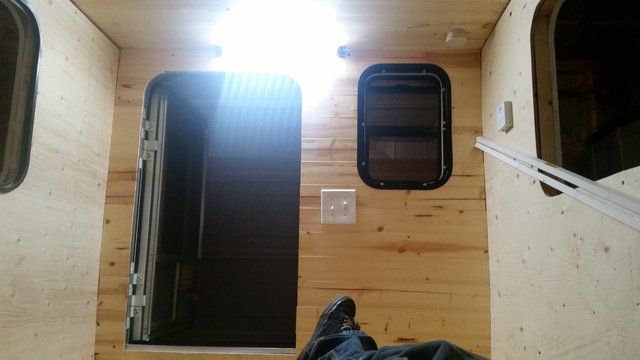

thermostat and fire alarm installed
led light and switches finished up, one switch is for the outside light. The light is kinda bright, might end up changing it .

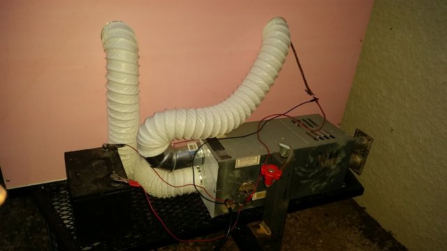

so back to the furnace, i didn't want to mount it inside the camper as it would take up too much space and the fan noise would be annoying in such a small space. Here is a picture of the initial test, it was around -5°c and it kept it nice and toasty. I attempted to sleep in it that night but i ran out of propane around 3 am.

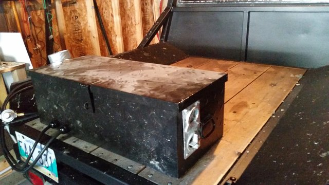

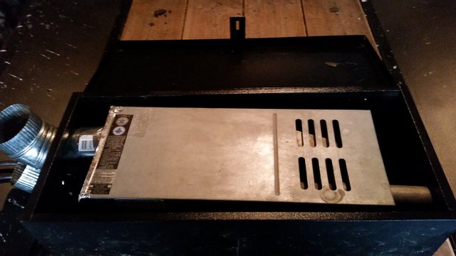

The test was successful so i needed a box to mount the furnace in, i found a small tool box that was the perfect size.

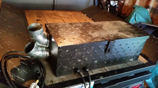

modified slightly, the propane line and power/thermostat cables go through the front of the box
i wanted to keep it portable so i could bring it only when needed. Excited for winter camping now! :D
