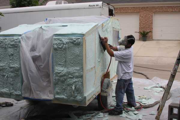

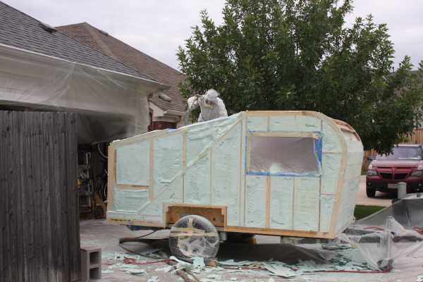

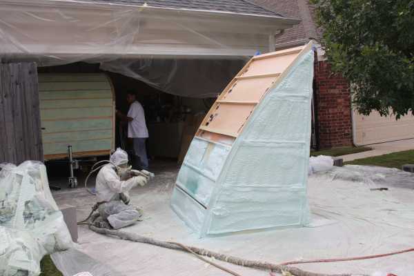

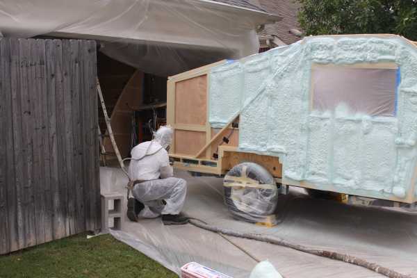

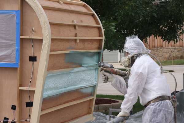

Today was insulation day... At first, I felt a little guilty for not doing the work myself. Now, not so much... Applying spray foam insulation is work thats better left to professionals. These guys worked hard for about 5 hours. It would have taken me a month!

We had the same problem, Mike. I called around a bunch to. Most foam guys either wouldn't call me back or I would immediatly get a "we don't do trailers" response. Only one company was willing to do the job. He said that they don't turn down jobs, big or small. There is, however, a minimum cost, and this job was at (actually $50 below) the minimum for them. See below for the cost...

I did the same thing. I almost order a DIY kit from TigerFoam (They have a fire retardent product). By the time I figured out how much I needed, it just made more sense to have it done. As you know, the DIY kits are not cheap. I would have had to order 600 BD Feet to get it done.

That's a good estimate, but I didn't pay that much! I think they miscalculated just how much labor was involved in the job. I paid $750 ($800 is usually their minimum), which is only about $100 more than a DIY kit. For a hundred bucks more, I couldn't justify (or rationalize) doing it myself. The guys even went around the trailer and covered all the joints in the framing with caulking. There shouldn't be any leaks anywhere.

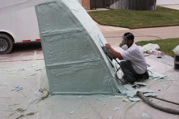

Wig wrote:...plus they had all the correct tool including on of those sweet saws.
I asked them about those saws... They said they were actually air powered auto body sanders. They just put saw blades on them. They cut through that foam like it was deep fried butter.
