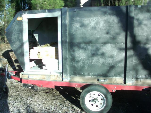

Postby ARKPAT » Sat Apr 23, 2011 2:41 pm
That why I said I was building as I go camping.
A picture of my first camp out at Grand Lakes of the Cherokee =)
This is after I got back from Petit Jean Gathering a few years back.
I cut the door out at the campsite.
:oops: :shock: :worship: :thinking:
It has been an experiment in salvage parts to build from. The only thing bought at that time was the HF frame ( on sale ) and twenty - five door panels for $25 of ( insulated french door blanks panels from Thurm-o-Tru ) ...... the three 8' x 2 x 4's where scrap ..... the hinges and door hardware was salvage yard pickings ~ $2.

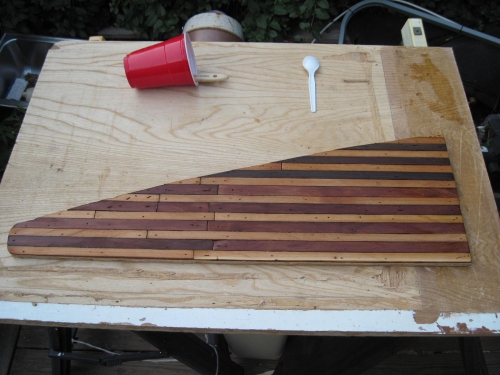

I built a cupboard face frame out of the oak galley sliders from the pop-up. Then, after applying the stain they were very, very different in color. They both appeared to be white oak, but one stained almost black. No go. Removed it and created a new face frame, ripping a cedar 2 x 4 for the sliding door tracks.

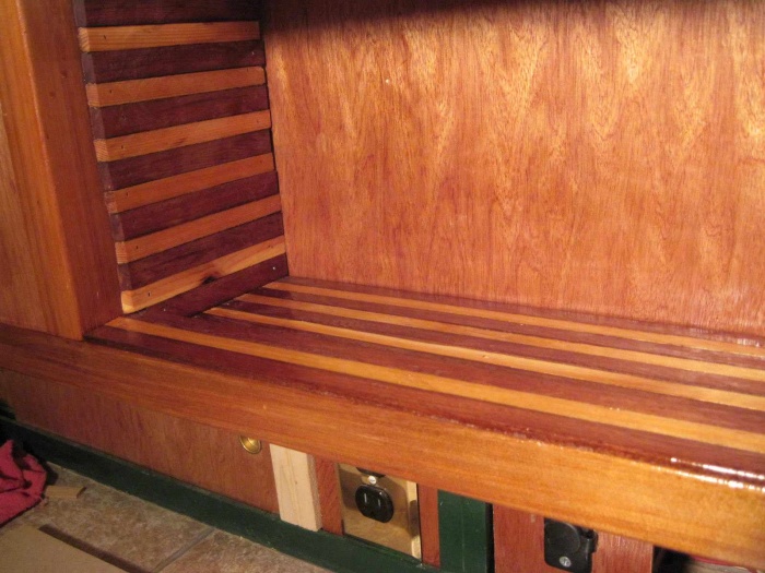

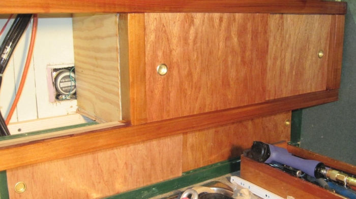

Here's a pic of the curbside cupboard w/slider doors. The finish on the sliders matches, the light angle makes it look off.
Now, what to do with the center section? Line it with cedar strips, what else? :lol:

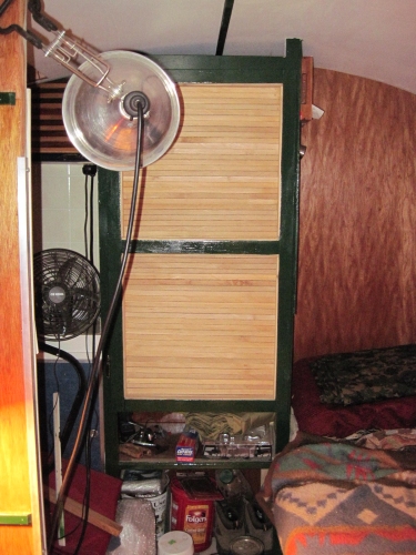

I wasn't happy with the appearance of the laminate covering on my bathroom upper cabinet door. So, it got my now standard... cedar strip
covering. :lol:
I made a matching cedar strip panel that I attached to the divider wall, near the ceiling. No pic now, sorry.
I also made a door for the upper "hanging clothes" area of the closet. Not sure if I'll make this permanent or not. Might be a case of cedar strip overkill. A curtain might replace it, so I'm putting off finishing the cedar. A portion of the bathroom cabinet door can be seen above the fan.

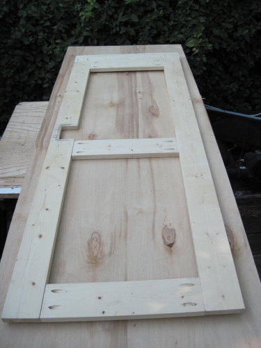

I also began work on the door.

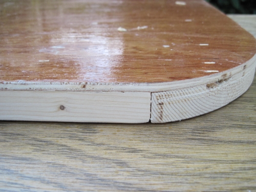

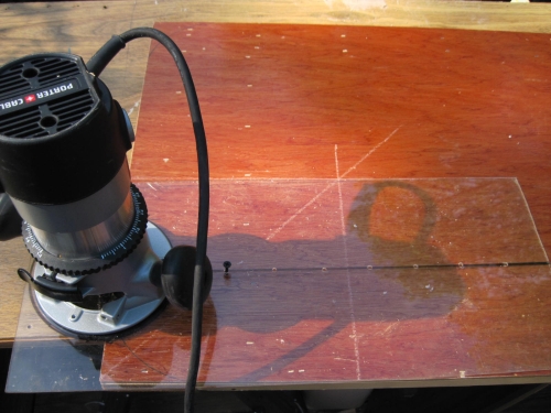

With the arrival of my new Porter Cable router (man, is it sweet!) I made a circle cutting jig from plexi and radiused the top corners using the same radius of my windows.

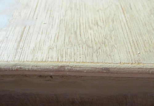

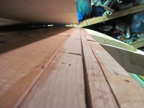

Sighting along the top of the hatch, I noticed a bow. 1/8" deflection on each end. This is somewhat worrisome but I was unable to think of a suitable remedy without disassembling the entire hatch. When it was first built, it was fine. I believe it developed a slight warp as it sat in place loosely secured.
I decided to reinforce the last roof spar (doubled 1 x 2 oak) with a 2 x 4 joined with Titebond and pocket screws. Hopefully this will provide a solid area for attachment of the "living hinge". If the warp doesn't straighten, hopefully the 1/8" deflection on each end won't be a problem. With that in place, the last section of roof skin was screwed down.

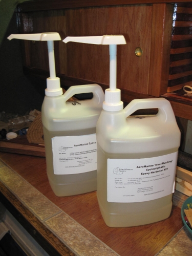

I plan to use digital camouflage print fabric for the sidewall treatment, epoxy laminate method. My 3 gallon order arrived from Aeromarine.

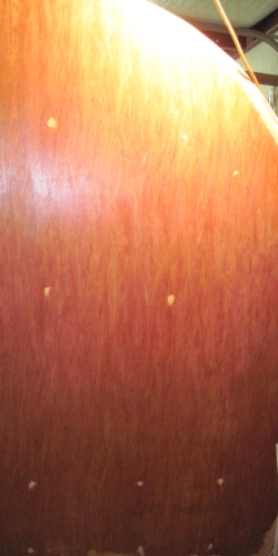

I began applying a base sealing coat to the luan. Loosely brushed on with a chip brush and then spread with a Bondo spreader. I have to pick out an occasional chip brush hair, no problem. When I apply the cloth, I will use foam rollers.

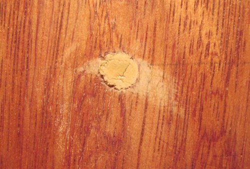

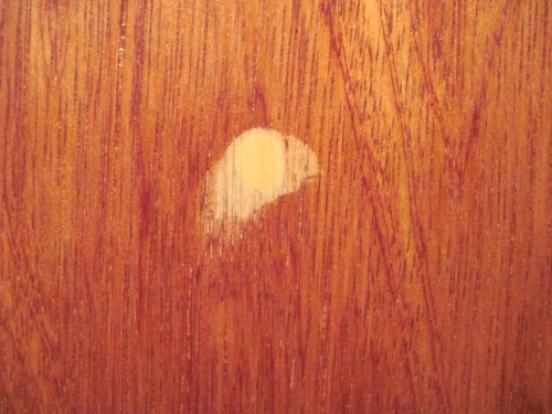

Elmer's wood filler is far superior to PL brand, IMO. Elmer's doesn't have a tendency to crack, PL does. Elmer's pic first, followed by PL.

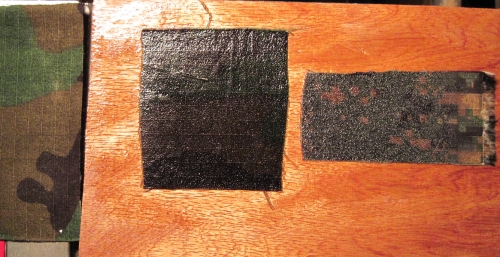

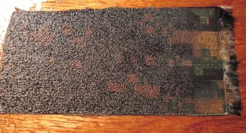

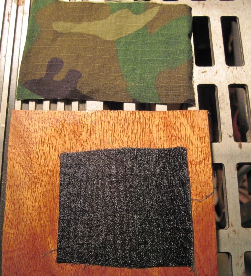

I decided to perform an experiment before applying the cloth to DD. I first coated some luan with epoxy and let dry 24 hrs. Then, I covered a small area with epoxy and placed the cloth sample on it and brushed a coat on top. The initial appearance was unnerving. The design on the cloth was gone, it appeared to be solid black.
After another 24 hr. dry time, still dark. The surface was rough and I lightly sanded it with 150 and applied a second top coat. 24 hrs dry time later, the design of the cloth can be seen again. All better now! (I also tested a swatch of the cloth I intend to use.) No difference between the two. Here's the progression.
On this swatch, epoxy covers the left two thirds. The remainder is dry.

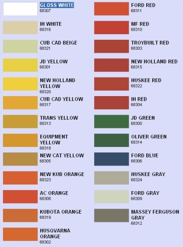

For the roof, I'm leaning toward using Valspar Tractor and Implement enamel in a color that will compliment the digital camo fabric. Looking at IH white now, which is a light tan or cream color. I have a terrible eye for coordinating colors! Any and all suggestions always welcomed.

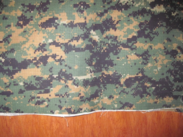

A better pic of the digital camo material:
The Valspar color chart:
Best match?

IMO I think you're on the righ track with the IH white. A little bit of neutral color but light enough to reflect instead of absorb the sun a bit. Can't wait to see your rig outside for a full finished pic.

The camo looks cool too! Can't say which I like best - the digital or traditional. They both look good. I'm not much help on the colors either, but I would probably not go with a white just because I think you'll be fighting stains. (There are a lot of plants with wild berries in our area. Mix that with hungry birds and...well you know.) My guess is that tan or light green would look good.
