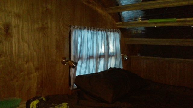

I bought a $4.97 sheet from Wally World and made curtains. (Yes I sew!)

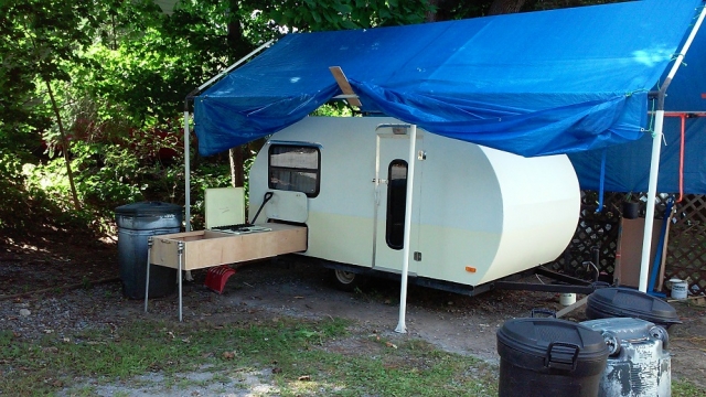

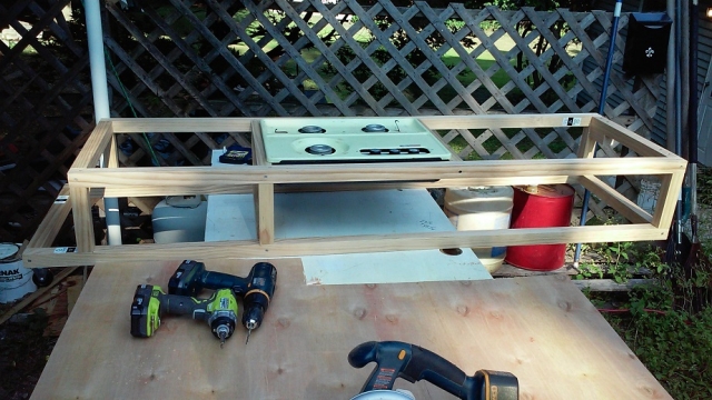

I framed out the slide out. If you look carefully you can see the wheels on the far left side of the frame on the bottom. The design concept was so simple that it eluded me for a long, long time. I simply grab the outer edge (right side of this picture) and pick up on it to put the rest of the weight on the back wheels, then just pull it out the side of the trailer. The wheels keep it from pulling all the way out as they hit the lip of the hatch. I have two pieces of pipe which now have thumbscrews and two pipes to use as outer legs.

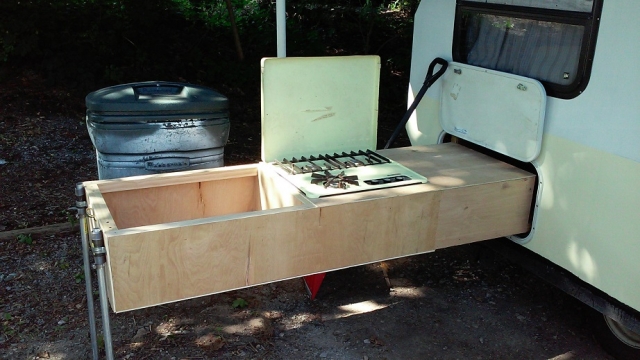

Here it is most of the way done. Counter space to the right of the stove, and storage to the left. I will probably put a cover on the left side, but decided to put that off until I test fly it all. The legs in this pic are held from sliding through the pipe by hose clamps. Way too wobly, which is why I went with the thumb screws.
Same shot a little further away, to give a better perspective of size.

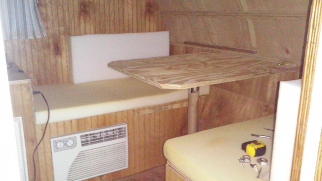

This was today's accomplishment, finishing the table, and getting the wall bracket installed. As you can see, I still need slipcovers.

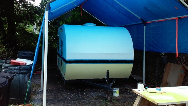

So far today:
Painting the black stripe

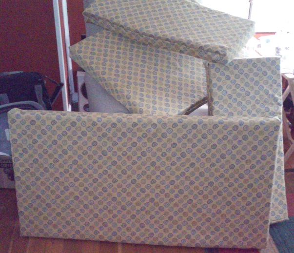

Cushions are coming along. Lots of hand sewing to do now, these are mostly pinned together at this point.

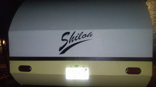

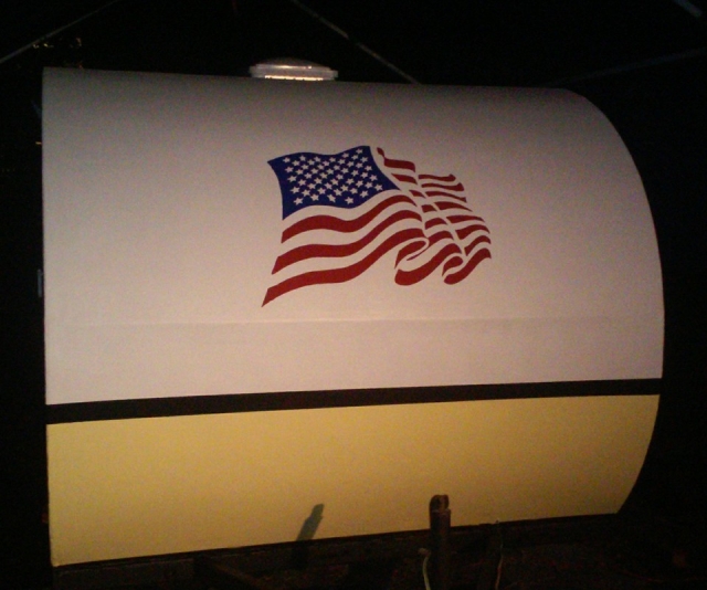

The decal I made for the back.

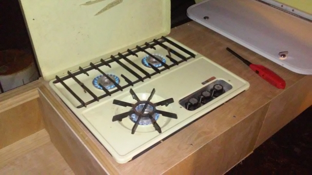

Stove works!. I don't have the propane lines all set, so for right now, I will just run the hose from the stove directly to the regulator and the tank. Eventually it will all be plumbed and the furnace will also have propane and the bottle can be permanently mounted on the tongue.

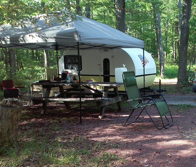

Like this?
Towed beautifully. My KIA downshifted on a lot of the hills, but never struggled really. I didn't need the mirror extenders that I bought, my visibility was perfect, and it backs up much easier than a teardrop, or I'm finally getting the hang of backing up. :R
Best of all, it did not seem to affect my braking at all, that worried me more than anything. The KIA has good brakes apparently!
