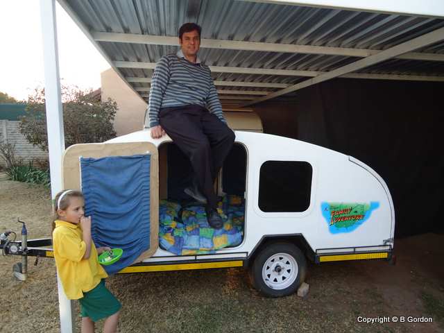

Yep! To prove my point, I took a photo with me on top of the trailer. I weigh almost 100kg (220 pounds), and I think I could easily have doubled the weight on the trailer.

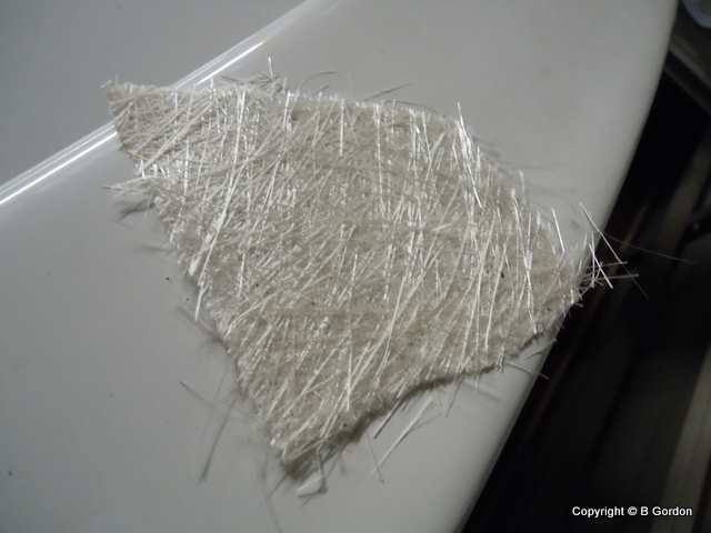

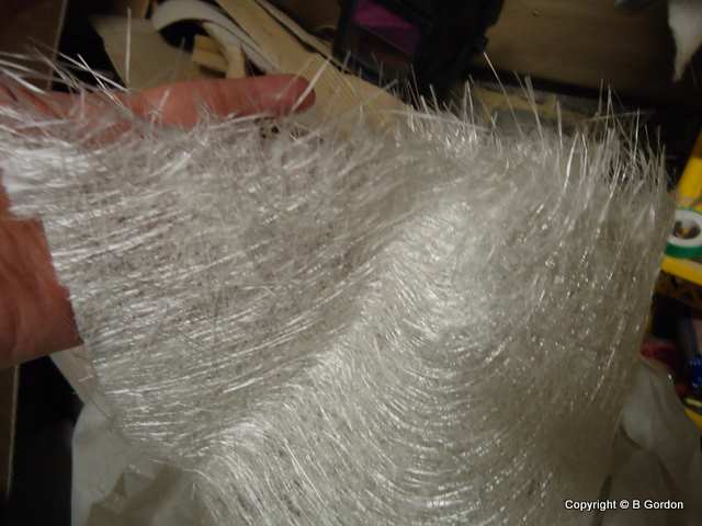

Changer wrote: Oh, and other question, how is strand fiberglass like that applied? Put into resin and smoothed on,or what?
Very simple. Cut the chopped strand mat with a pair of scissors to size (like cutting material), and place it on the cardboard. Mix the resin, and pour it on the fabric, and wet out the fabric with a roller like this one. It's almost like painting a wall with a roller.
eamarquardt wrote: I believe the fellow used a "chopper gun" to lay his glass.
No. I used polyester resin, applied with a roller, and chopped strand mat 'fabric'.
