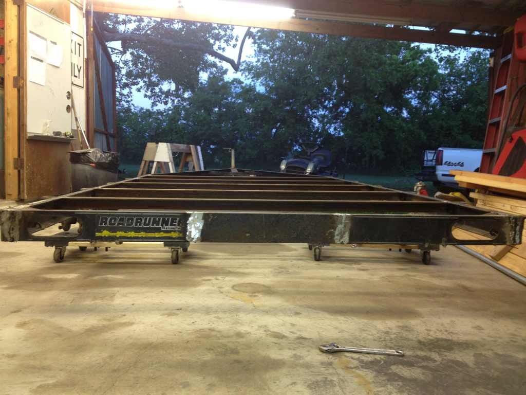

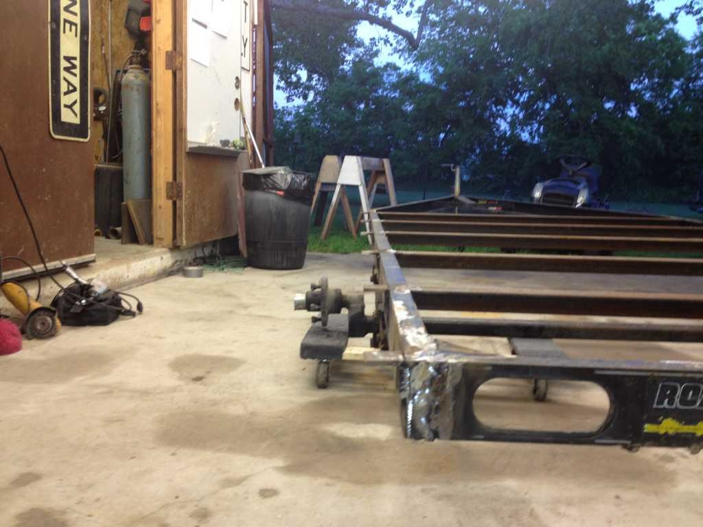

Well the axle has been relocated. All the other metal off and starting to weld the cross braces in. As I weld them in I will cut out the bent ones for the boat.

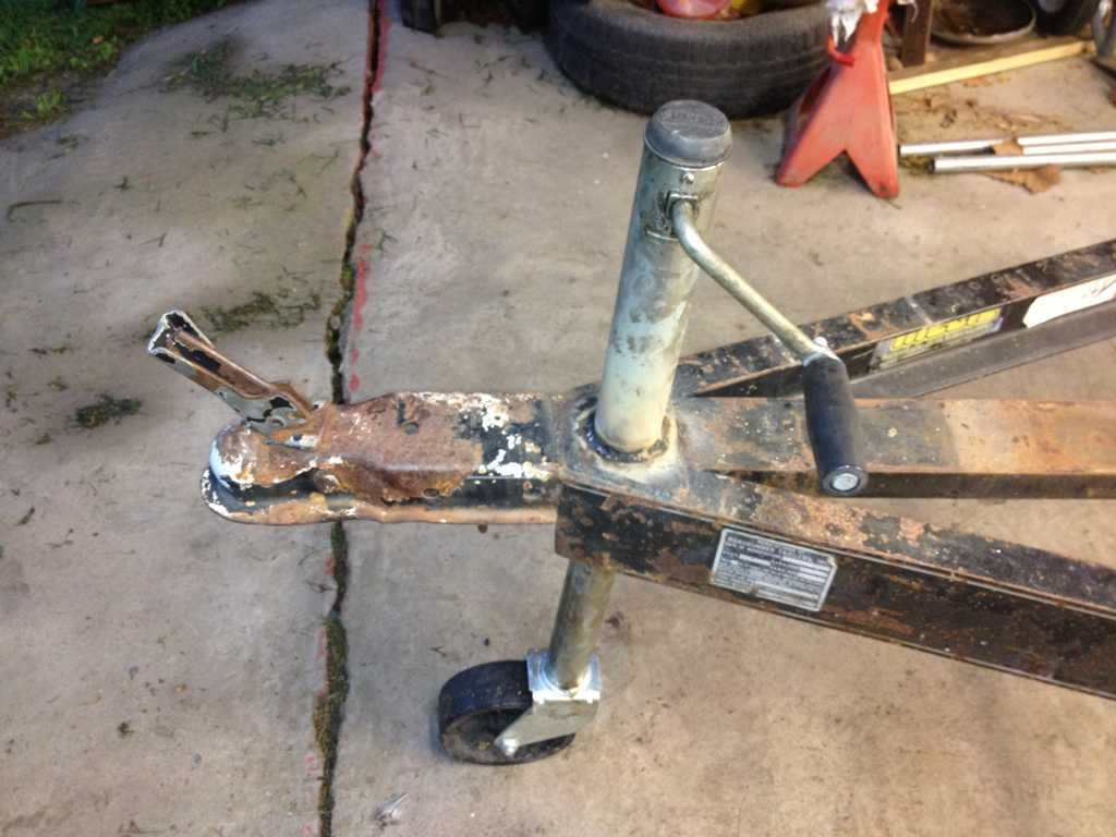

Had about 6 hours off and on to work on the trailer this weekend. Got all the cross members in. They are 2"x2"x1/4" angle spaced on 24" centers. Might be a little over built but that is what I had. I went ahead and welded tabs on the outside for the hand over. The outside wall will be about a 1/2" past the tab for an overall width of 6'3". Also was able to get a new jack installed on the front. This week hopefully I will be able to get it wire brushed down and painted by the weekend. Then maybe some real building. Have a good week folks.

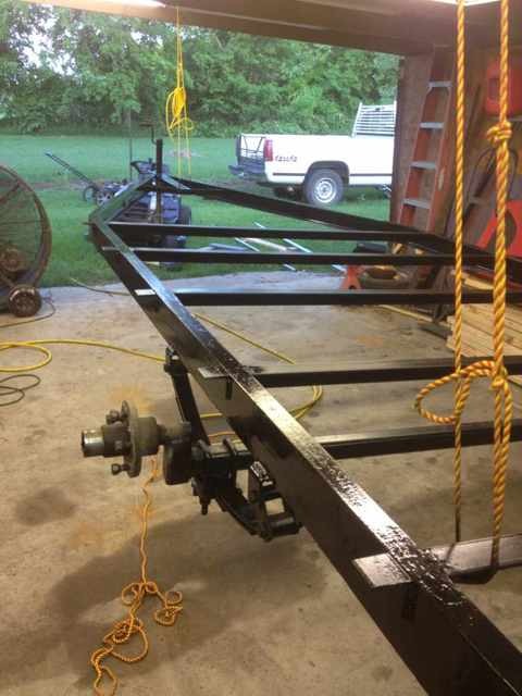

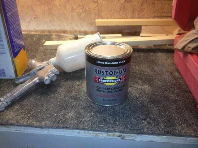

Got the trailer painted today. Two coats of good'ol Rustoleum industrial semi gloss black. Maybe this weekend some flooring. Here is a link to a short time laps video. Just playing around with my camera.
