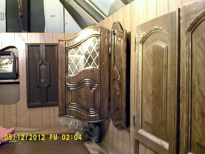

quick peek of the latest (and last) set of cabinet doors, mounted hinge centered to take advantage of the mirrors.
I'm just now considering hinging upward the area where the two doors hinge, in case I'm not small enough to look in the mirrors as they are, attached to the wall. I will be able to tip them upward to see myself with. (pictures to follow...)

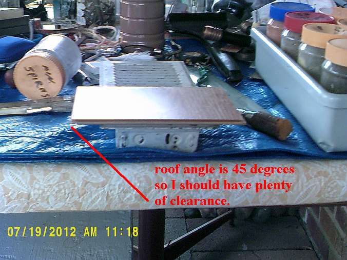

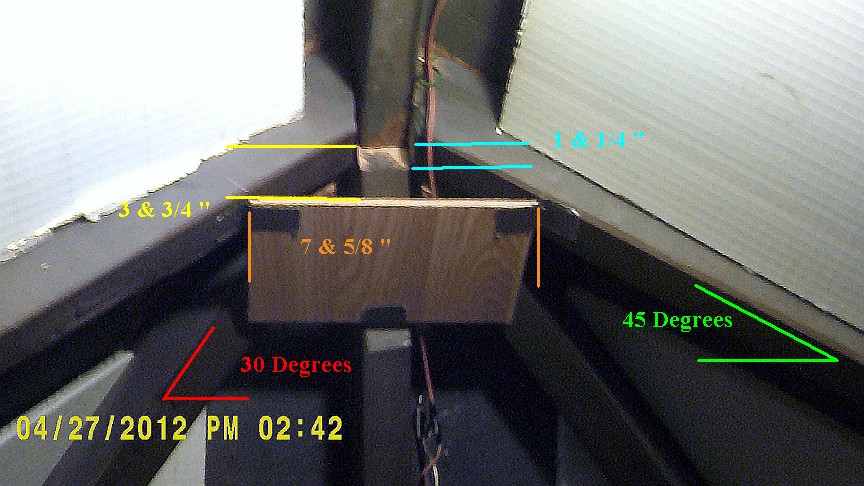

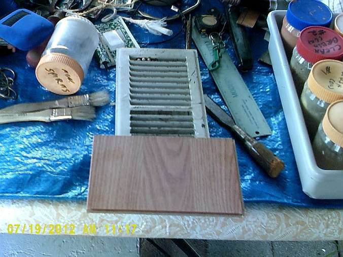

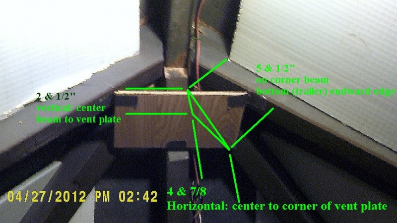

Ok, the WORST part of the ceiling vents seemed to be the ends, so I tackled them first.
3 pics to fill the space.
1. Trial chunk of "hardwood flooring scrap" to "cap" the end vent.
2. Sizes/dimensions
3. Solution pieces, 4 to make (2 for each end) and attach, with the cap pieces.
Then just 3 fans to complete the vent system for one end. (1 fan draws in air at the top to the interior, 2 fans to draw out air at the soffits (both of these exhaust fans will probably be operated at the same time to move air from inside out the soffit. probably not the same time as the interior draw fan though. ) Time to start tearing apart old computer power supplies.

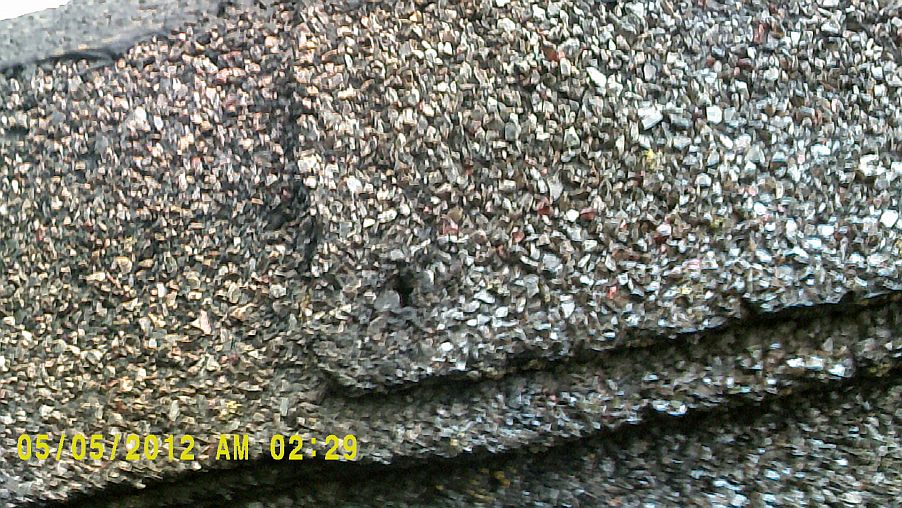

While working on the ceiling I noticed light coming through at the ridge line...
So,...
I looked closely to see WTF and that's what I see.
Finishing nails to hold DOWN the ridge cap shingles. (not wiggling loose and penetrating up, but pounded down through the upper/outer surface...
So, to remedy that... All roof exterior is 50/50 oil based poly and mineral spirits to seal along with tar based roofing caulking to the ridge line and to the finishing nail(s) holes.

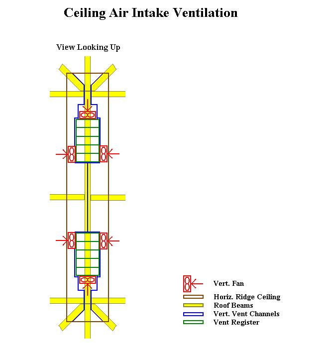

This should clear up a lot about what I am going to do with the ventilation system.
If it is too cold inside, I'll bring in air from the sunny sides. If it is too hot inside, I'll intake from the shady side.
The register can be closed, too.

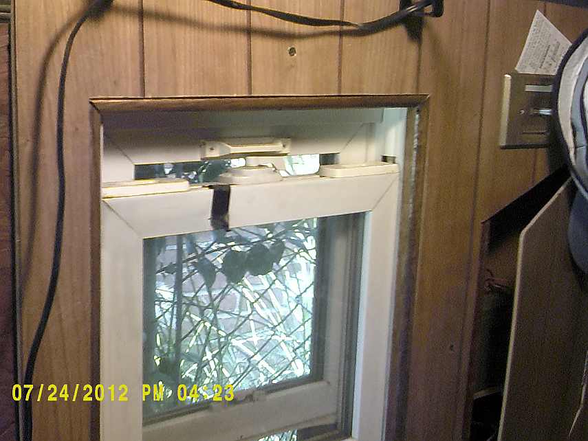

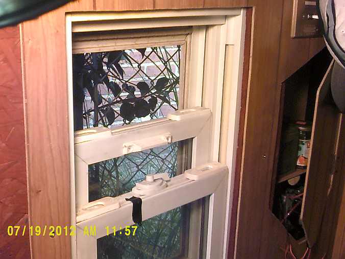

Postby PcHistorian » Wed Jul 25, 2012 9:32 am
As far as the ceiling ventilation system goes, I'm going to follow Bonnie's lead and make a cardboard ductwork, then from there I'll decide whether to go to paneling or to just poly the cardboard.
in the mean time I wanted to get some things out of the way.

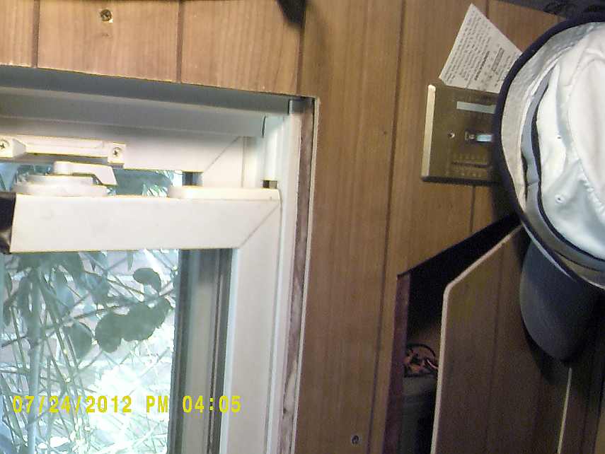

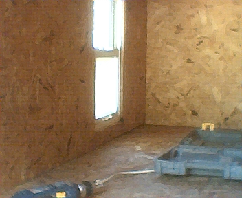

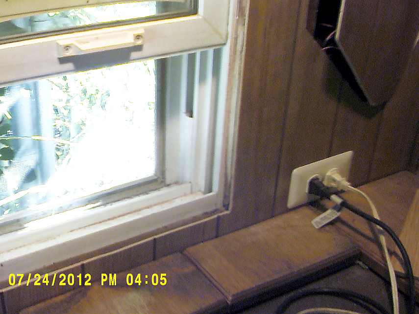

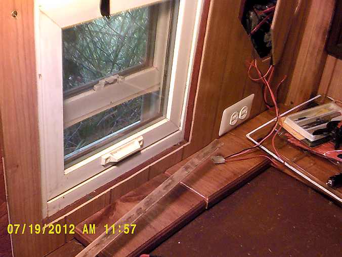

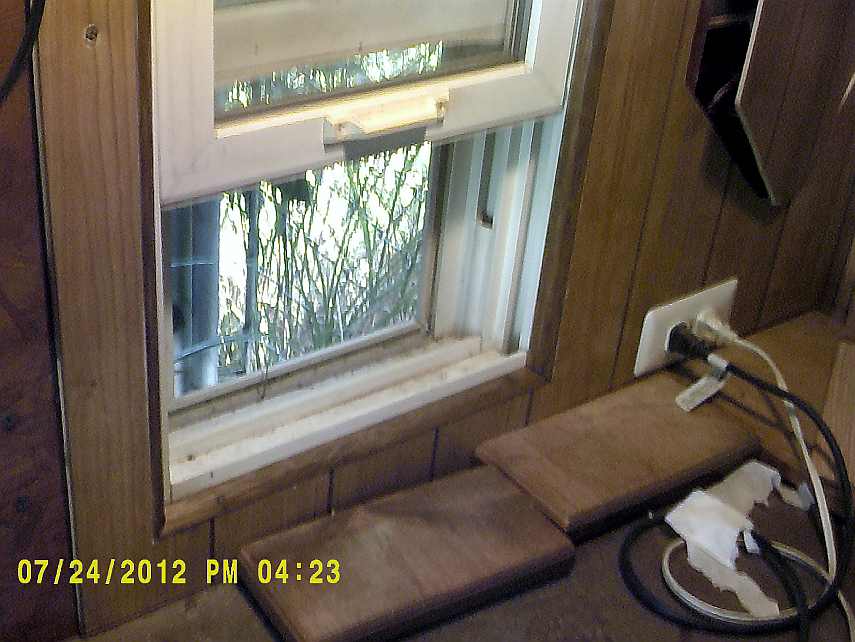

first thing was the window framing.
(CLICK ON PICTURE TO EXPAND)
Note the red stained, chip board behind the paneling. What you will see on the right side is indicative of the other 3 sides. (yes, that's 12v wiring all over the place.)
I was surprised at how "untrue" the chip board was from the original builder. So I sanded it true. Where the red is missing is what got sanded. (I did not restain.)
I had 3 pieces of 1/4 round and I liked this one the best. :-) I did shim the paneling some in spots to level it with the trim.
so window is trimmed, first phase.
I am considering one other piece of trim, a 1" x 1/4" trim piece on the paneling face to frame it, once more.
final phase for that is the window dressing.
options include drapes, pull down ratchet blind, horizontal blinds.
I think I'll go with the drapes and horizontal blinds...
Ceiling goes in first, so I can put the window dressing hardware safely in the "wall meets ceiling" corner, out of the way.
I am planning on putting as much interior hardware as I can in the corners to keep from "braining" myself on them, or at least minimizing the damage to me.

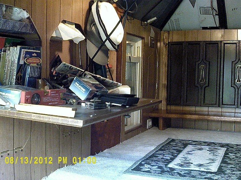

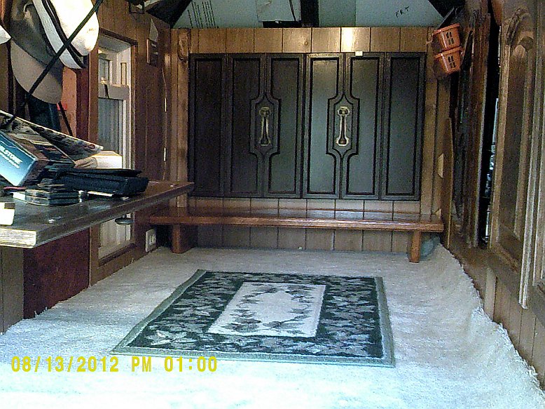

Postby PcHistorian » Mon Aug 13, 2012 11:22 pm
Sorry about the double on the window trim install. I'll delete the first post as soon as I figure out how.

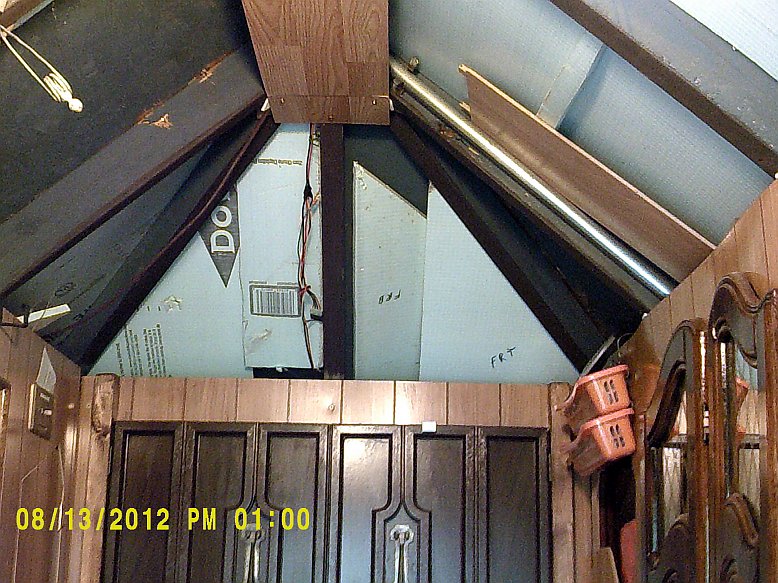

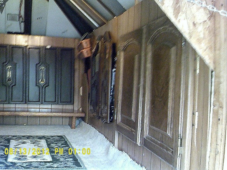

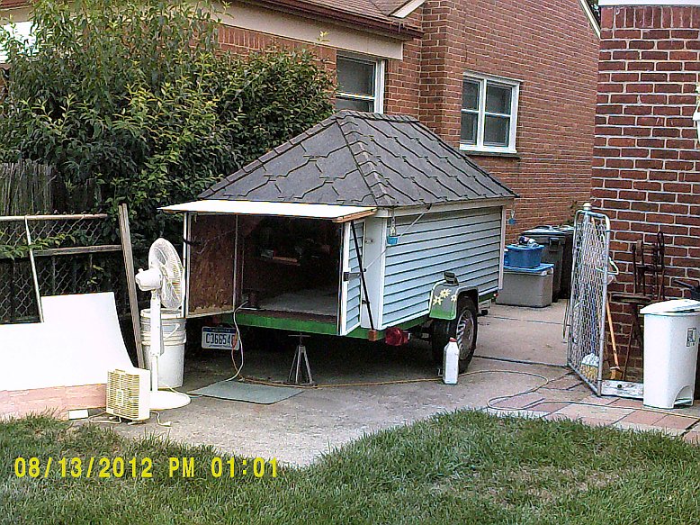

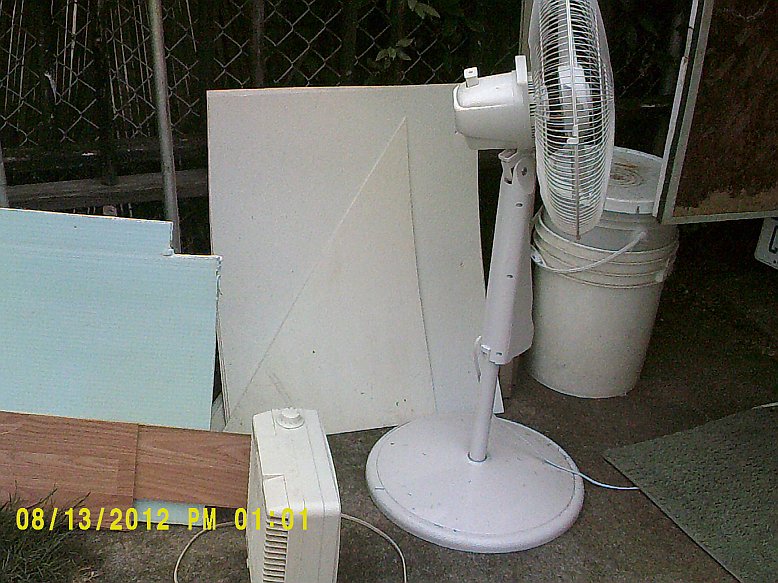

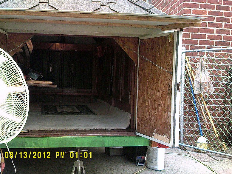

Well, I have been making sawdust. (here's the proof. ;-)
this is a progress report mostly.
Here's a before picture to start it. This is the raw interior as I got it.
And here it is up to date around the walls and a spot look at the ceiling duct work.
Yes, some carpet trimming is due, for the vertical cabinet door posts. I may cut the posts though, since they are screwed to the wall anyway.
This shot shows the ceiling duct board(s) but the register is yet to be installed in them. (fore and aft.)
More on the ventilation and those updates in the next post.

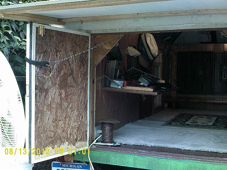

These next shots are of the exterior doors, and they are going to get paneled. The door triangle braces are going to get paneled, or sanded, and painted, or stained and poly.
then here's a view from a bit away.
lastly, here are some of the ceiling interior panels. square for the center, triangular for the corners.
