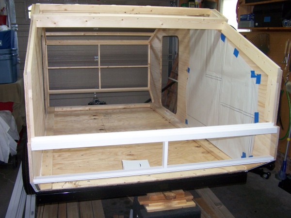

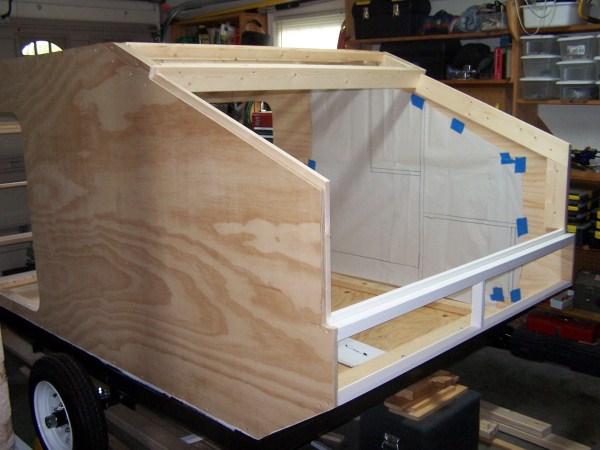

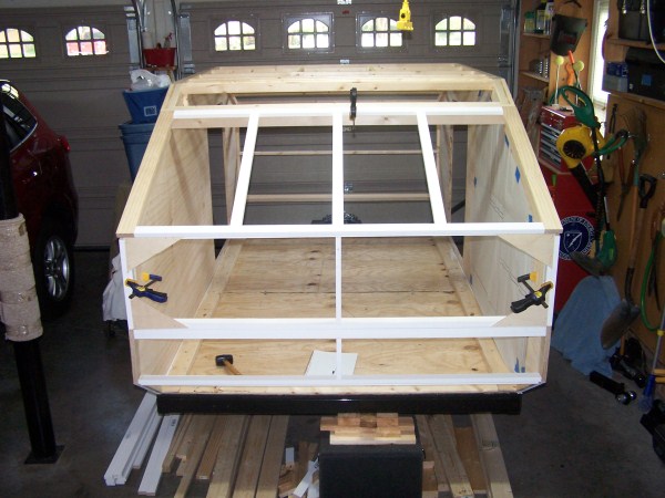

Finally completed the cabin framing including the two piece hatch (I'm calling it a hatch and tailgate). After a lot of thought, I decided to go with the two pieces very similar to one of Mike's early versions on his weekender. Put the new Kreg Mini Jig to work in this area to do the hatch and tailgate and several blind stiffeners. Still have some slight squaring to do on the two hinged parts, but will wait until I skin them to let the plywood shell hold them in place. Only out of square about 1/8" on both pieces. Also still thinking about seals. The two pieces make sealing a little more complicated. The blank section on each side of the hatch will get some sort of filler with a gasket. Decided to use the 1X4 as a lip to channel any leakage down and to the rear. The hatch will overhang the tailgate about 1/2". Tomorrow I start the luan paneling on the interior and laying out the wiring before I install the foam board.
Rear framing complete and ready for hatch and tailgate
Another view
Hatch and tailgate partially open (no hinges yet)
Hatch and tailgate in closed position (corner gussets are temporary to keep tailgate square)
Another view of hatch and tailgate closed

Postby PcHistorian » Fri Mar 30, 2012 3:01 pm
looks great. you can always go with slide outs for the rear hatch and tailgate.

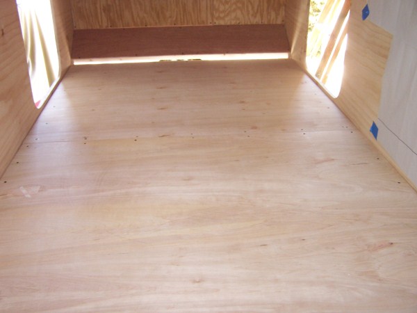

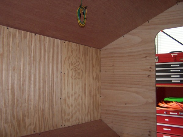

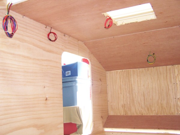

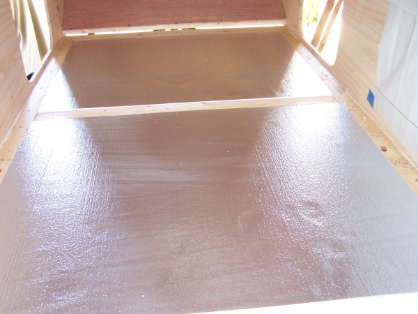

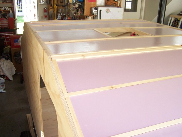

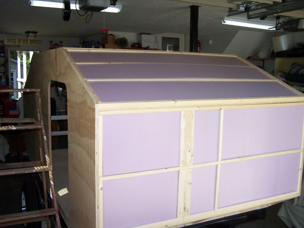

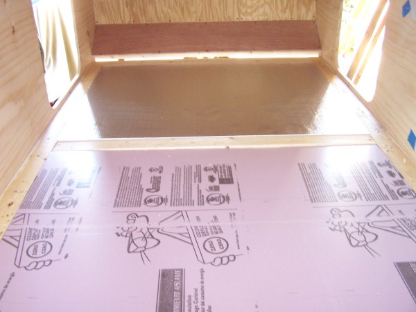

Good weekend for the weekender. Wife was out of town so I got a lot done. Installed interior paneling in ceiling and end walls. Wife got her touch with the bead board on the front end wall. I'll use bead board on the other end wall under the cabin cabinets and possibly use it as inserts in the cabinet doors. Ran all the wiring for the cabin lights and fan. Decided to insulate the floor. Basically ended up building my floor upside down from what most have done. Had a minor glitch with the insulation. I was trying to insulate 1.5" since my spars were 1X2 with the 1.5" side vertical. Couldn't find two layers of 3/4" foam board so I bought enough for three layers of 1/2". Turns out the 1/2" foam board is actually 9/16" so I went back and bought some foil lined foam that was only 7/16". I planned to use two layers of the 9/16" and one layer of the foil backed 7/16" board. That was still 1/16" too thick. I put that in the floor with luan paneling as a cover, but decided not to take the chance on the cabin insulation. I was afraid that the 1/16" extra thickness would bulge the outer skin so I ended up installing only two layers of the 1/2" stuff which is actually 1 1/8". That leaves a little air gap, but it also helped to work around the wiring in the ceiling. I may face that small air gap with Reynolds Wrap before I install the outer skin. Will start building cabinets this coming week.
Ceiling paneling (luan) screwed and glued.
Wife got her bead board on front end wall.
Wiring for cabin lights and fan. That big roll on the left goes to the converter/charger power source.
Wiring running through roof area for cabin lighting and fan.

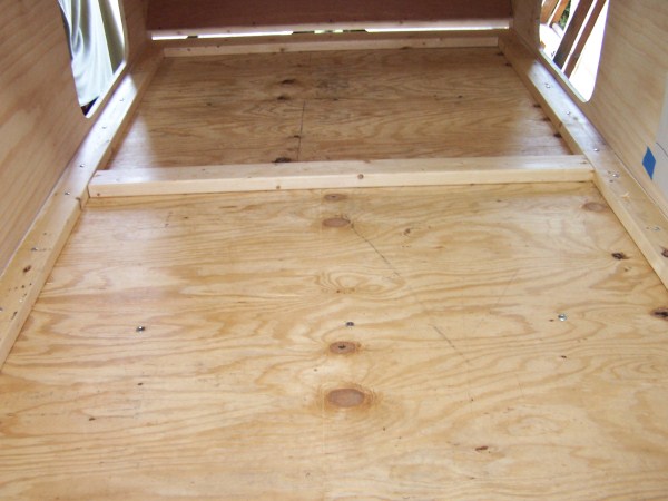

Decided to add center nailer and insulate floor.
Used two layers of the regular foam board and one layer of the foil faced board. This resulted in 1/16" too much thickness
but I wanted to see how it would look. Not critical under the mattress, but decided not to use all three layers in the rest of the cabin.
All three layers in place.
Finished floor. Can't really see a bulge around the edges, but I didn't want to take the chance on the rest of the cabin.
Wall insulation complete with just two layers of the 9/16" foam board.
Roof insulation complete. Used the air gap to work around the overhead wiring. Still had to notch a few places, but
will fill those with scrap pieces from some old fiberglass bats.

My power plan is to use a Progressive 4045 converter/charger with a battery. All the cabin lighting and fan will run off DC with a few AC receptacles front and back for things like ceramic heater, chargers, coffee pot, and small microwave.

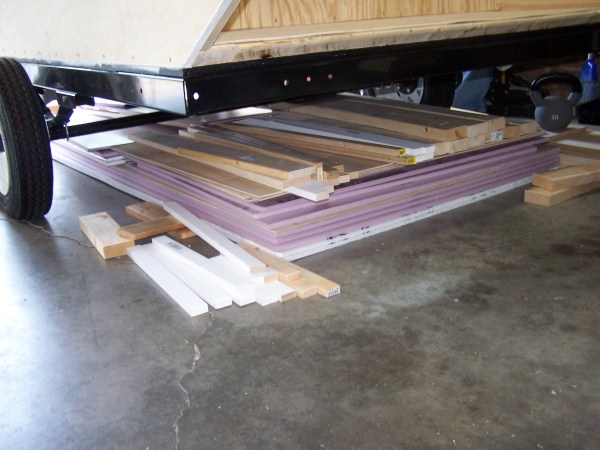

Postby les45 » Mon Apr 02, 2012 3:20 pm
Time to clean up about two months worth of stuff so wife can get her car back in the garage. I told you that I was a little OCD.
Everything tucked under the trailer. Moving on to the cabinets.
