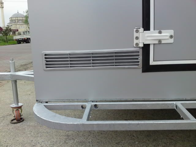

Postby oyunageldim » Mon Apr 30, 2012 11:45 am
Hello again, continued :beer:
I did the back cover.
To prevent corrosion of sweat into making.
Polyurethane foam shook :)
The front foot.
I did lifter.
Did not do a round of composite panel.
I've scratched the inside.
Outside the image will be much better
Composite panel.
Electrical panels did
It was cheap :D
The ceiling will pop up.
I teardrop trailers
I did not see pop-up roof.
Do Have?
Glued with polyurethane adhesive

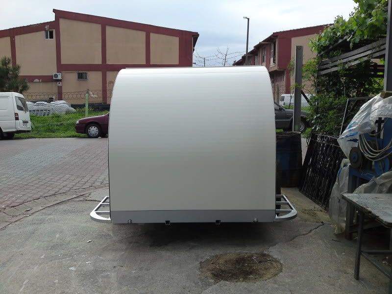

Postby oyunageldim » Tue May 08, 2012 1:49 pm
Hi, good work everyone :)
came to the spring.
Each party flowers, insects.
I love this season :beer:
I continue
I set fenders
My feet have a very strong balance
Corners of the trailer looked bad
But now I a very nice
Before made of aluminum corner
Then I made nickel-adhesive
