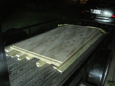

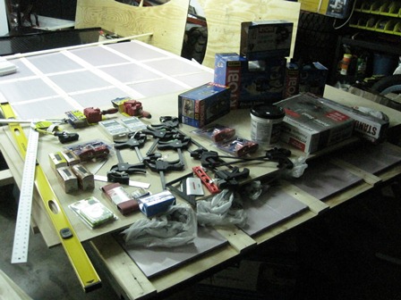

So Friday nite I went to Harbor Freight, got wood clamps, saw bucks, a seat, and a roller stand. I also wanted to give a shout out to Rahn, my Favorite Harbor Freight Rep that helped me out getting some things.
Then on to Home Depot to get some Birch ply wood for the walls, and a Belt Sander, Router, and Biscuit Jointer....Wow, This project is starting to feel like Christmas.
Behold the Load.

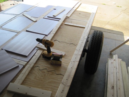

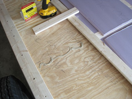

So, I didnt get out to the garage on Saturday till about 3:15pm. I started in on trimming and fitting the top layer of the floor. After I got that done I then disasembled the floor to the first layer of the 1/4 inch ply wood and put the lidquid nail glue down for the floor joist.
Top Layer cut and fitted.
Gluing the joist
Glueing the joist

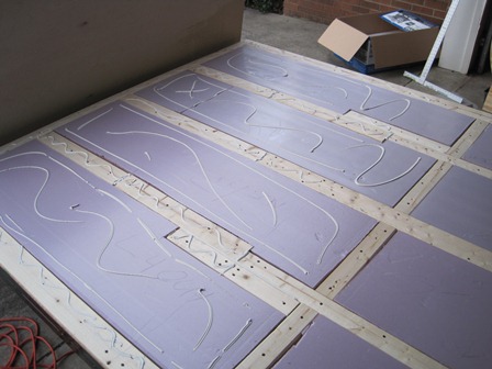

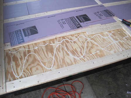

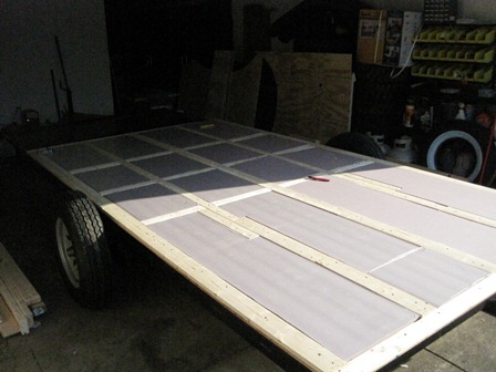

Then next I glued the foam insultion, I did have to make a run to Walmart for more Lidquid Nail Glue....it just doesnt go as far as I thought......Then screwed all the joist down to the first layer of plywood.
Glueing the insulation.
2nd Layer complete, now on to the top layer.

Postby KCStudly » Mon Jul 28, 2014 9:34 am
Spread the glue with a notched trowel (cheap plastic one will do, or even cut your own... I use fake credit cards that come in the junk mail). The glue will go further and it will give you a better bond.

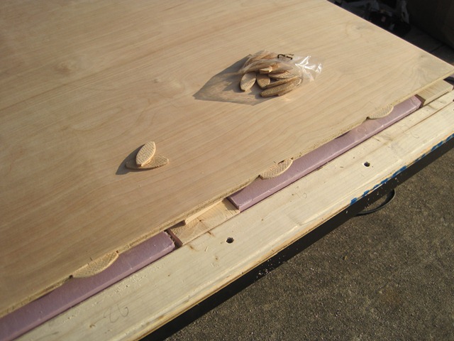

Postby BuildingForFun » Mon Jul 28, 2014 9:49 am

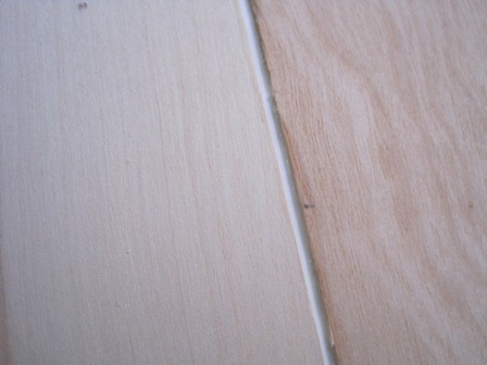

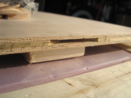

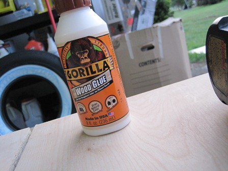

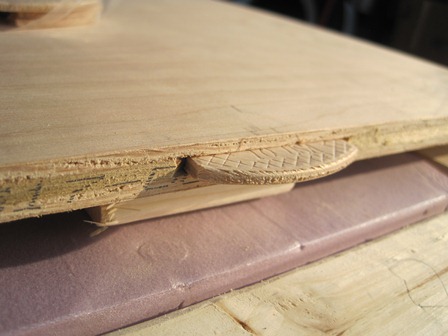

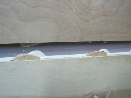

Next I opened up the new Biscuit Jointer to joint together the top layer of flooring. The instructions that came with it was, "use white wood glue that is water based so that the biscuits will swell and expand, making a strong joint." So while at Walmart I also picked up some Gorilla Wood Glue......Hey, nothings stronger that a Gorilla, So it ought to keep the joint nice and strong...Lol

KCStudly wrote:Spread the glue with a notched trowel (cheap plastic one will do, or even cut your own... I use fake credit cards that come in the junk mail). The glue will will go further and it will give you a better bond.
Great Idea......Wish I would have thought of that sooner......I will have more gluing to do.....and I think I have a notched, ridged trowel.

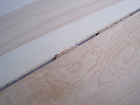

Postby BuildingForFun » Mon Jul 28, 2014 9:55 am
Gorilla Glue....Should be Super Strong...lol.

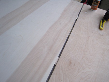

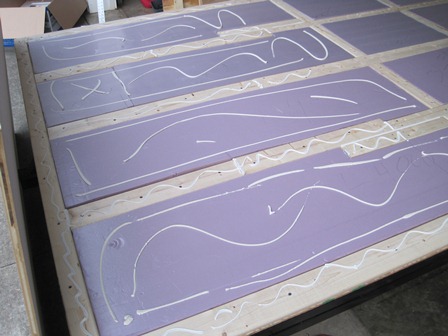

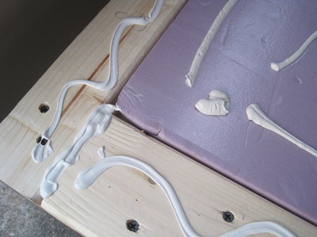

Postby BuildingForFun » Mon Jul 28, 2014 10:03 am
After making the slots with the Jointer. I then glued the 2nd layer of the Joist and Insulation. At all the joints where the Joist met each other, I put a bead of Glue. Then laid the 3rd layer on top, glued the biscuits and joints, And Screwed everything down tight.
2nd layer glued.
Where Joints met, I put an extra bead of glue.

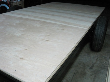

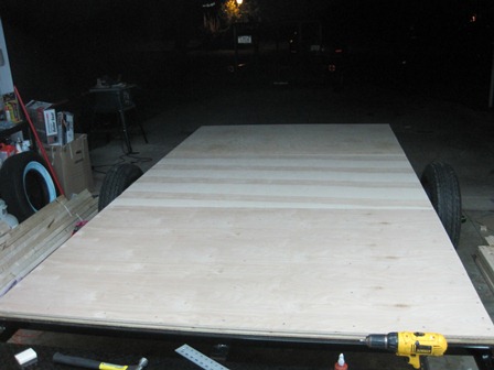

Postby BuildingForFun » Mon Jul 28, 2014 10:13 am
And Finally finished up....all jointed together, and screwed down.

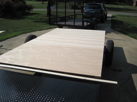

Postby BuildingForFun » Mon Jul 28, 2014 10:16 am
I also laid out the plywood for the wall, and drew out the profile lines. This Weeks Goal is to, (Take the floor off the frame, and glue the aluminum to it. Put back on the frame, bolt to the frame. Then get the walls cut out and temporaily fastened to the floor.)
