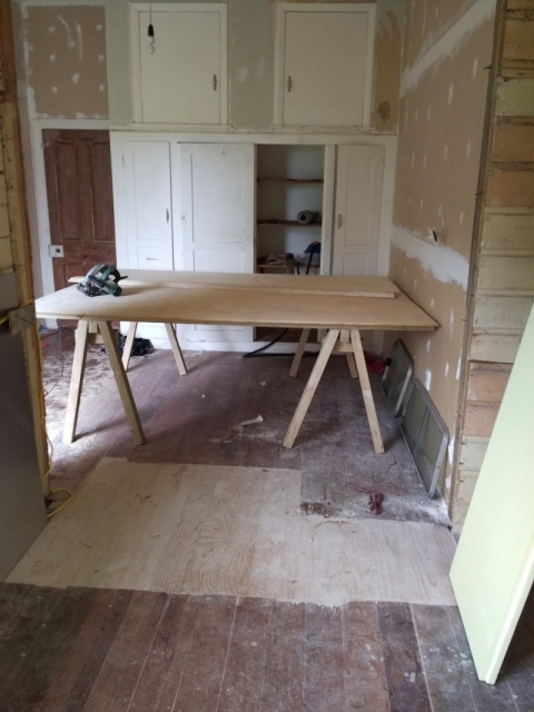

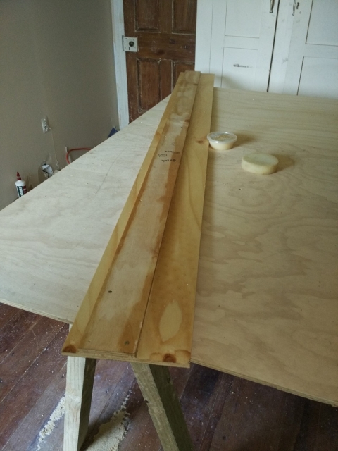

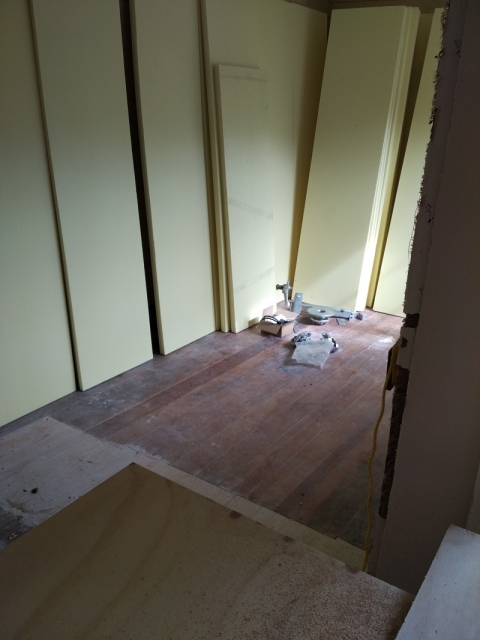

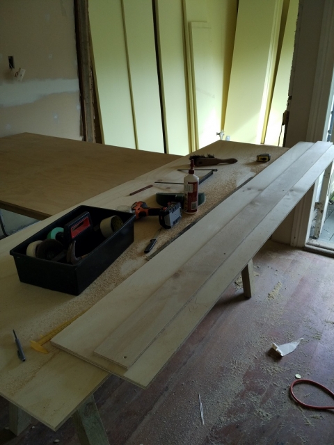

Built the indoor table for the glueing and vacuum bagging using the oversize sawhorses. Here I am cutting the second half to size. I made a cutting jig for my circular saw out of the waste.
The Dow Corning Foamular 250 available here is shiplap, yellow and made in India.
the glueing and vacuum table

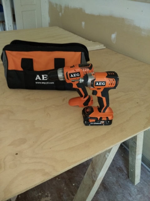

(edited to avoid exciting anyone) bought a new drill driver combo when in town, a six year replacement warranty on the tools, three year replacement warranty on the batteries. Made in China. ( The Makitas with the spec were more than twice the price. I have thirty quality power tools and machines and ten others. A quality tool may be defined as a tool you fix without thinking; these are not those, if that makes sense. There are movre views on tools than good views in Yosemite and each is a pleasure to someone. I will only say that I had a friend, now passed on, who owned a top spec brand new Porsche 944 and a rundown apartment in a back street. I loved him dearly but I don't copy him. I fully expect to hand in my tool kit before my current collection is worn out. ) Drill is fine, driver is amazing. The other battery is on the charger. Drove fifty 3in screws on a bit of a charge.

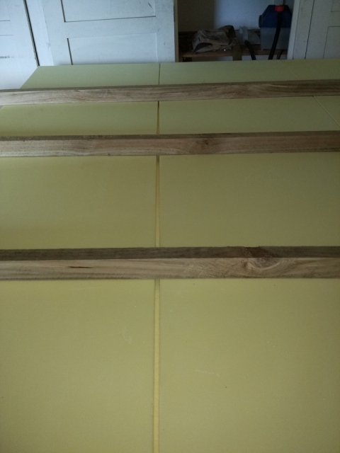

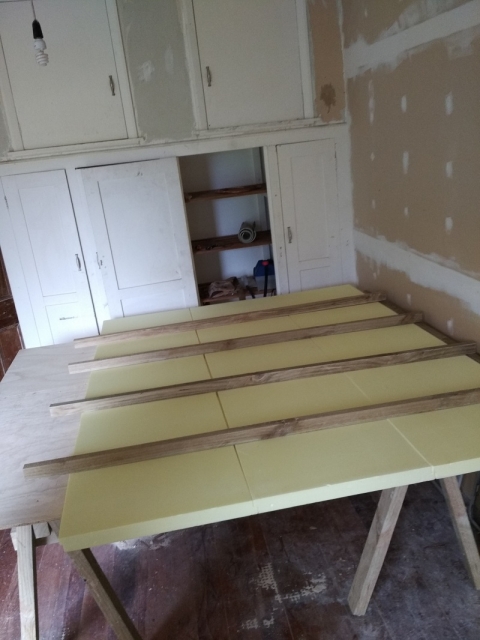

making up homemade sash cramps for glueing the foam edge to edge. The sheets are not straight nor square, I will make the panels oversize and cut down square.
example of unstraight
putting beeswax on the sawing jig for the circular saw. I put it on the plate of the saw and blade too, from time to time. Huge difference in effort needed. Incidentally, to make a sawing jig like this, just cut an absolutely parallel sided rectangle about 4 inches wide and as long as you want, glue and screw it onto an oversize bit of ply and then run the saw down each side, once on the narrow side, once on the wide side, and let the blade do the measuring for you. If you make the effort to do one, once you have your line on the material to be cut, you just lay your jig on the line and screw it or clamp it and run the saw down it, vroom, blade cuts perfectly on the line every time. this one is 8 feet long

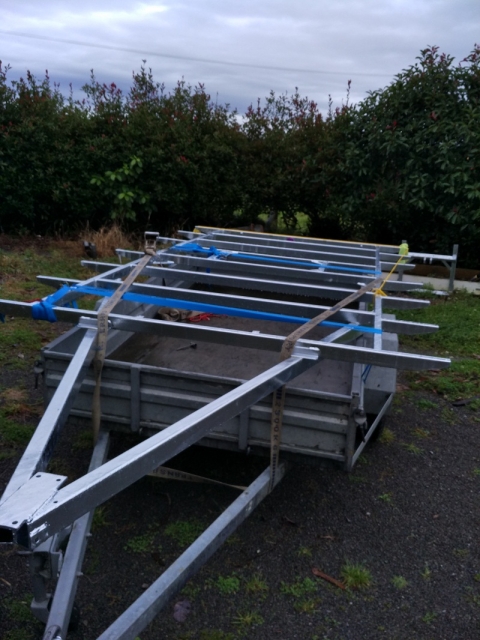

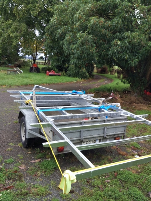

Here are photos of the chassis back from galvanising.
front view
rear view. All the cross-members bar three are galvansised inside and out, ditto the a-frame. The rails are galvanised outside. I may put some rust preventative in them.
I love the look of galvanising...it makes jewellry out of steel!
You cannot see it clearly but the chassis has conduit holders welded on and all holes drilled for the trailer lights. Likewise the holes have been drilled for running the brake pipes and hoses in a neat way (Hydraulic brakes).

Postby KCStudly » Wed Apr 05, 2017 11:25 am
It's my understanding that you can not galvanize a sealed item, like an enclosed tubular frame rail, due to the hazard of the air volume expanding with the heat of the process. A friend has fabrications galvanized on a fairly regular basis and he says that if he does not provide appropriate holes, the platter will either do it for him (with or without permission), or they will refuse the job.
Check your chassis again and see if they did not add holes; your tubes may already be galvanized inside! :thumbsup:
Re: 11'6" three berth ply/foam/aly composite caravan
Postby hossesdad » Wed Apr 05, 2017 4:15 pm
KC, How to find out where the galv got to? Your are exactly right about the sealed chambers needing to be drilled, those closed members had the biggest holes i dared drill in them (10mm/about 3/8ths) and about five per member, but they are expansion holes to avoid explosion and to drain out any galv afterwards and I didn't think to let in enough galv for coverage. I have always assumed that the galv doesn't do a thorough job through those holes but like all assumptions, it begins with an 'ass". I will today e-mail the galv company, Webforge, and ask them their opinion.Something would depend on how long the frame spends in the galv and whether it is turned. I don't know those things. :thinking: :) But if there is galv inside those tubes it will be on the floor of the tube which is where it is needed because that is where the water will be.
I used angle iron in places and made as much tube open both ends, probably 70%, as I could in order to get throrough galavanising. There is always room for more thought. I could have opened decent holes in the closed members and welded them shut afterwards, subject to holding my breath whilst welding...I won't use galvanised tubing for welded structures because I can grind the zinc off the outside but not the inside, so the dangerous fumes are still there. Usually green. Ask me how I know.

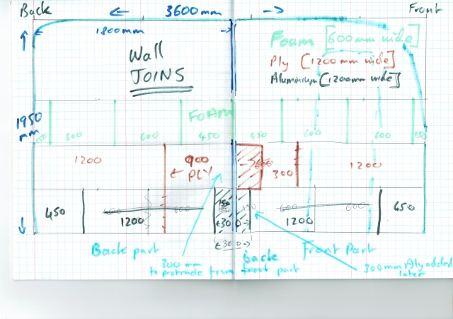

For those of you who use Sketchup and Solidworks, sorry, I use Ebi's crayons and pages stolen from her schoolbooks. (And wife has a technology company! 8) ) Here are my calcs of the wall layout, trying to put the joins in sensible places. I post it for your amusement....I would describe myself as an enthusiast for technology hampered by a horse-drawn mind. :lol:
(edit) The walls are being made in halves and joined together with a spline in the foam, the overlap on the ply and the 300mm aly strip.
