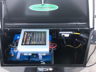

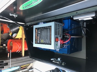

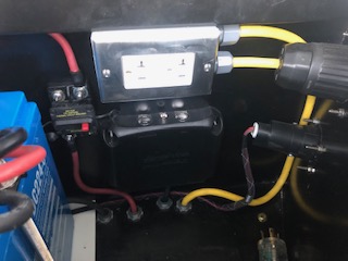

ricky herbold wrote:Picked up a couple of 6v batteries a was able to complete
The rest of the wiring in the tongue box today

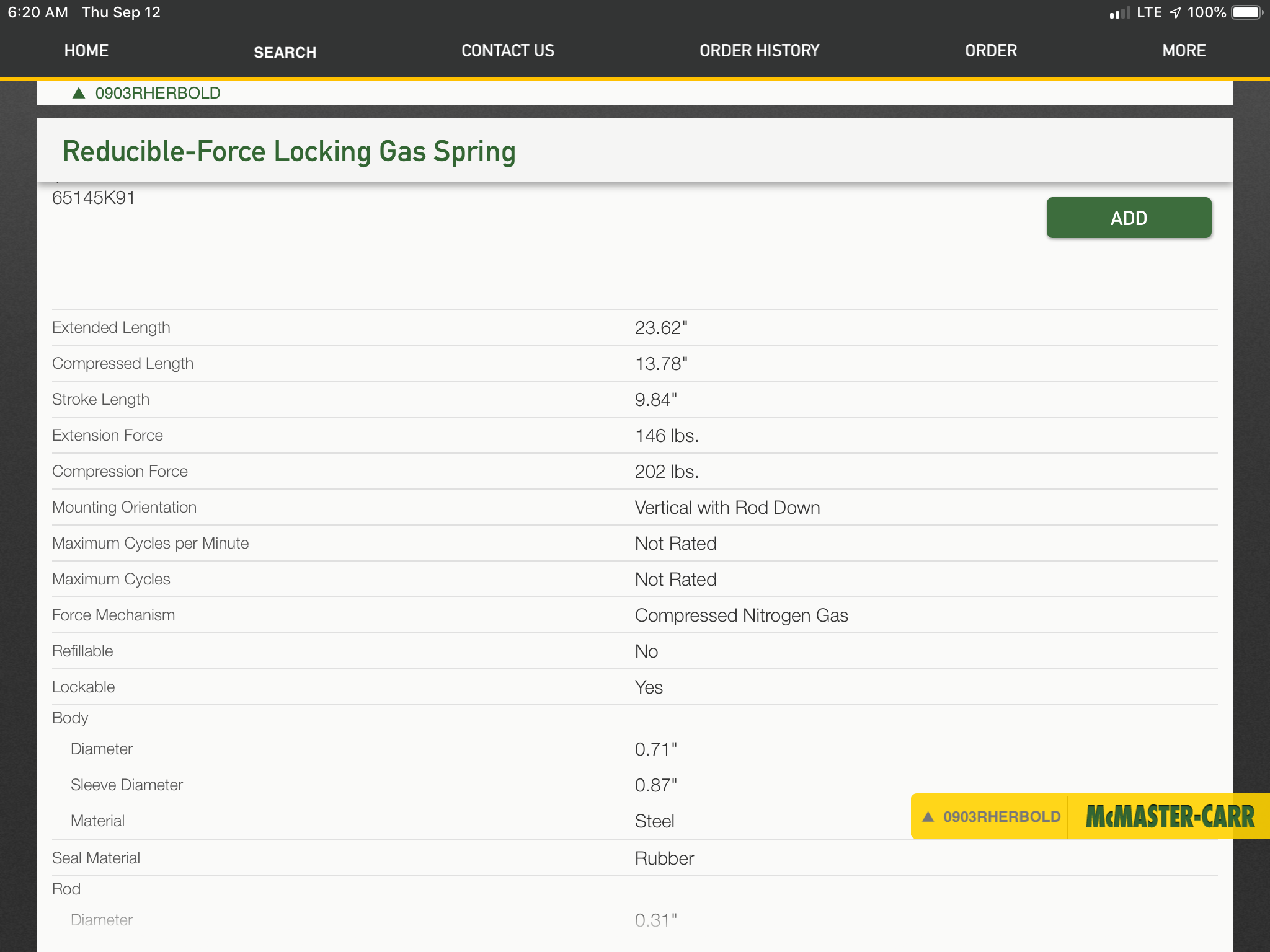

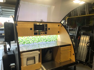

I finally found the correct poundage/length gas struts for the galley hatch. 5th set worked like a charm!

May I ask which size and lbs of gas shock you went with?

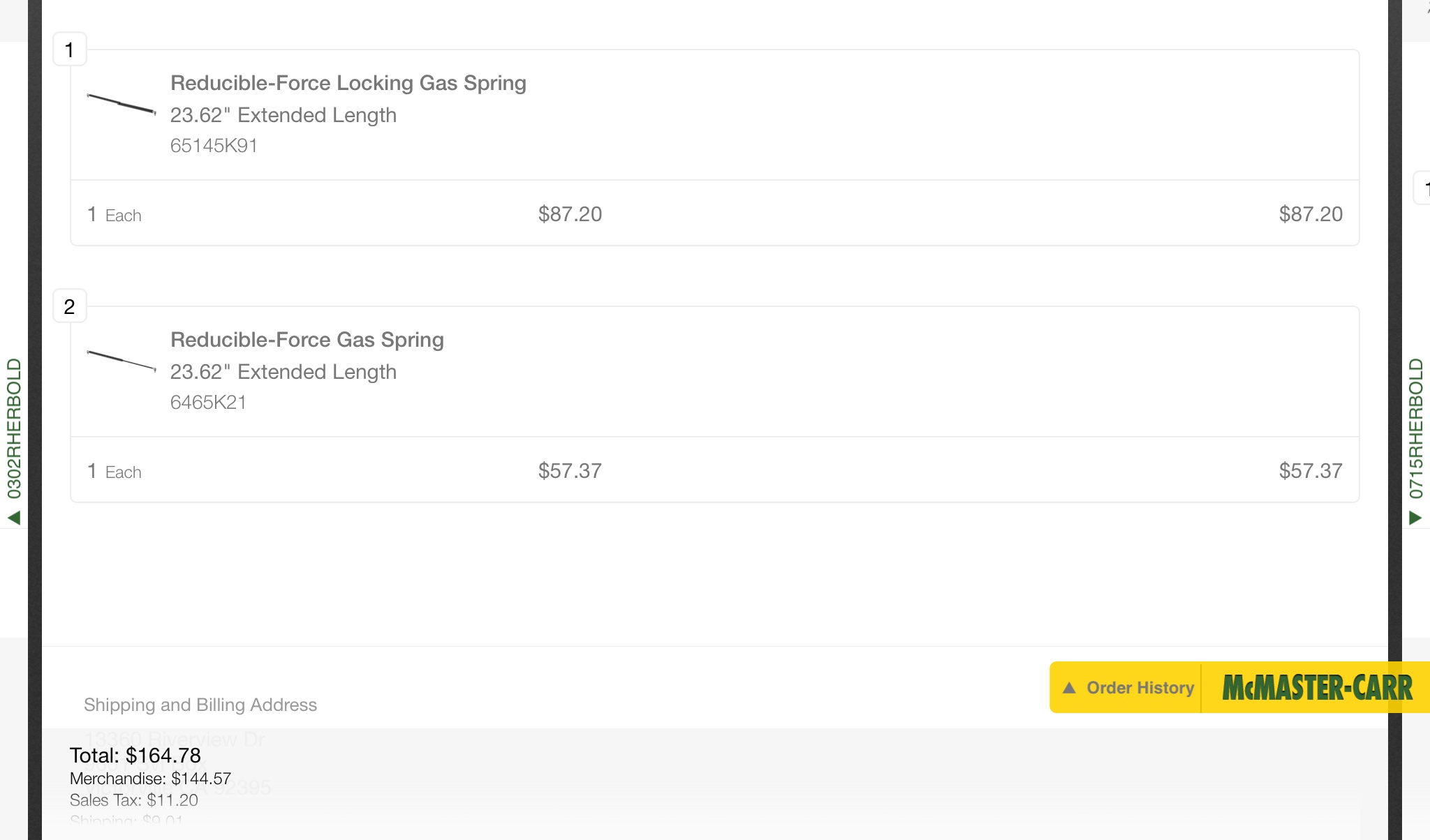

I ended up using one regular strut and one that locks in the extended position. The extension force is adjustable but I left them full force. 145lbs I believe. They hold it open fine and with the locking strut I will not have to worry about the hatch lowering in high winds. If you go with a locking strut, only install it on one side as you would need a third hand to unlock both struts and lower the hatch.

Thank You Ricky. I like the locking idea, I was not aware that was a choice.

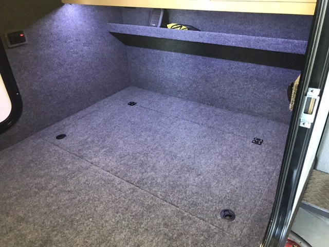

Postby ricky herbold » Fri Oct 11, 2019 2:28 pm

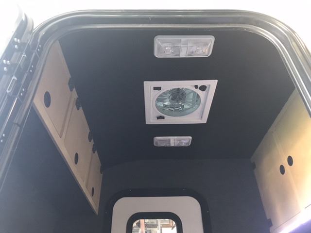

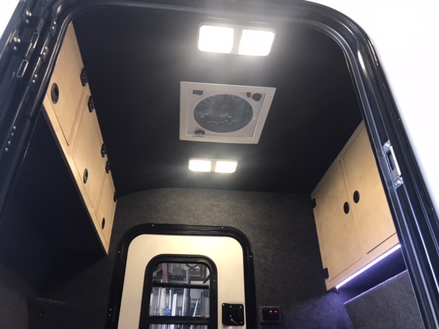

Well, I finally got around to carpeting the ceiling and mounting the last 2 lights and beauty ring for the fan.

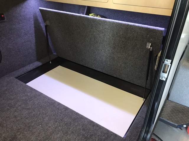

Postby ricky herbold » Sat Oct 12, 2019 2:50 pm
Here is my under floor storage. It is 48 1/4” x 24 1/4” x 5”. Not sure what I will use it for but a little extra storage never hurts.
