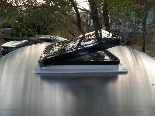

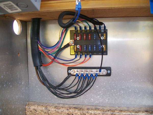

I worked on the TD Saturday and Sunday this past week-end. I was able to accomplish a bunch of tasks on it. I installed the Fantastic vent fan. I still need to silicone the edges and the screws.

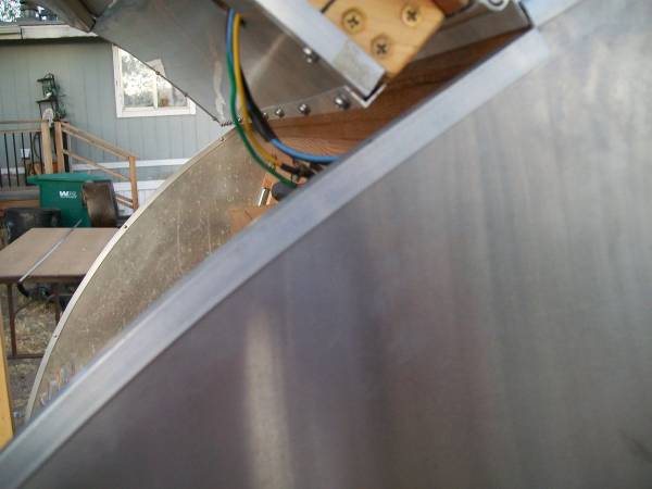

I got most of the 12 volt DC wiring done and all of the lights, radio and vent fan hooked up and working. I need to hook up the galley light and the water pump for the sink yet. The hole in the side wall is for the 120 volt AC to come in from the outside. I have to install the 120 volt AC wiring later.
I installed the galley wall edge trim with screws on inside the of the galley for a clean finished look. If you look across to the other side, you can see a few of the five screws on the inside of the trim.
The galley hatch is installed and the wooden support is only temporary. I will use some hatch supports to hold it open later.

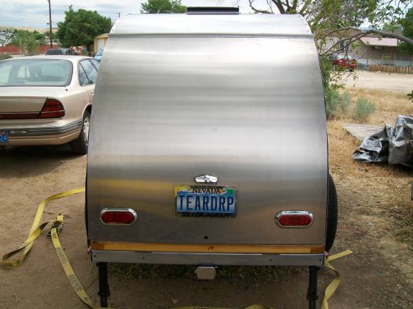

The tail/brake and license plate lights are all wired up and work nicely.
I started putting on the body lower trim around the edges. Here is what the front of the TD looks like. I still plan to add some aluminum diamond plate on the front to act as a debris deflector, But that will come later. I am just trying to get it camp-able for now.

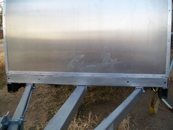

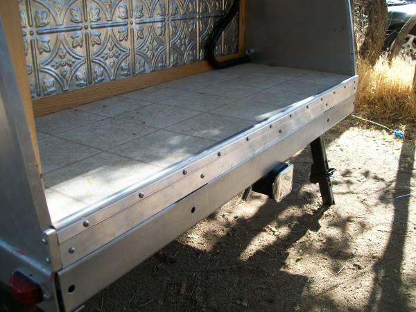

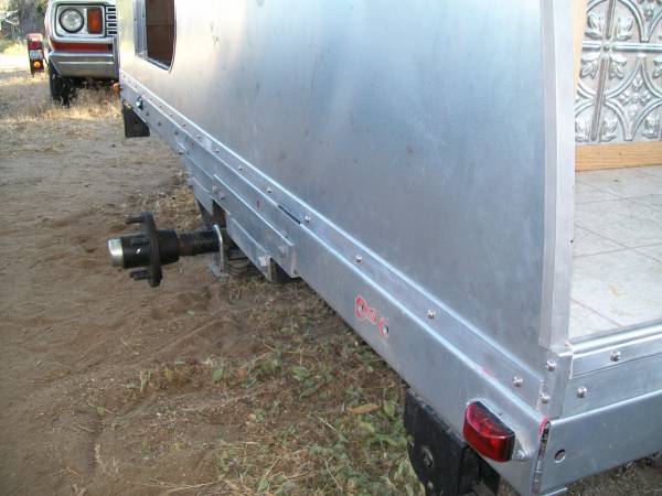

More accomplished today after work. I trimmed out the rear floor edge of the TD with some left over roof/side trim. I had and a piece of flat aluminum to cover the wood under the floor. The two pieces made it look just right. I also made up the end pieces that are on the outside corners of the galley by the side walls.
I trimmed the lower side edges with 1/8" by 1" flat stock. I need to touch up the silver paint on the frame as you can see.

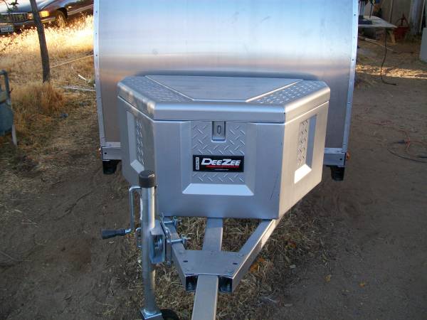

I placed the tongue box on the front to get an idea of how it will look when it is installed. That comes tomorrow.

Postby grizz » Wed Aug 03, 2011 5:02 pm
I really like the ready made tongue box.

Griz: It was easier to buy one already made up. It was black, but I painted it silver with Krylon plastic paint. It turned out OK. I need to put on one more coat to make it look right.
