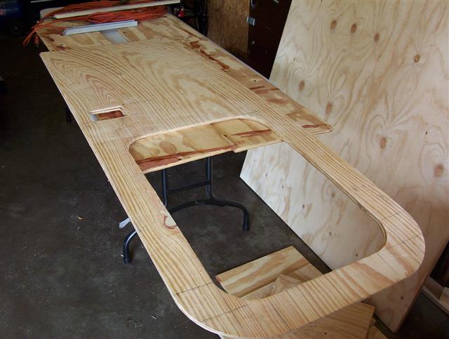

Postby WayneFromMo » Fri Sep 11, 2009 9:27 am
Doug
I robbed the Assembly off a wrecked RV. I couldn't use the door because it had a large dent and a hole that was drilled into it to hold the door shut.
I made that door that is seen in the picture from a sheet of 3/4 and 5/8. At first it was straight and when I mounted it to the frame. After it set out all night the first night, it bowed now it's hard to latch. So I'm going to build a framed door and replace the current door.
Thanks Doug. If you have any other questions please ask.

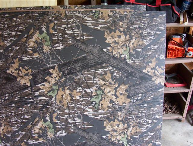

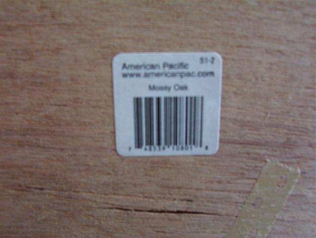

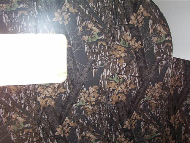

Postby WayneFromMo » Thu Sep 17, 2009 5:22 pm
Here is Some pictures of the Mossy Oak paneling that I purchased.
I bought it from a local lumber yard. You might check one in your area.

Postby WayneFromMo » Thu Sep 17, 2009 8:20 pm
I checked this stuff out before I bought it. I've been stuck with the glue and saw dust before.
This paneling is solid wood about 1/4 inch thick. Good stuff. :thumbsup:

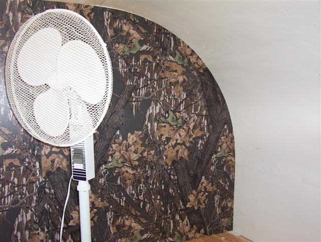

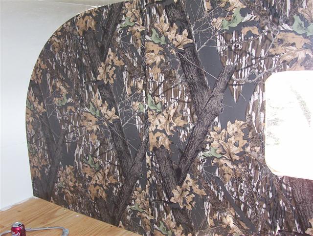

Postby WayneFromMo » Sun Sep 20, 2009 7:18 pm
I don't mean to tease, but I installed the
Mossy Oak paneling this weekend. I would take some pictures but the batteries were down and they need to recharge. I'll post some pictures later. But the paneling dose look good installed. :thumbsup:

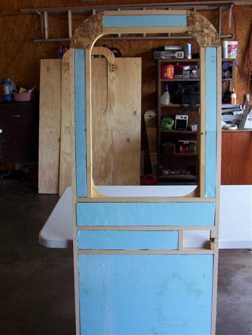

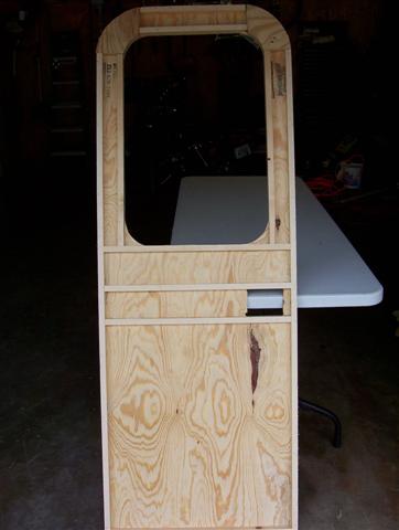

Postby WayneFromMo » Sat Sep 26, 2009 9:58 pm
Some one asked how I built my door, this is how.
Irip some one bys to the desired thickness of the door. (Minus the outer two layers).
I fastened the two outer layers together. I'm using 1/4" BC plywood. Layout the shape of the door and cut out. I used a skill saw, Jig saw, and router on this door.
I cut the one bys to fit. I fasten the one bys to one side with glue and brads. I used plywood in the corners and cut the radiuses.
Insulate the door, and attach the other side and that's it.
Doors are easy.

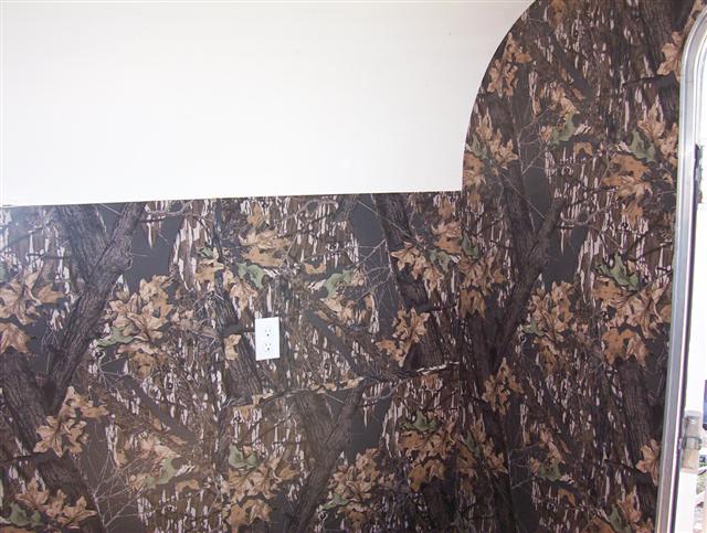

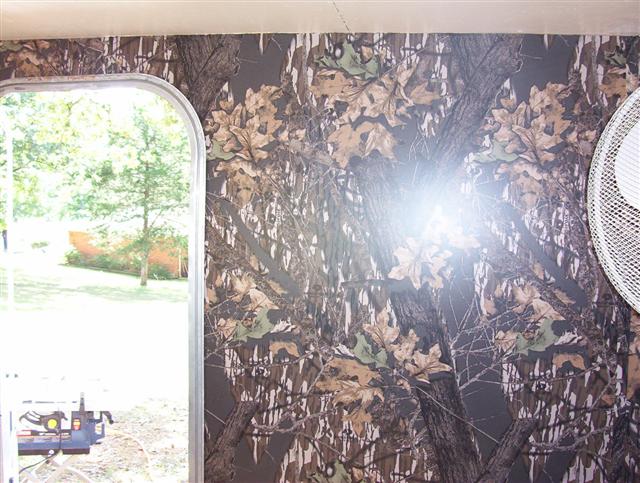

Postby WayneFromMo » Sat Sep 26, 2009 10:09 pm
OK here is the Mossy Oak up.
Roadside rear.
Roadside front.
Curbside front.
Curbside middle.
Curbside rear.
I like it. I know it's not fine woodworking, but I still like it.
Wayne

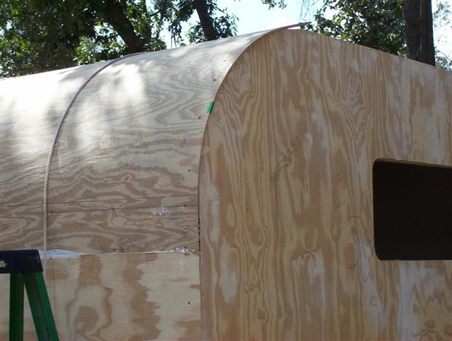

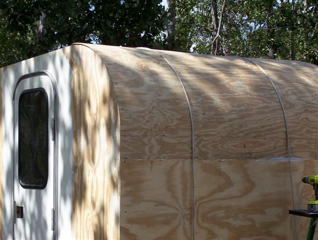

Postby WayneFromMo » Sat Sep 26, 2009 10:13 pm
I also started putting the outside skin on.
Bending the plywood over the 24" radius.
View from the other side. I'm also using liquid nail to help.
