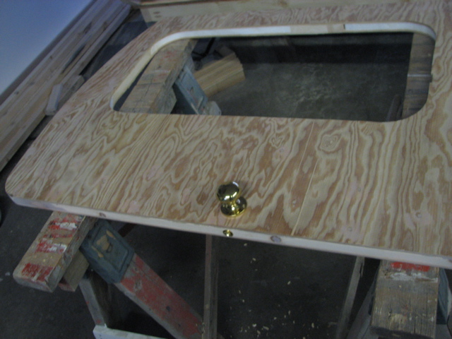

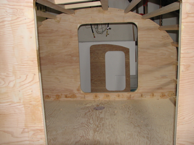

Postby sdave209 » Sat Feb 12, 2011 9:11 pm
This is my window.
and the fix
Fits real good now.

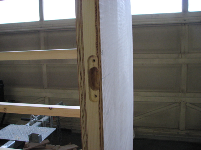

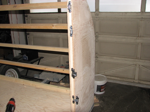

Did some door work today
Hinges:
There is nothing that I can build that I cannot unbuild. <or> Mistakes will be made, action will be taken.

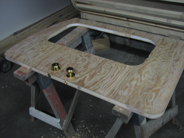

Postby sdave209 » Sat Feb 12, 2011 9:19 pm
Door knob
Dead bolt
Tomorrow Ill put the hinges in the door and then take all the hardware out and get ready for fiberglass. Im running out of stuff to do that does not require money, not sure what to do next. Window shopping and ice fishing for a few weeks I guess.

Postby Cliffmeister2000 » Sun Feb 13, 2011 1:29 am
sdave209 wrote:Dead bolt
Never saw a deadbolt on a teardrop before! At least one that wasn't integrated into the door handle mechanism. That should keep the riff raff out! :thumbsup:

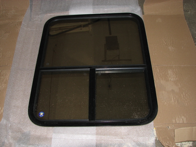

sdave209 wrote:Here is how I fixed my window problem, turns out it was my fault. Im kinda stunned sometimes, I cut my corners at 3-1/2" dia and my window has 3-1/2" rad corners. First of all I should not have cut out the wall until I got the window, and secondly I know the difference between rad and dia, I guess I was not paying attention.
I did the same thing myself with my doors, ounld'nt wait until thay came in and PRESTO!!! toooo big.

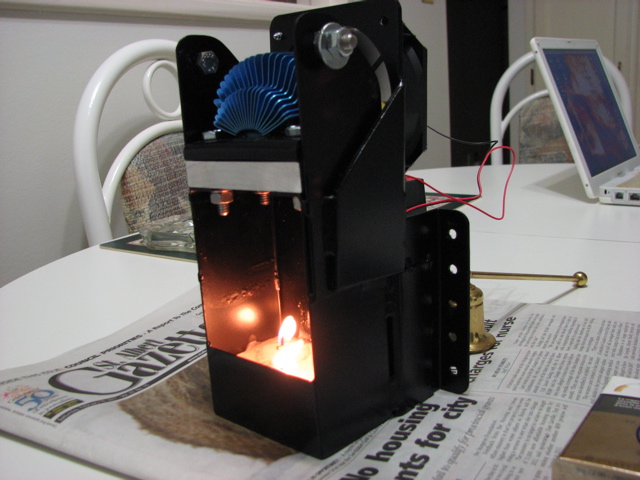

Postby sdave209 » Sat Feb 19, 2011 8:21 pm

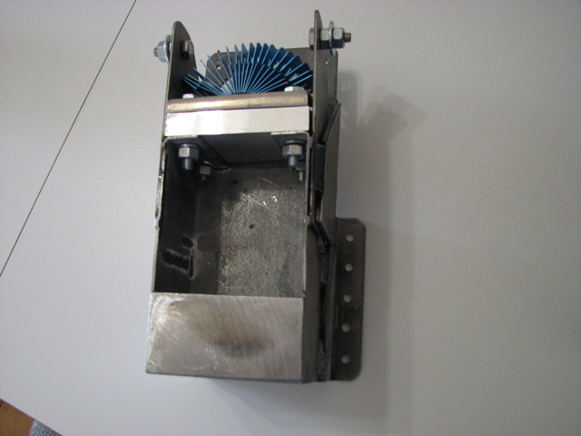

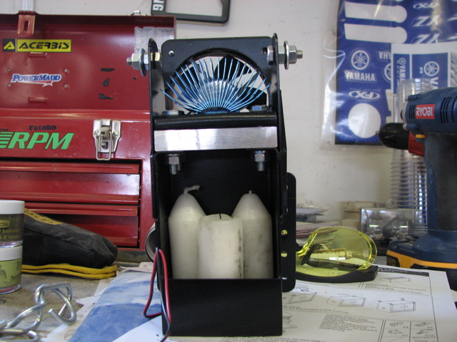

Here is the new and improved forced air candle furnace. It is about 1/3 the size of the original.

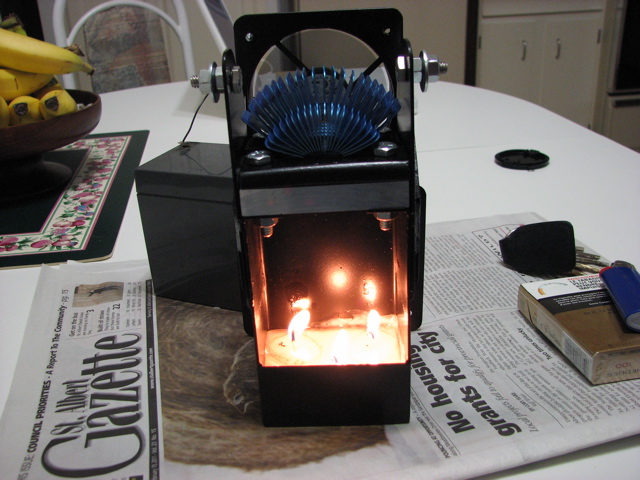

"9 hour" candles inside.
All lit up and throwing heat.

those furnaces do work in cooler climates but not so great when windy cause you still need to crack a window to keep oxygen in the trailer

Postby sdave209 » Sat Feb 19, 2011 8:42 pm
Ok, so here is the review:
Lite the 3 candles first, let them heat the top plate for a half hour or so.
Then turn on the fan and it will blow all that heat around the TD.
Does a good job, you can feel the heat coming off it quite well. The fan is very quiet, but does move air.
Now the problems; the candles are not dripless. The front candle can drip wax out side of the holder. I will be making a small tray to catch any stray wax. I seem to have discovered cowl induction; the fan blowing from the back swirls over the front edge and cuts down on the effectiveness of the candles. It makes the flames dance and swirl. Any Ideas on how to fix this? I have a feeling that if I put the grill on the front all the way to the top of the mini (my original plan) that the fan will blow the candles out, so I will only go as high as the 1/2" plate. But how will I fix the "cowl induction"?
