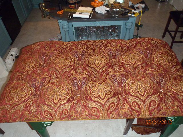

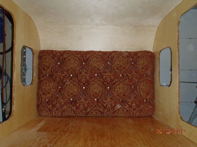

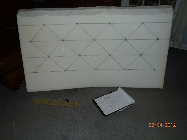

While waiting for the finish on the drawers to dry I decided to upholster the headboard. I found the instructions to do the diamond pleating here at tufted headboard instructions ( yeah interweb!!) . The fabric is a heavy duty upholstery material which should last for years.

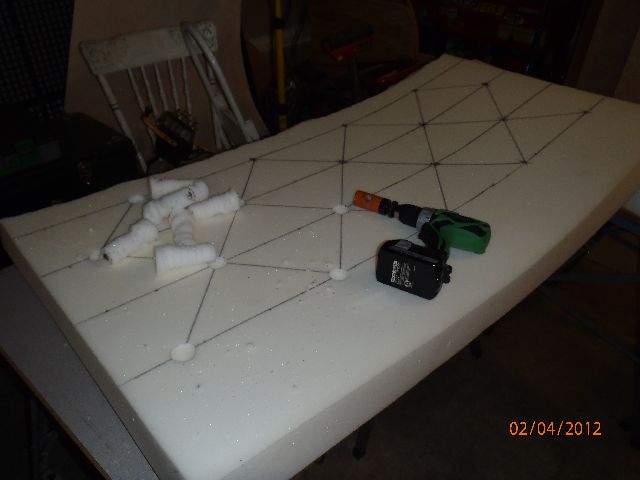

The layout for the buttons was dependent on the pattern, I measured the repeat of the pattern and added 2 inches to account for the depth of the button holes thus arriving at 12 inches between button holes. The pattern was layed out on the foam :
Then the button holes were cut out with a hole saw attached to a drill.

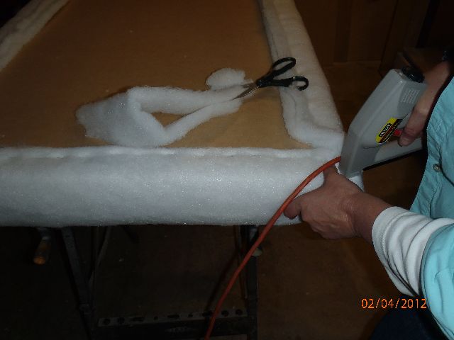

Then the foam was glued to the ½” lightweight MDF.
Then 2 layers of batting were placed over the foam and stapled in place.
Then the fabric was placed over the batting and the button’s attached twine threaded to the back and stapled in place.
Once all the buttons were attached, the fabric was stapled to the back.
And voila!
Here it is in place.
Image.
Should be comfy. And that is all for this little adventure. So back to the woodworking.

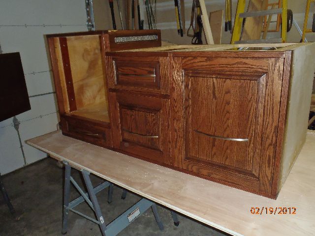

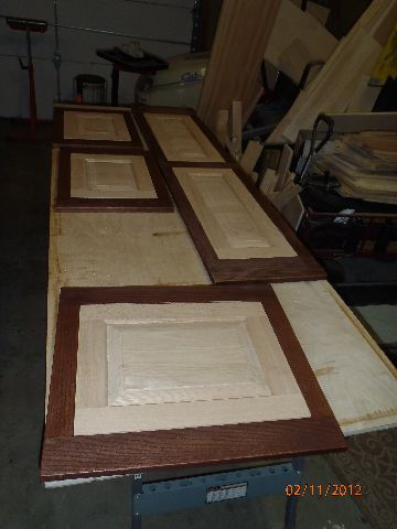

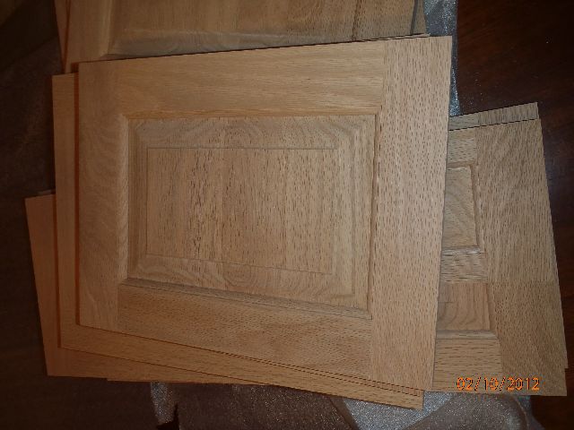

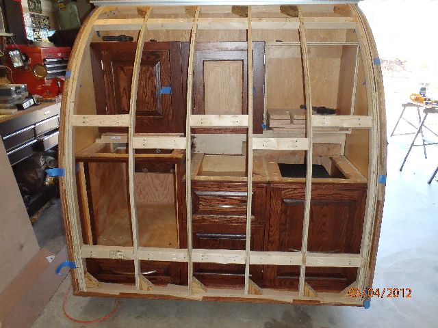

We received our shipment of Raised panel doors from http://www.rawdoors.net . We are very satisfied with our doors. They seem to be sturdy and well made. I was able to order them in the exact sizes that I needed down to a fraction of an inch and received them in less then 2 weeks.
The doors were fitted into the face frames.
Then a jig was used to inset the hinges into the face frames.

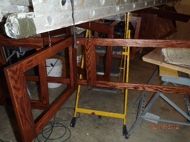

Then the doors and rest of the frames were first coated with a grain filler ,that was rubbed down and the next day 2 layers of Minwax red mahogany were applied.
Then all the face frames and doors were hung up and 2 coats of poyurethane were appled
Then 3 coats of epifanes rubbed effect varnish were applied. All very time consuming and smelly, but a necessity .
Uggh! Finishing cabinets is forthe birds.

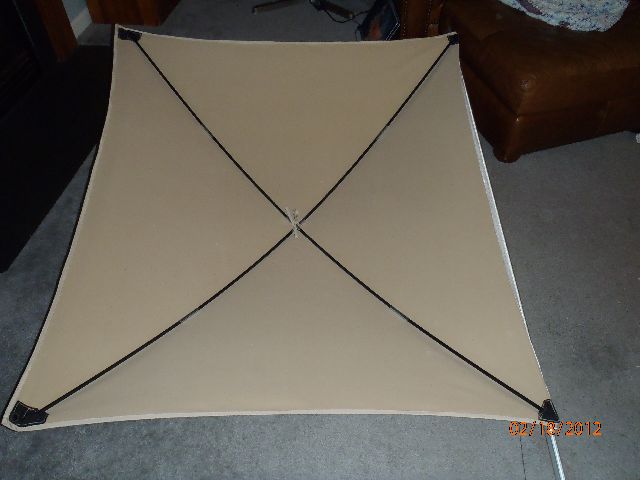

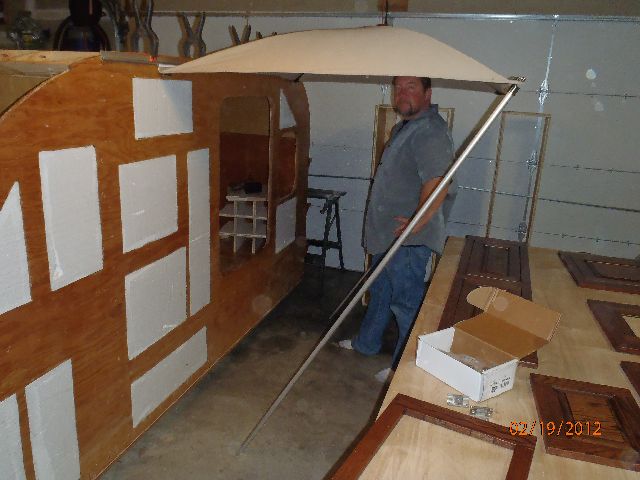

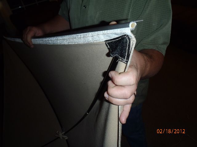

The next weekend I started the awnings. There will be one for each side. We wanted awnings that would be large enough to shelter the doors so we can sit on the mattress to put our shoes on. It was important to have them attach to the trailer rather than be staked to the ground for ease of set-up.
I was proud of my design, having spent many hours figuring it out. I thought it was pretty original until a few weeks later that I discovered a similar design on a VW camper site. Oh Well! :oops:
Anyway, here it is.
Here are the ingredients:
3 yards of Sunbrella fabric.
4 yards of fiberglass sew-on welting
Sunbrella heavy duty thread
Bias tape to match
4 packs of replacement fiberglass tent poles
½ yard of 2 inch nylon webbing
4 5/8 inch rubber grommets
Heavy duty black thread
¼ inch seaming tape (double sided tape.)
4 six foot aluminum poles
4 90 degree bimini ball joints
4 bimini deck hinges and matching outside eye fittings

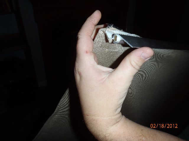

First I sewed a 3/8 inch hem around all 4 sides. I used the seaming tape to help keep everything neat.
Then I sewed then awning welt to one of the long sides.

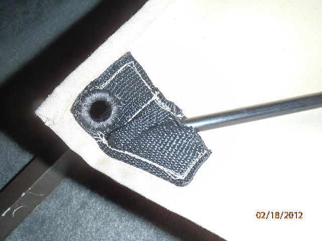

Then I sewed pockets out of the webbing. Simple ones for the near side and longer ones with an extension for the far side. Theses were sewn into the corners.
Then the rubber grommets were placed into the far corners through the webbing and canvas , then they were embroidered into place with the black thread until it was entirely covered.

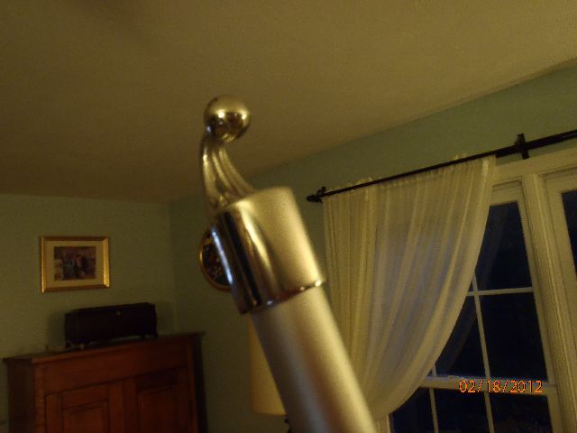

These grommets are where the tops of the poles that have a 90 degree ball and socket fitting will attach.

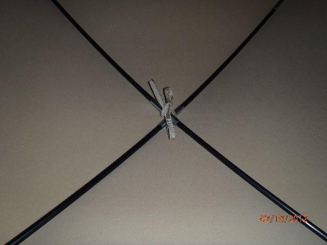

Then the fiberglass poles were cut to length and assembled and fitted into the pockets. Then the bias tape was used to make a tie to secure the poles in the middle.
The top fully assemble looks like this ( upside down)
The welt will pass it standard aluminum awning rail that will be attached to the trailer.
Here is a mock up of it on the trailer, the rail is just clamped to the side.
I have other Biminis fittings that attach the bottom of the pole to the trailer body, There will be a pin that can be slid out to easily remove the pole end.
I also will make the poles so they come apart into 2 pieces, so they fit into the storage areas.
I will take more pictures later in the build when I get to that point.
It’s getting late so I will have to post the other parts later this week.

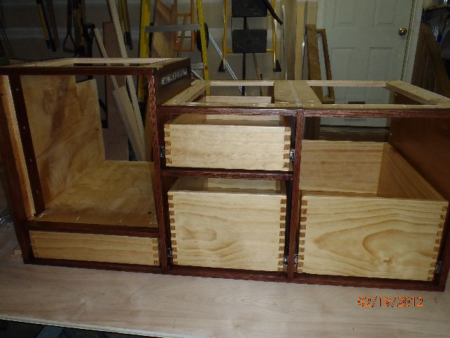

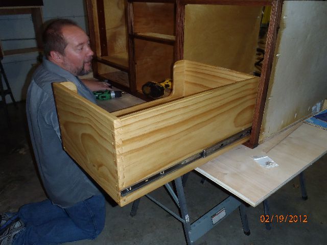

After working on the awnings my hubby and I spent the day installing the hardware on the drawers in the base cabinets of the galley.

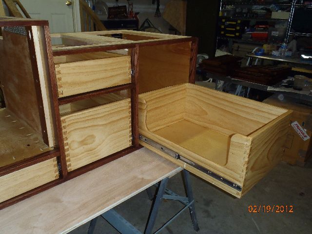

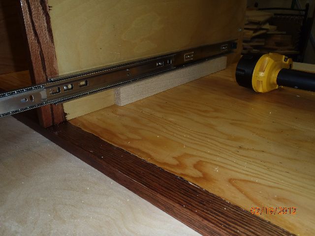

We started with the drawer slides . I followed the directions I found on you tube at :
http://www.youtube.com/watch?v=0E7SqMQSxGg&feature=related
The slides are all stainless steel. The oven drawer is able to hold 75lbs.
All the slide were installed, thankfully they all fit.
This isn’t the most flattering image of my hubby. He kept making weird faces while I was taking the pictures. :?
Oven drawer detail
Then we attached the drawer fronts, the hardware is also stainless. We chose as much corrosion resistant fittings as possible as we plan on doing beach time.
The empty space is where the refrigerator will fit.

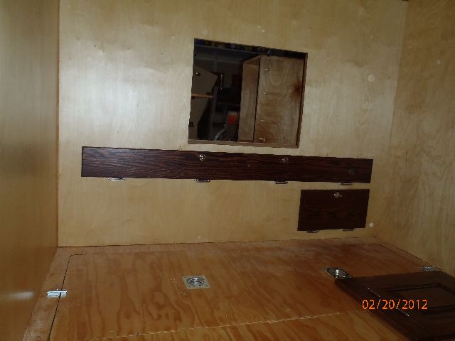

Then we attached the hinges and catches to the electrical and water access drawers.

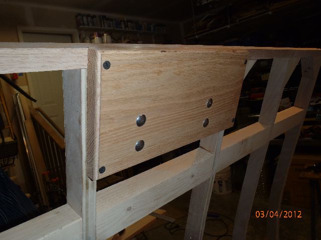

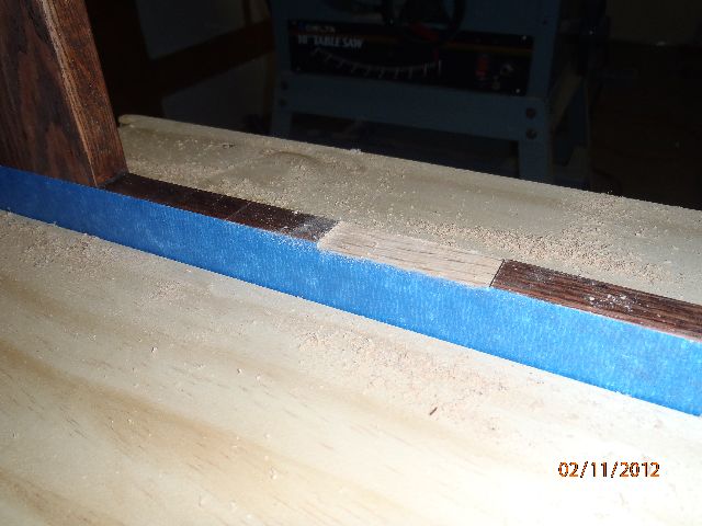

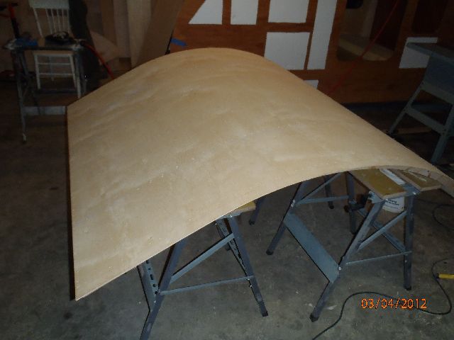

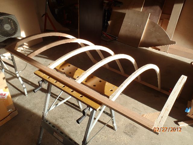

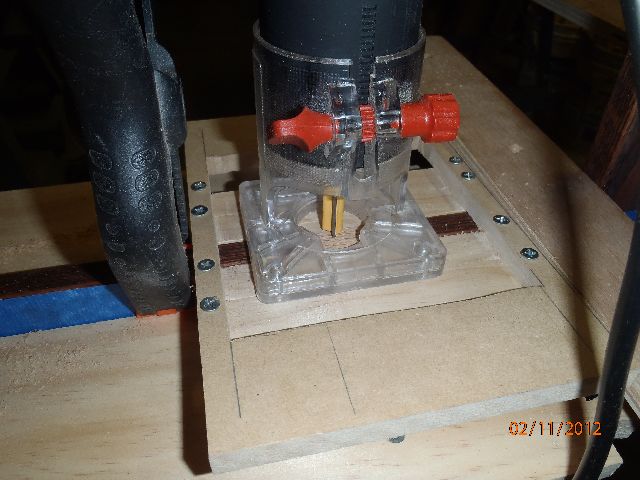

The next step was to work on the hatch. So I traced the shape of the hatch curve onto ¾ inch plywood added 1 ½ inch thickness and cut it out with the saber saw . Then I traced out 7 more. And my hubby rough cut them.
Then I routed them to match the master spar. My better half was absent for this part because he had to take my 16 year old son for driving lessons. I think he had the worse of the two jobs, using a tool that can shred the flesh off your bones is far less scary than driving with a teen.

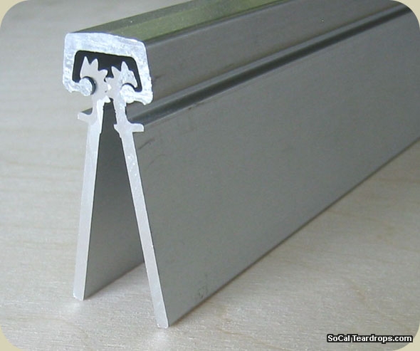

When he returned we cut the hinge to size. We are using the hinge available from So-cal .
Their directions were very good. We attached the hinge to the trailer side of the galley, so we could fit the cross pieces. Then we assembled the spars to the top and bottom with pocket joints reinforced with triangular blocks.
Detail of upper side. Showing double thickness of oak to we used to provide adequate strength to attach hinge.
That was as much as we were able to accomplish that weekend. This weekend we were back on hatch detail. We started by adding cross pieces to strengthen the spars and to provide places to attach edges of the outer skin. At this point I realized I could have just made the hatch 5 foot long and saved ourselves aggravation. Oh well… maybe next build.

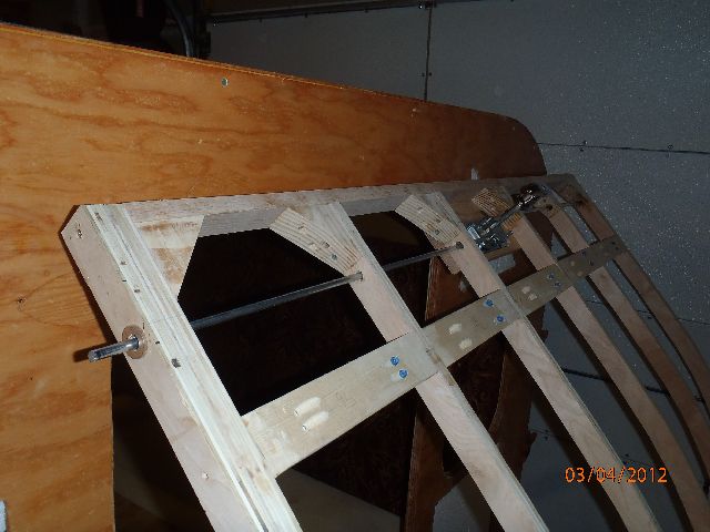

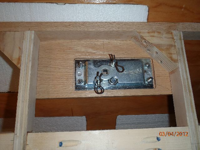

The next step was to sand the hatch skeleton smooth. Then we installed the hatch. We decided that we wanted the T-handled latch workings hidden in the hatch. However at 1/½ inches thick there wasn’t enough room to do that easily. So I cut apiece of oak to fit between the spars and routed out an area to inset the mechanism. The mechanism was bolted to this on the inside and then the whole thing was attached to the spars.
Inside view of latch panel. The drywall screws will be replaced with decorative screws when I remember to get them.
Then holes were drilled to allow the rods to pass. The rods were attached with cotter pins and then cut to length, flush to the sides when the mechanism was set to open.
After the latch was done, we noted the measurements for the location of the t-handle spindle that will need to be drilled later. Then we applied the first layer of Baltic birch . Applying liquid nails to the spars and then clamping and stapling it down.

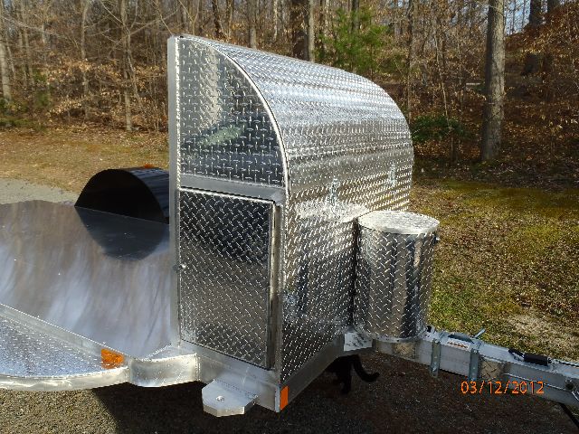

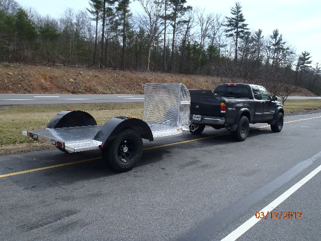

Well Captain Monkeyshines, the metal shop must have picked up on my vibes because they notified us that our trailer will be ready for pick-up this weekend :D And yes my husband is very lucky, because he won't have to hear me whining about this any longer. :R
They have also built the tongue box and the basement hatches.We'll see how closely they followed the plans:
We'll travel up to PA (7 hour drive) on Sunday and stay the night at my parents. They're planning on fixing something special for dinner...turtle. (Just what kind of wine goes with reptile?) :wine: Yum!!!
Then we'll pick up the trailer 'n stuff on Monday and drive back home.

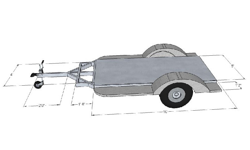

Next weekend we'll assemble the body onto the new frame and as long as everything goes according to plan,we will be back on schedule. What could possibly go wrong?
Should be smooooth sailin'.

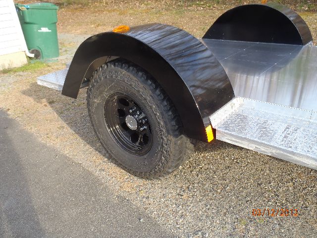

Postby Elizabeth C. » Mon Mar 12, 2012 8:49 pm
Well, we're back. Weather was good, the turtle was delicious, we now have the trailer in our possession. It wasn't completely done entirely as we asked, but at this point I think it is close enough. It looked like the custom shop got way in above their head. The owner said It was the first they had done and that he had 250 man hours in its construction ( I felt like I should have been wearing waders because the B.S. was getting pretty deep). All in all it is what I would consider 90% done, the hatches were 0% done ( what they had started was all wrong). I finally told him that I would forget about the hatches if he would give us a full sheet of diamond plate aluminum in exchange.He readily agreed to that, I think he just wanted us to leave.
I am just relieved to have anything at all, I was afraid they had run off with our money , tires,rims, and max coupler hitch ( which we had sent to them). Anyway my hubby has to iron out the suspension,some of the welds need to be ground down, the latches on the tongue box need changed, and we need to add attachment points for the body. Oh yeah I either need to find someone else to make the hatches or build them myself. :?
Here are some pictures:
