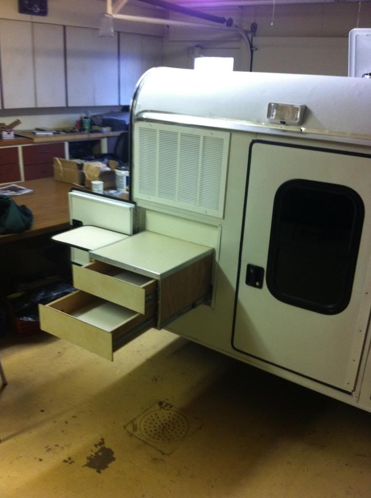

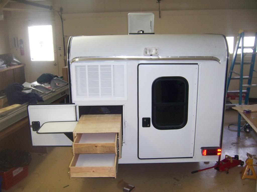

Beginning of the "Roll out Galley"
2 drawers will go into this cabinet.
With "mock up" of the side table leaf extended.
Hope to have this completed by Sunday.

Postby len19070 » Thu Mar 07, 2013 9:57 am
Morning photos of the unfinished Galley
The entire set up is almost 40" wide.

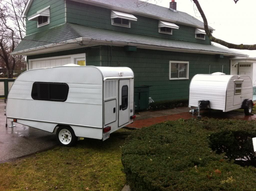

I couldn't have picked a more dismal day to pull it outside for the first time. Shown here with its other member of the "Fleet".
Its not 100% done yet but it is "Campable".
And that's where its going this weekend.
Happy Trails
