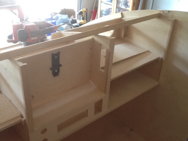

It took me several hours to figure out where I had left off my work. It was building the back/galley cabinets. You can see that there will be both AC and DC outlets onboard. The power will be coming from a PD-4000 Power Distribution center. AC will be available if hooked up to a 30amp (or less) power outlet. The PD4000 has an onboard battery charger and DC converter. Also there is a 12V DVD/TV and a radio/CD/Sirius radio going in on the back cabinets. The galley will also have AC and DC outlets along with 4"x6" speakers for use with the TV when tailgating at Texas A&M football games!

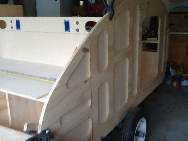

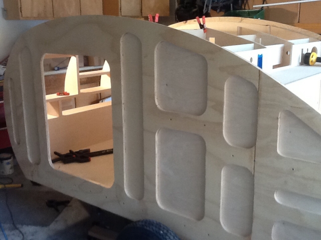

I was also able to get the inside skins on the sides. I used the same technique outlined by Ryan in Wyoming Woody build. It used a rough cut, glue, and trim with a flush trim laminate bit. You can see the results in the pictures below.

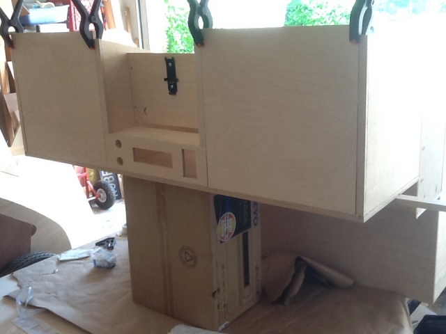

Postby WitsRUs » Tue Jul 01, 2014 5:12 pm

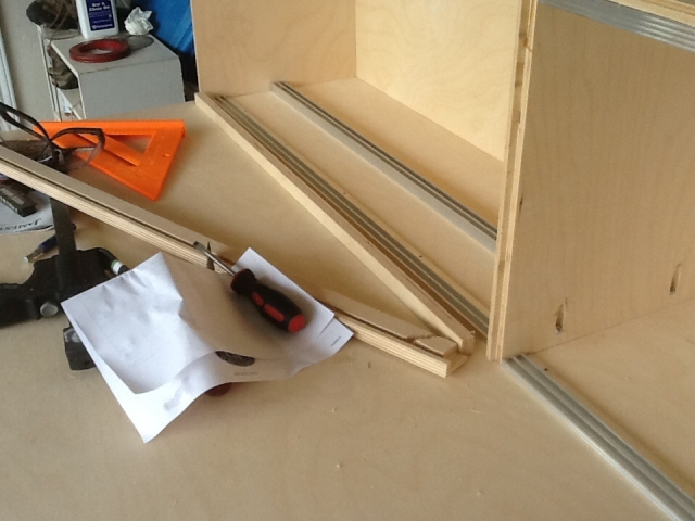

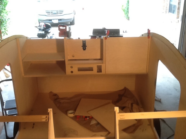

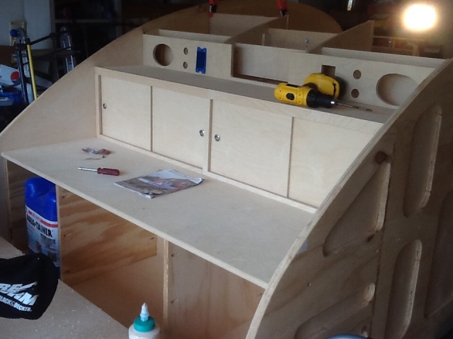

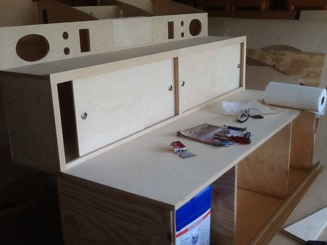

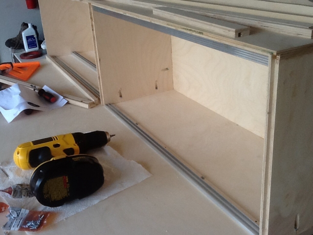

Here are some pictures of working on the cabinets and showing both sides clamped to the frame/base.

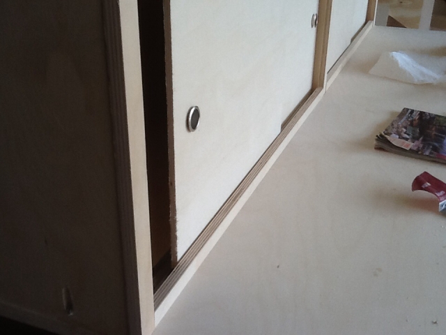

The next two pictures show the sliding door channel. I had a really hard time finding these items.I looked all over locally and online. I ended up finding them at McMaster-Carr. Note that the top piece is deeper than the bottom piece so hat the doors can be put in or taken out.
Here are the cabinets with the pulls partially installed.
Here is the back inside cabinet getting ready for dry fit of the side walls.

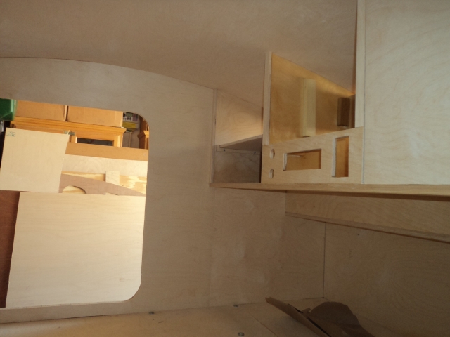

Pictures of the walls put up and clamped in place! I am pretty excited about how it is starting to come together! These pictures are taken though the side doors showing the interior cabinets.
Nest step is to adjust the placement of the cabinets, trimming any place that is needed, and making sure everything is square! Onward!

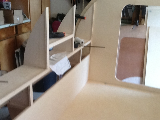

Postby WitsRUs » Sun Sep 14, 2014 9:19 pm

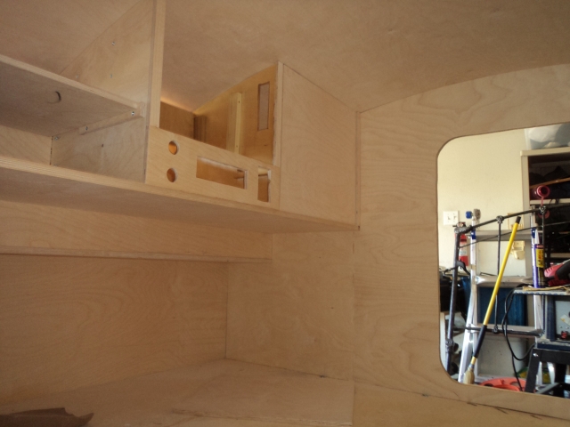

I spent a lot of time getting all of the cabinets placed square and then got the walls attached. I used PL Premium along with 2 1/2 inch screws to fasten the walls to the deck along with screws into the 3/4" plywood. I am really happy with how it went up so smooth! Ryan's detailed page for the Wyoming Woody are so easy to follow! Here are some pictures of the walls attached.
You can see the see the 2 1/2" screws into the deck as well as the locations of the screws I put into the 3/4" cabinet pieces. In addition to the screws I used PL Premium construction adhesive to attach the walls to the cabinets and decking.
Here is the galley area with the walls on.
Here is the headboard area attached to the walls.

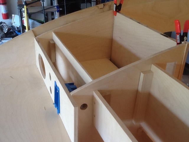

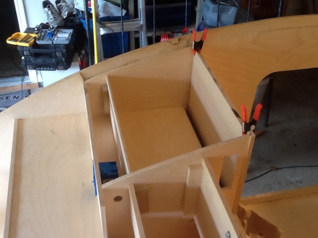

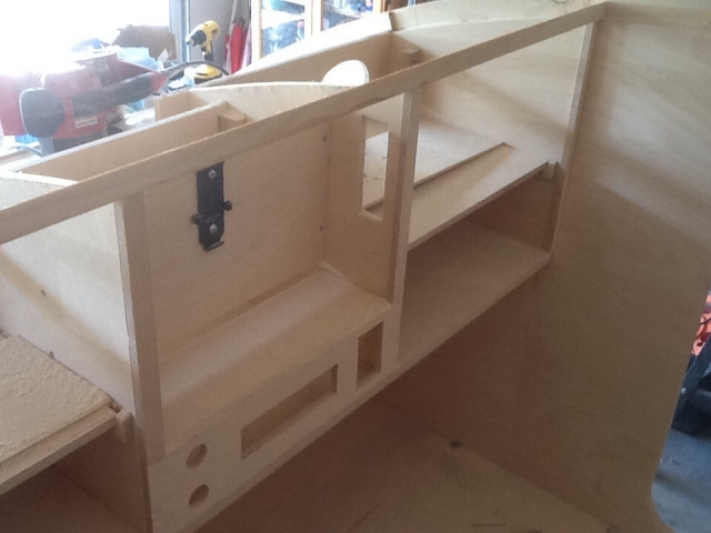

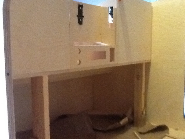

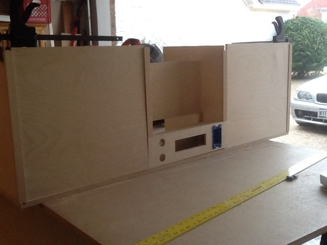

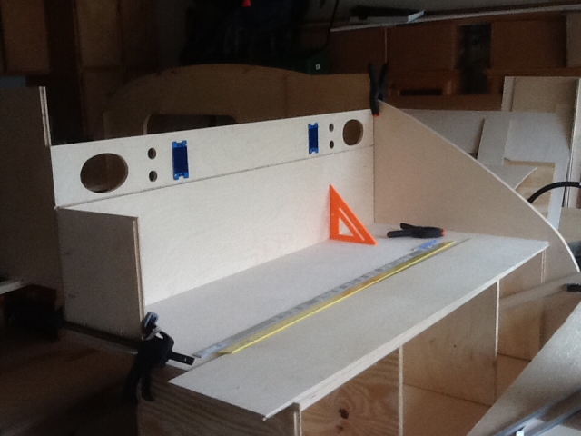

I needed to finish up a couple of details on the inside cabinets. I have two DC outlets, an AC outlet, and stereo speaker protruding into the far back of each cabinet from the galley. I did not want the wires for these exposed in the cabinet but I wanted to make sure I could access them for maintenance. I ended up putting in a removable shelf along with a false back in the upper compartment in each cabinet. This created an electrical chase for running my wires but allowed for easy access in case maintenance was needed.
Here are a couple of pictures showing the top view of the electrical chase.

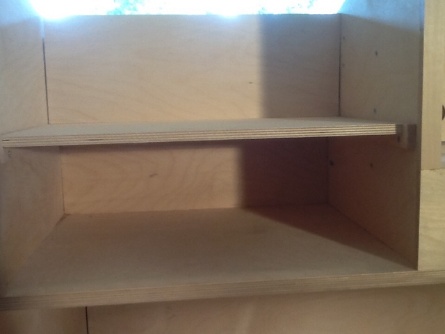

This a view of the cabinets with the left door removed showing the removable shelve and false back. The picture after that is a close up of the upper part of the cabinet with the false back.
The next thing will be to sand the tops of the cabinet dividers so that they will fit flush with the headliner and then install the headliner! Slowly but surely this is coming together!

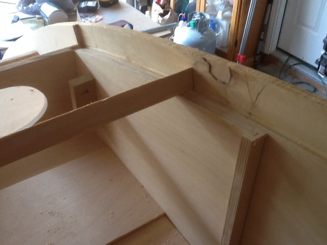

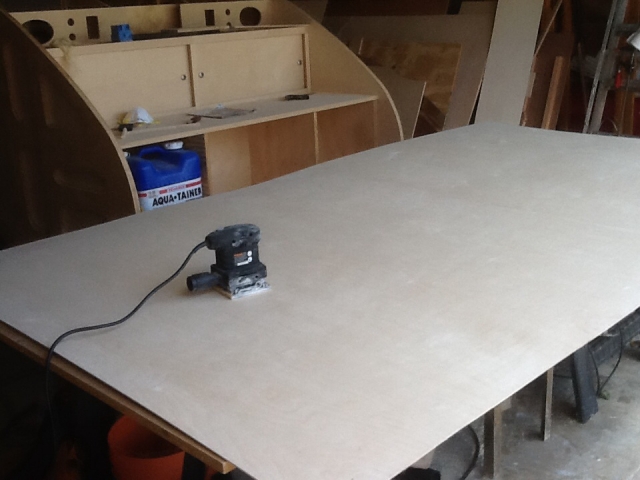

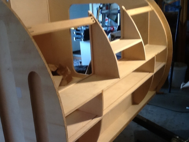

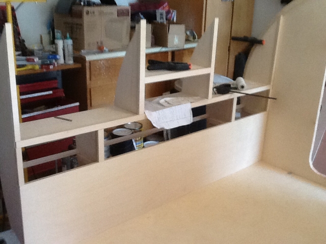

I started to get ready to dry fit the ceiling headline. I had to make sure the cabinet tops were all at the same height for a tight fit of the headliner to the cabinets. I used a belt sander and piece of straight wood to fix and verify the cabinet heights were the same all across the TD. Here is a pic of the cabinet edge sanded to the profile edge.
Here are a couple if pictures in the process of sanding the cabinet tops and checking with the straight piece of wood.

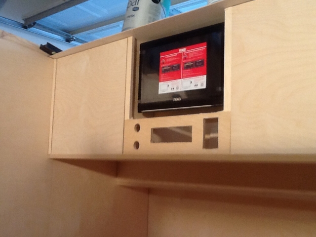

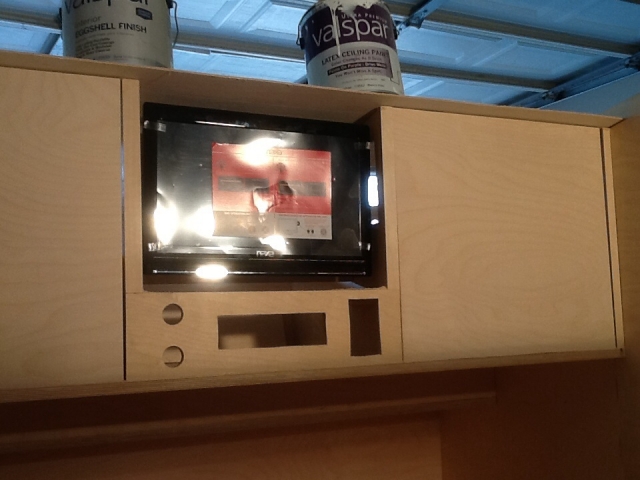

The next thing was to use a piece of scrap 1/8 inch plywood to see how it looked across the back cabinets. It fit really well and I am getting excited to get it enclosed! I also put the TV in the mount to see how the clearance with the headliner looked as well.
The next are to finish dry fitting the head liner. I also need to apply the spar polyurethane on the inside of the front cabinets and mount the doors prior to final placement of the head liner.

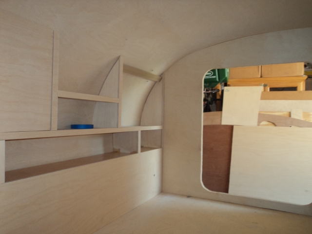

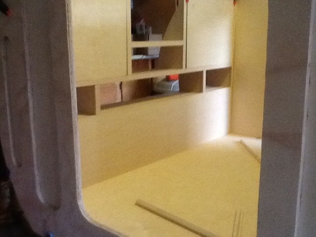

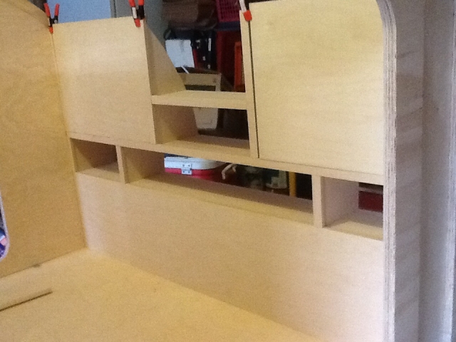

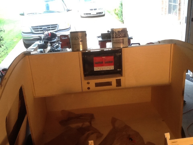

I worked this weekend on getting the headliner installed. Like Ryan did on the Wyoming Woody build, I also applied 3 coats of Helmsman spar urethane to the headboard storage area. This was because when the headliner is installed you can not easily access this area. For the same reason, I applied spar urethane to the TV cabinet as well. I sanded with 400 grit and tack clothed between coats. I was really happy with how clean and nice the Baltic birch looked with the coating!

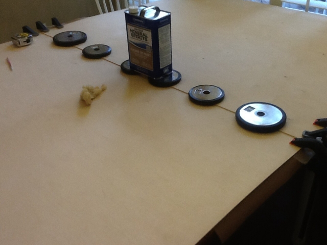

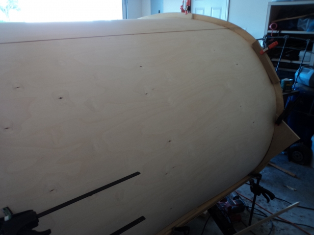

I then moved on to working on dry fitting the headliner. Once I had the pieces cut I then spliced them together on the backside with a 2" wide piece of 1/4" birch and Titebond III. Here is the splice drying (my wife is on a business trip so I commandeered the kitchen table :thumbsup: ). I located my splice a little further forward than Ryan did. I had a couple of small tanin steaks on the plywood that I wanted to end up inside the cabinets. Also my skylight is a 9" versus Ryan's of 12". Being narrower allows me to move the window forward to a slightly more curved area on the profile but right along the splice so it is visually minimized.
After the splice was set up for 24 hours I brought it outside for sanding. I started with 220 and ended with 400 grit. I sanded before installing it. I reasoned that sanding later would be more difficult along with dust falling on me! I am not sure if others do it this way or not. :thinking:
I then was able to dry fit the entire headliner using clamps to hold it in place. This was a little easier than I was anticipating but I am not complaining!
After getting in place on the outside I then was nervous about checking the inside! I was so excited with what I saw I just sat inside for about 10 minutes! It is so much fun to see it coming together albeit a bit slower than I want.
Here are four pictures two have the cabinet doors in place and two do not. Two are of the front headboard and two of the inside back cabinets. I think with brads and better pressure using come-along straps it should be very tight fitting!
Here is the headboard on the driver side with the cabinet door in place. You can see the splice about 10" from the cabinet face.
Here is the back driver side cabinet with the door in place.

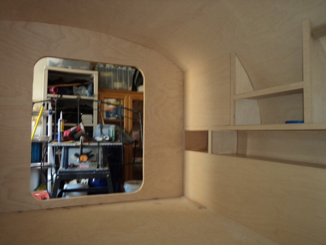

Here is the front passenger side cabinet without the cabinet door in place. You can see the two tanin spots on the plywood that I ended up placing them inside the cabinet so they would not be visible when the door was closed. You can also see the headliner splice about 10" in front of the cabinet face.
Here is the back passenger side cabinet without the door in place.
