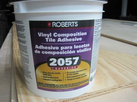

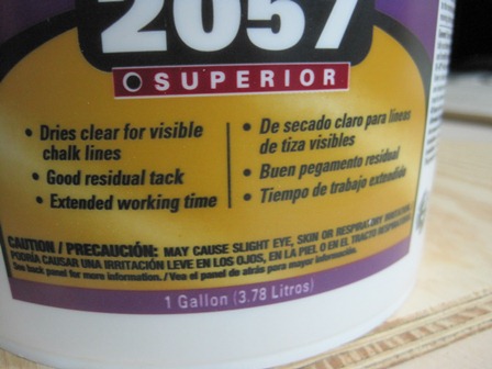

Anyone have any sugestions on a glue to use when glueing the aluminum bottom sheet to the floor...... I believe it was on the build of, "Father-Daughter Build 2013-14 by lfrazer98" That I saw to use Vinyl glue, Now I cant find it though, lol .....Below is what I found at Home Depot.... will this work? or any Ideas on What I should Use? Thanks.

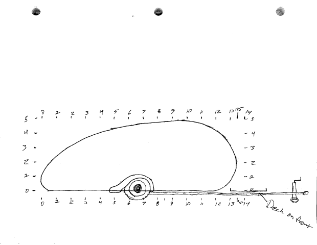

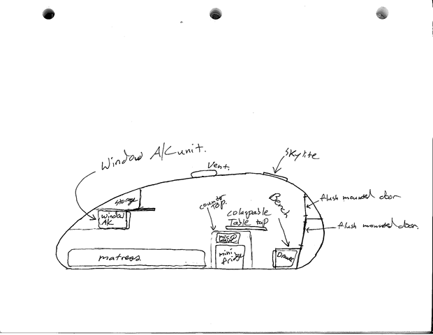

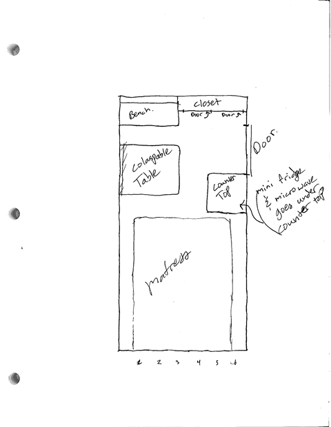

Also I said would list some design drawings.... below is a couple of sketchs. They may not make since to you, but they make perfect since to me Lol ;) Now theres not alot of detail listed, but whats not there is all in my head....and planned out perfect. lol, so I will just keep posting photos as it comes together.... (and the drawings are drawn out on graph paper with one square being 6"x6" to scale......Unfortunantly the scanner didnt pick the squares up....and im not computer savy enough to figur out how to make it.
We are not traditional campers, We wont be needing the gallery that most tear drops have, " No need for Sink or Stove top." So it will still have a Hatch inback, this will be to get a queen size mattess in and out, also I will probably try to make some sort, counter top there. By not having the traditional gallery in back, it will allow me to move the Mattress further back, and put the mini Fridge up front. This will also give room in between the Mattress and front of trailer for a sitting area, and for a collaspable table, the mini fridge and the microwave. (Floor plan photo below) Has anyone did a design like this and have photos? Or any Thoughts on it.
Also there is a side profile sketch of the outside profile, and of the interior layout....(again, not sure if this will make sense to any one but me.)
I will be using a window A/C unit, with cabinets on both sides of it. (And my neighbor is a sales rep for a company that manufactures and sales Wood Paint and also Wood Stains.....And he has his Side Business Shop Set up behind his house that they Refinsh cabinets in.........They are masters at it, so He can help me get a Beautiful stain on the Birch Floor, Walls, and Ceiling. :)
Floor Plan..tif
Interior Floor Plan
Floor Plan..tif (55.46 KiB) Viewed 1803 times

Side Profiler With Interior Layout
Profile plan..tif (66.43 KiB) Viewed 1803 times

Side Profile With Fenders and Frame
Profile.tif (55.79 KiB) Viewed 1803 times

Titebond III glue works great on bare wood. On epoxied wood, I used PL2000 construction glue.

I will try to pick of that glue up tonite. Also the photos that i have attached of the build arnt working,or loading??
