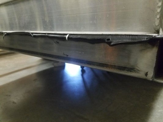

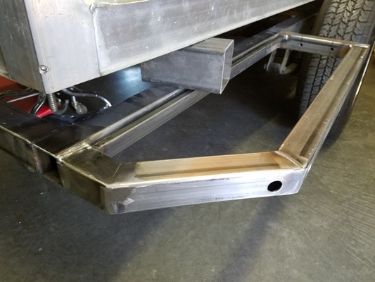

Last shot before I glue the frame to the pod .
Steel to Aluminum (2).jpg (90.09 KiB) Viewed 5461 times

Postby OP827 » Thu Sep 19, 2019 1:21 pm
That sealant seam looks appropriate to eliminate galvanic corrosion. I must say that your workmanship is first class! Are you a fabricator by profession?
OP827
Posts: 1595
Images: 414
Re: HandiCramper
Postby twisted lines » Thu Sep 19, 2019 5:42 pm
OP827 wrote:That sealant seam looks appropriate to eliminate galvanic corrosion. I must say that your workmanship is first class! Are you a fabricator by profession?
Thank You.
The corrosion was a large part of the plan, And it is a very good Assembly Adhesive to boot.

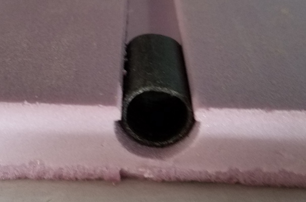

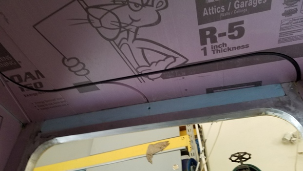

Postby twisted lines » Fri Sep 27, 2019 4:19 pm
Started on my second layer of 1" foam, cutting a chanel for the wiring between the bottom layer and the finnished 1/8" ply to run wiring because the first layer had tubing in the way.
Finding I almost need to get the fan installed it's already getting hot and stuffy, but I am a long ways away from that.
Second layer.jpg (54.6 KiB) Viewed 5179 times
Racking up; And Rapin foam

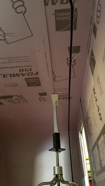

Postby twisted lines » Sun Nov 17, 2019 6:07 pm
Holding the 2" Insulation up; Good use for a teachers chair :lol:
The first curf that I snapped putting it up.
Tail light passage that I need to poke holes in
Adjustable Stand.jpg (76.29 KiB) Viewed 4912 times
Rear lights.jpg (75.45 KiB) Viewed 4912 times

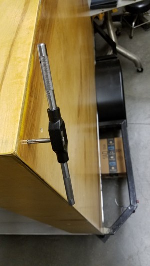

Postby twisted lines » Sat Dec 14, 2019 1:41 pm
The dilemma of a few holes for racks :?
twisted lines
Posts: 1243
Location: Jefferson
Re: HandiCramper
Postby OP827 » Sat Dec 14, 2019 4:05 pm
twisted lines wrote:The dilemma of a few holes for racks :?
If you are looking to build strong attachment points for a roof rack, maybe glue in some wood hard points in foam under the 1/8 plywood that you have and then epoxy in the threaded wood inserts like this:
https://www.amazon.ca/Z-Lok-Threaded-Hex-Flanged-Internal/dp/B002WC8TUW/ref=asc_df_B002WC8TUW/?tag=googleshopc0c-20&linkCode=df0&hvadid=292907900119&hvpos=1o1&hvnetw=g&hvrand=16967748812770145099&hvpone=&hvptwo=&hvqmt=&hvdev=c&hvdvcmdl=&hvlocint=&hvlocphy=1002392&hvtargid=pla-546946859687&psc=1
Several inserts for each each point should be able to distribute and take substantial load. Just a thought. The roof rack can be removable and plastic plugs can be inserted while the holes are not is use.
OP827
Posts: 1595
Images: 414
Re: HandiCramper
Postby twisted lines » Sat Dec 14, 2019 4:17 pm
Thanks for the link I will use the idea in two areas :thumbsup:
