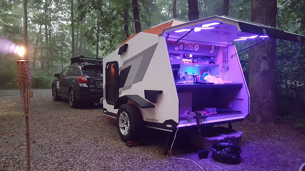

I ran it for 4 or 5 hours on Saturday and another few hours yesterday. Seems to work well. Fingers crossed!
Looks like my road trip to Indiana will be a good week to really test it!

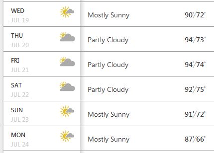

Postby absolutsnwbrdr » Tue Jul 25, 2017 12:46 pm
WOW!! Was it hot and steamy at Crossroads of America!! 95 degrees with about 90% humidity! The heat index was actually 104-107 Thursday, Friday, and Saturday. Then the rain hit on Saturday night, and Sunday morning. Thankfully we had the air conditioner!! It did seem to short cycle just a bit, so the humidity in the camper hovered around 60-70%, but the interior temperature was a nice 70 degrees. For an air-conditioner setup that can be easily removed, I'm calling it a success! 1,377 miles round trip!
And the X-Cubed was voted "Most Unique Design" :D
Air-conditioned camper = happy girlfriend :D

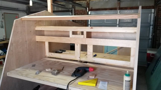

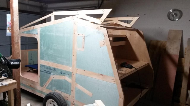

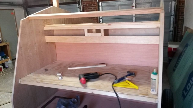

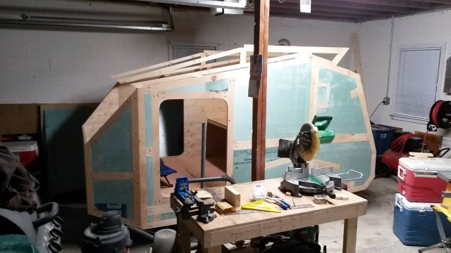

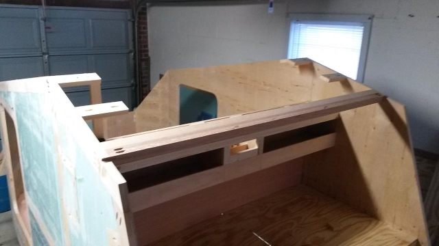

absolutsnwbrdr wrote:Got a lot done this weekend, including parting ways with the X-II. The new owners already have trips planned and I'm sure they're going to enjoy it!
Installed the shelf in the sleeping cabin, and worked on the upper galley....
Galley counter is starting to look like something...
And finally beginning the framing for the trolley top...
I have a long list of parts that need ordered, so tomorrow and Tuesday will be a bit of a shopping spree. :twisted:
So did you use mainly 2x3s or 1x3s for framing?

Postby absolutsnwbrdr » Mon Jan 29, 2018 9:30 am
sodatrain wrote:Just a quick THANK YOU :applause: for all the documentation and the detail on your window AC install with floor venting! I'm exploring a similar idea for my CTC! Any changes/updates to it since this last venting change?
The last modification seemed to work well. No more changes planned. :thumbsup:
Everything was pine 1x3 except for the spar where the hinge gets attached to. I used two oak 1x3's laminated together (ripped down to 2" wide) for extra strength.
