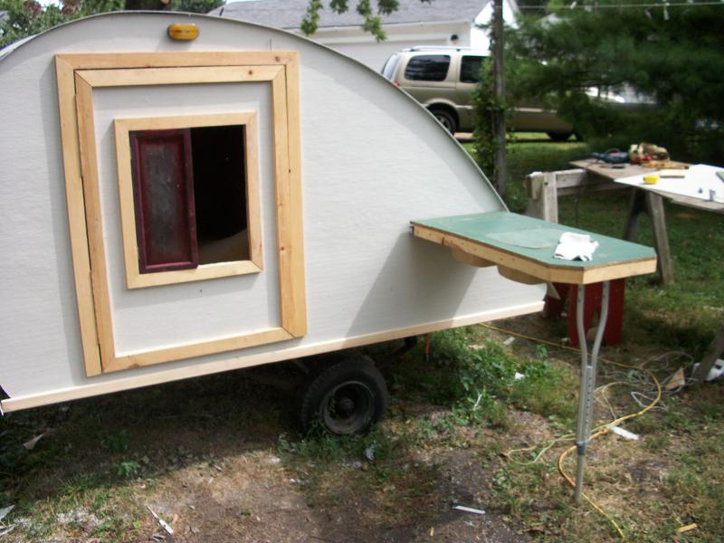

The leg on that side table is genius. Light weight and height adjustable. Never would have thought to use a crutch. Perfect.
Woodstramp
Posts: 438
Location: Aladambama
Postby bobhenry » Tue Sep 06, 2011 12:53 pm
Mounting was super simple . I cut just above the hand grip. I even reused the bolt that originally went thru the handle .

Postby kinto » Wed Sep 07, 2011 4:52 pm
Woodstramp wrote:Bob,
i agree. great idea! :applause:
I have to give credit where credit is due. I stole
this idea from Prohandyman (Dan) . He had used
a wooden one for his extend
out table on the lodge. The aluminum one ARE
a bit nicer as you simply push the buttons in and
adjust the height to level. No tools and
no disassembly as you have to do with the
old style wooden ones.
Postby Woodstramp » Thu Sep 08, 2011 2:14 pm
Well, Prohandyman is a genius. (just look at his work) Makes sense. You are still smart for using the idea. :)

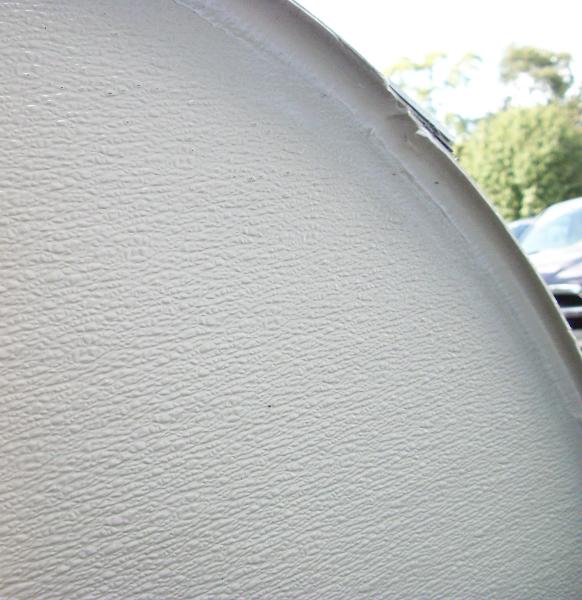

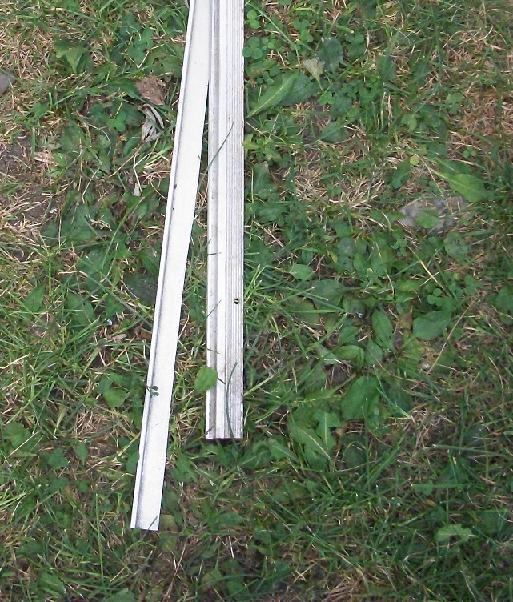

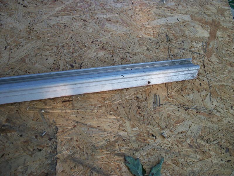

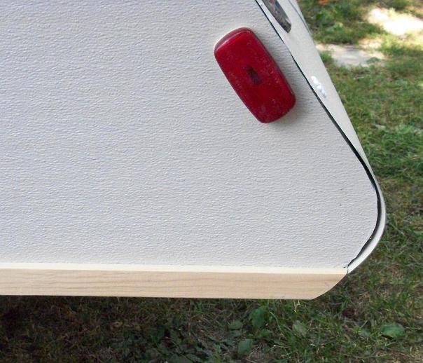

Sunday at 8AM I was out the door and using my new sanding disc to shape the bottom "L" shaped trim pieces to fit the front and rear curve. I removed the center strip that was simply screwed down and sealed the edges with 100% clear silicone and reinstalled the 28 rosettes and screws.

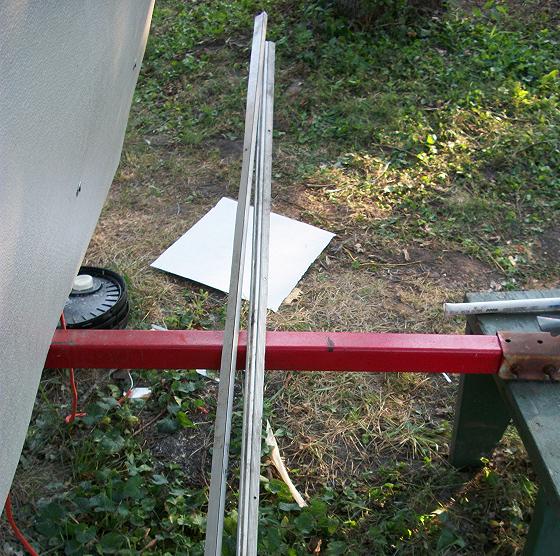

I had split an aluminum trim strip from a storm door and cut it to fit front and rear. I had to use the heat gun to get the frp to make the sharp curve in the rear. The aluminum strips were screwed into the floor halo trapping the frp under it.

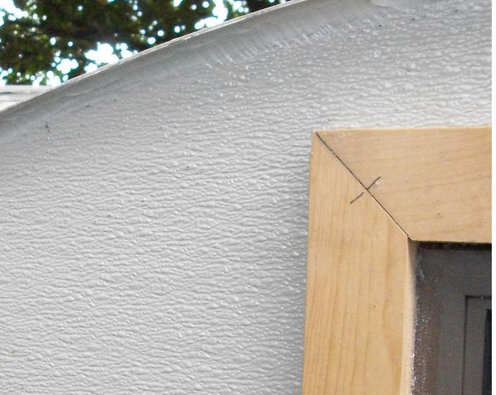

Postby bobhenry » Tue Sep 13, 2011 6:49 am
The picture update........
Why God made caulk
A piece of aluminum door trim
split down the middle
The waste left over
front trim installed

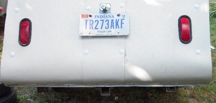

rear trim installed

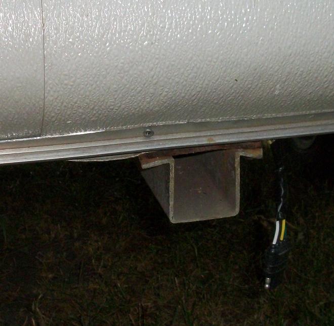

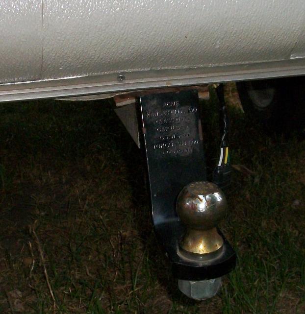

Looks like Rip Van Winkle will have a rear receiver to.

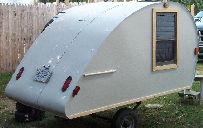

Passenger side is weather proof and done......
Need another tube of silicone and to get the casement window on the drivers side finished. A couple new tires and we are ready
