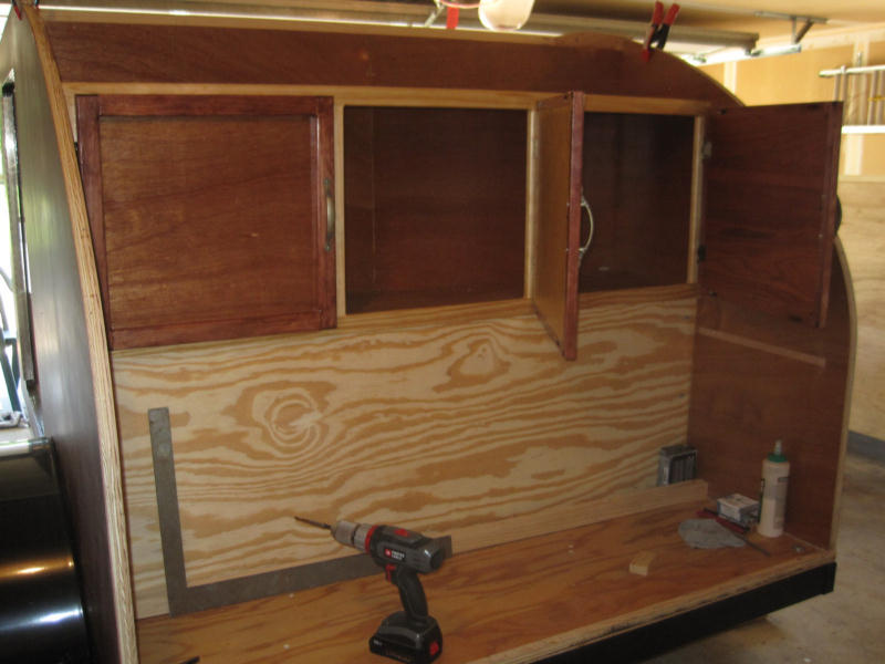

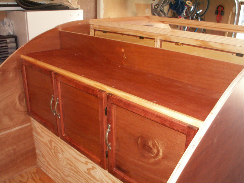

Pictures of the rear cabinets.
Nice view of the rear cabinets and the top shelf.
There are no dividers or shelves in the rear cabinets at this time. The "Boss" wants to try a few ideas first so we plan to add them later.

:thumbsup: It looks like those cabinets are very roomy, especially the ones in the galley. :thumbsup:

That's what the boss lady wanted so that's what I built. This baby has more trunk space than and old Cadillac. I still need to install the counter top and there is more room under there. I bet we can haul a lot of bodies, I mean stuff in there. 8)

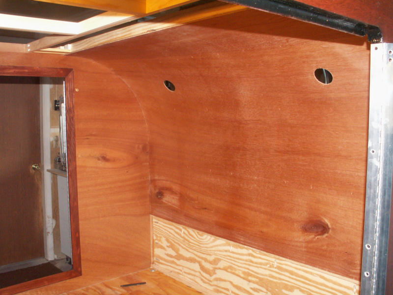

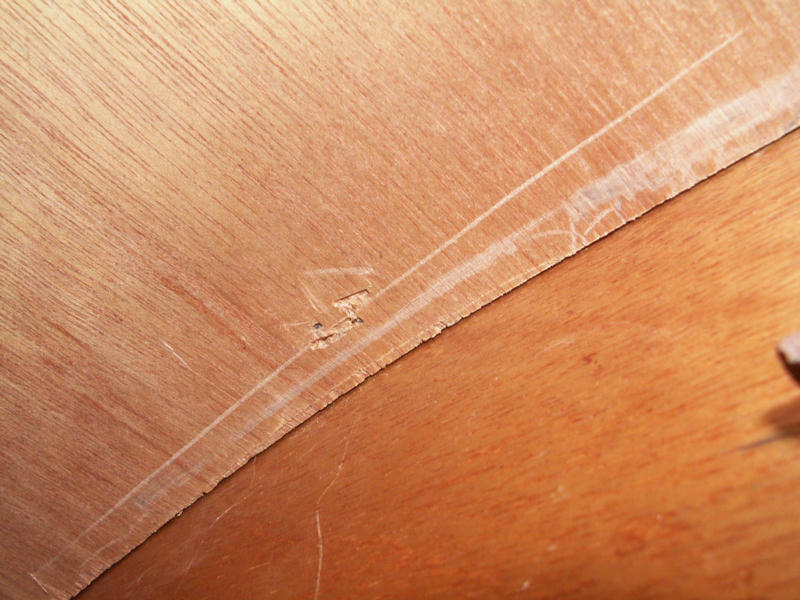

Way too much stuff cutting into my trailer building time lately, but a little more progress. All the roof framing around the fan and lights is done. The first piece of the headliner is in. That 1/8" luan doesn't bend around corners as easily as I'd hoped, at least not when you are doing it by yourself. Fortunately the other 2 pieces are fairly flat so they should be a little easier to install. The two holes are for reading lights.
The brad nailer is faster than using a hammer, but it comes at a price. It leaves marks by every brad. Hope to cover them with a little filler and varnish or maybe just leave them for that rustic look. :D Once the rest of the headliner is in I'll be using some 1/4" quarter round to fill in the gap along the wall.

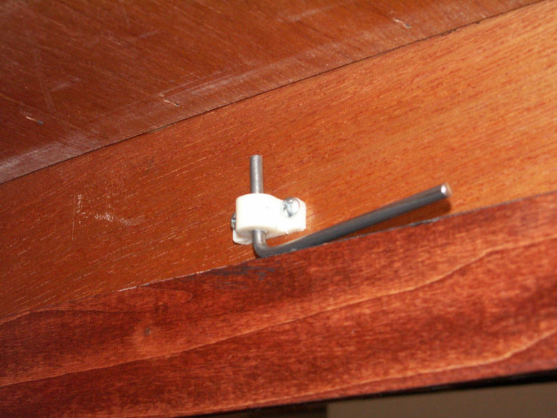

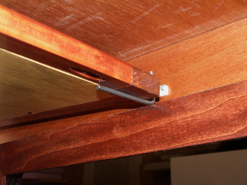

Things have been going slow but we were making some progress. We installed some simple door supports on the interior cabinet doors to aid in loading/unloading. They are just a piece of wire in part of an R/C airplane nose gear steering block. Simply open the door and swing the wire in place to hold it open.
