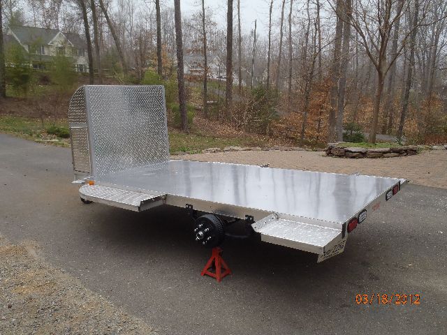

Yesterday on the way home from PA we stoped to eat lunch at a BBQ place outside of Philipsburg. (Gios- yum!!!!). I called Harbor Sales in Maryland and placed an order for the aluminum sheets for the roofing and sides. Today at 5:00 PM a truck delivered 5 sheets of aluminum to my workplace. How's that for service? :applause:
If anyone is interested their website is http://www.harborsales.net/
Anyways, just felt like sharing.

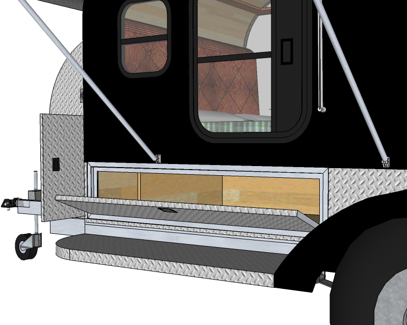

Hey Sharon, I've decided to build the hatch doors. The doors are for access to the basement storage.
I placed an order through Brunner enterprises for the aluminum trim I will need. I'm stil looking for paddle latches.
I hope my design will work, If it does I'll post it up.

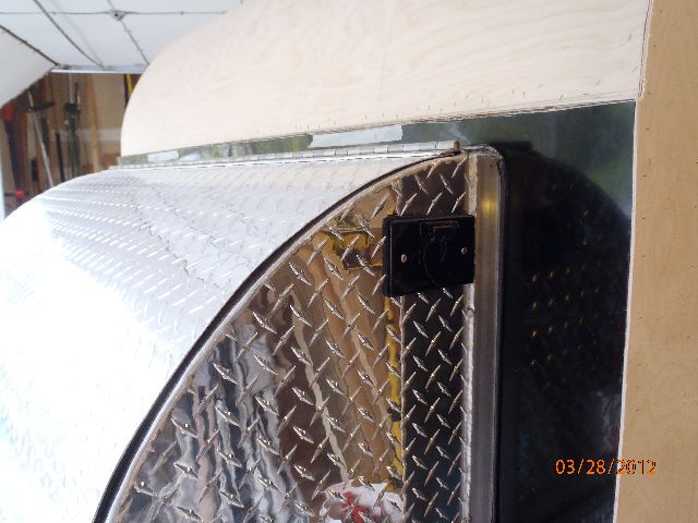

Hi Martin, I've been following your build thread. That is going to be an awesome trailer!

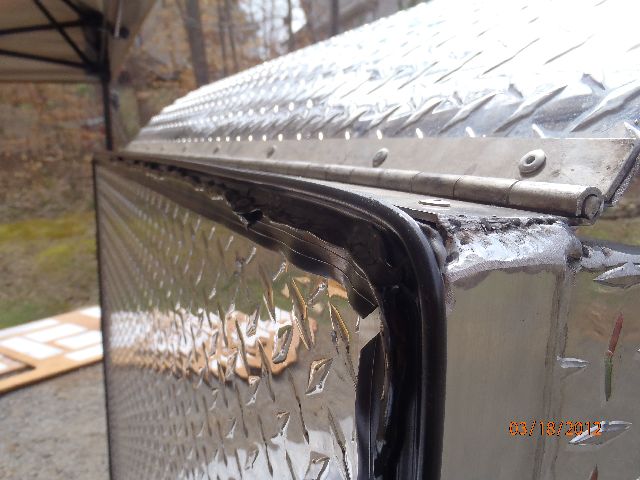

In answer to your questions:
1.Yes the gear runs the whole length. see pic:
The top rail can easily be slid off to separate the hinge. There are bushings (should be called stoppers??) that are supplied with it that go into the ends of the top rail to keep that from happening under normal use . It makes it convenient to put the hatch on and off for trimming and ( lots of) adjustments.
2.The trailer towed beautifully on the way home, nothing like a 300 mile shake down . We'll see how it does once the body is assembled on it.
3.(I know it was not really a question, but I like listing things) I tried not to be too hard on the trailer guy. I think he lost money on the deal once their work hours were figured into it. If anyone else orders something similar in the future I suspect their quote will be quite a bit higher. :eyebrows:

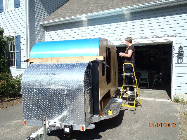

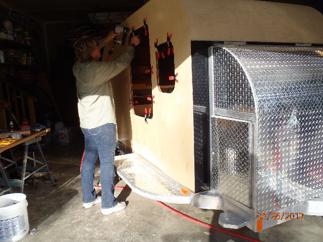

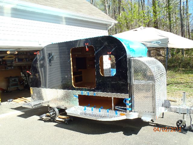

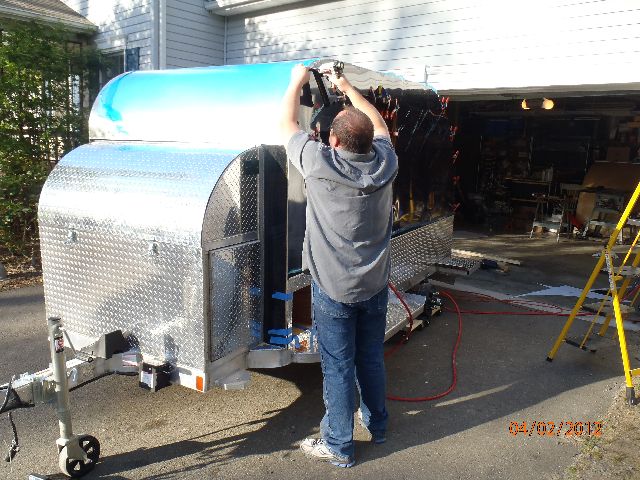

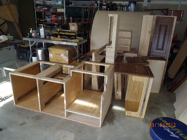

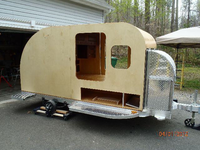

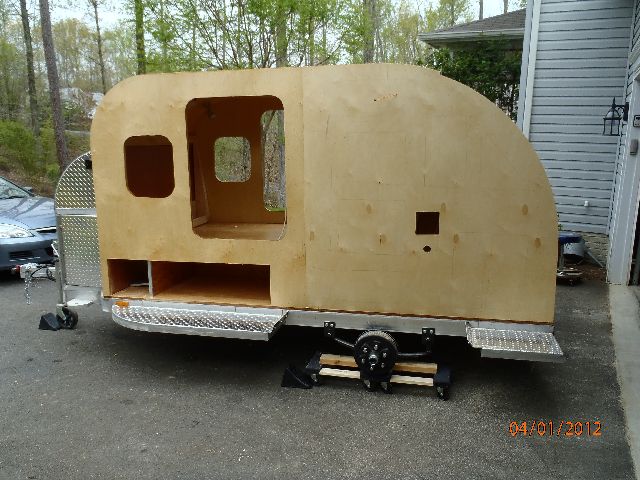

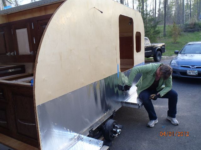

Anyway I have been neglecting my computer, so I am way behind on my build thread. We have been spending every free minute working on the trailer so there is much to catch up on.

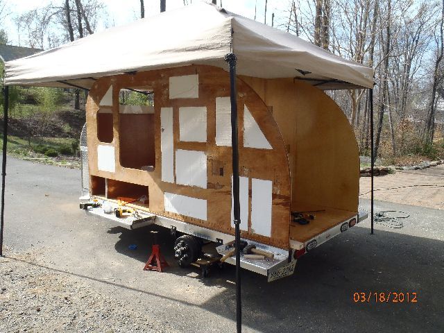

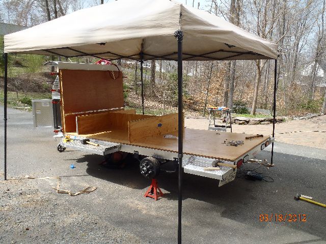

First we removed the wheels so the trailer would fit into the garage, and we removed the fenders so they wouldn’t be in the way. The tongue box is welded on so it created some interesting problems with assembling the front end.

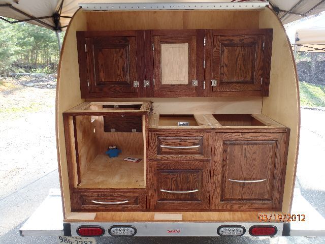

We dissembled the trailer into its parts and took it off the dollies
Cabinets in a pile.
Then we started reassembling on the trailer body. We placed the front wall with the aluminum skin in plce on it onto the tongue box. To seal between the aluminum and the tongue box , we applied butyl tape along the edges of the box, then VW fender welting on it, then black goo ( 4200 3m marine sealant). Stainless steel screws were used to attach it.
Layers of sealant.
We placed butyl tape all along the top of the chassis and laid down the floor. Then the basement walls were attached.
Then one side was attached, then the galley bulkhead then the other side.

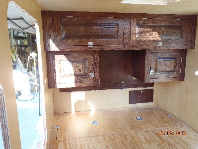

The we put the roof on. No pictures of that, sorry. Next we reattached the cabinets inside and out.

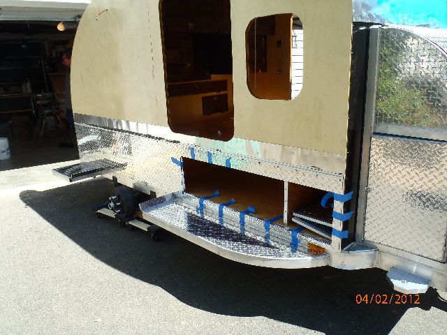

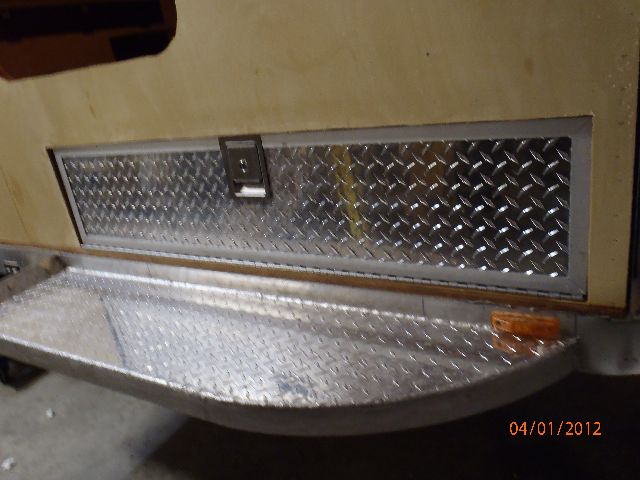

Then we put the hatch back on.
Yeah it fits!!

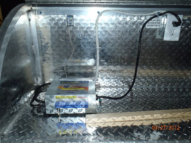

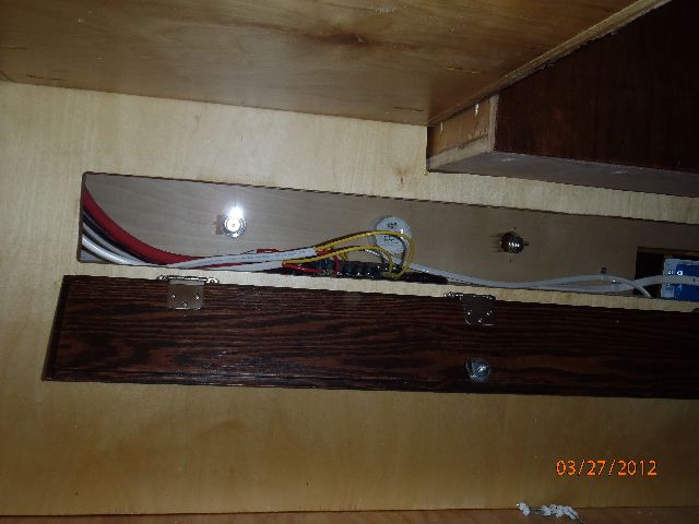

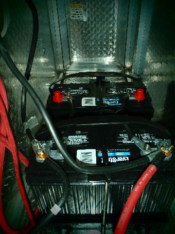

The next weekend my hubby worked on the electrical stuff.
Batteries in tongue box
Converter, Cool wizard logo. Oooh magic!
Poor photo of electrical chase.

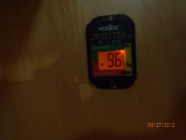

Worser photo of battery minder in cabin
15 amp all weather receptacle
He actually took a couple of days off work to get most of it done. When he was done (mostly) we insulated the roof.

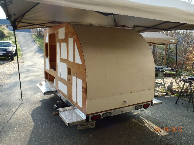

Then we covered the top in two layers of 1/8 inch Baltic birch , then the sides.
The next step was to coat all sides with West System Epoxy.

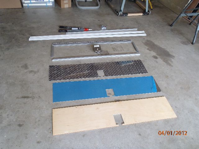

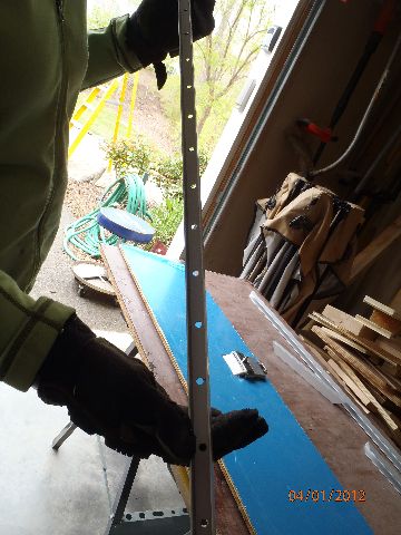

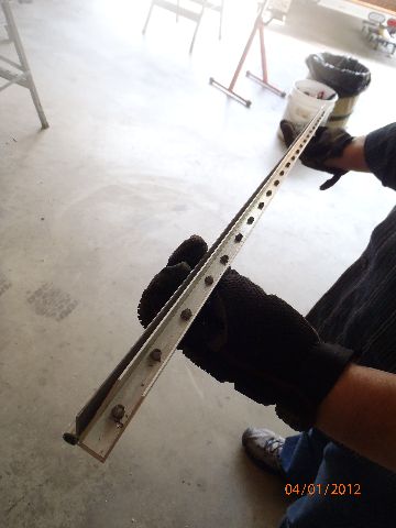

Here is how I did it:

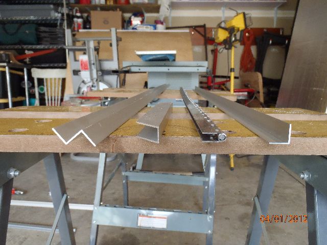

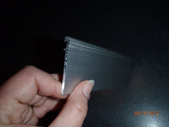

The plywood was made of ¼ inch plywood joined to 1/8 inch Baltic ply.
The paddle latch is from McMaster Carr.
The aluminum molding is from Brunner Enterprise
The mitered pieces were cut to be 1/8 inch longer then the dimensions of the wood.
The hinge is stainless steel, offset style to provide room for weather stripping.

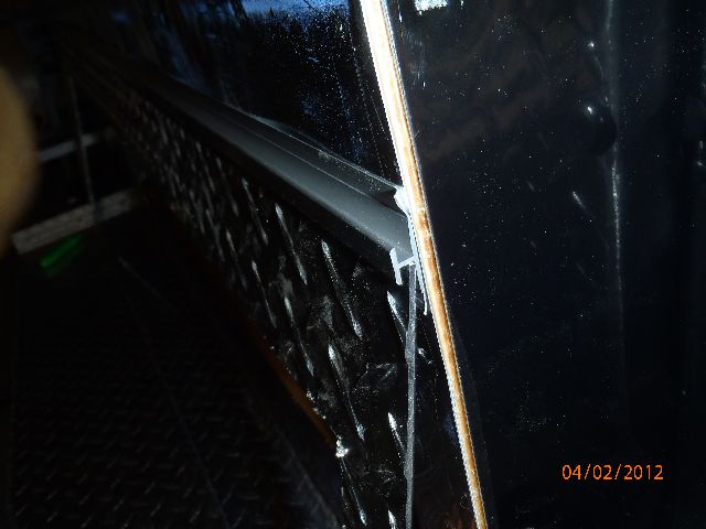

The Z channel will provide the frame and will be attached to the trailer body.
The c-channel is ½ inch wide with one inch long legs.
The angle molding will be attached to the trailer at the bottom of the frame.
(I’ll show that later when I install the doors)

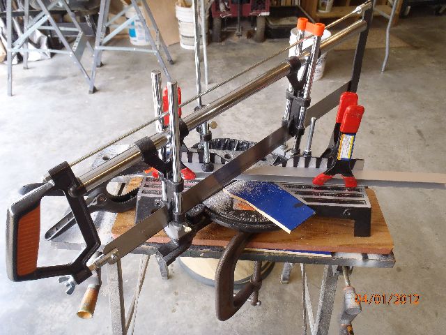

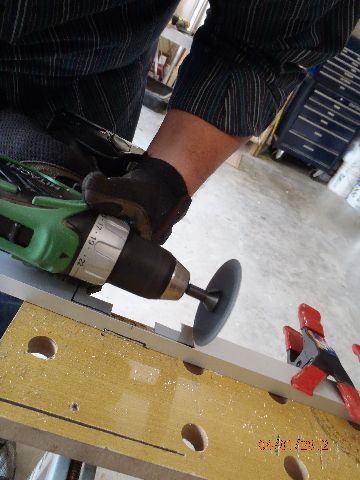

Miter saw used to cut molding, very precise. Purchased through McMaster Carr http://www.mcmaster.com/#handsaws/=gx9gq6

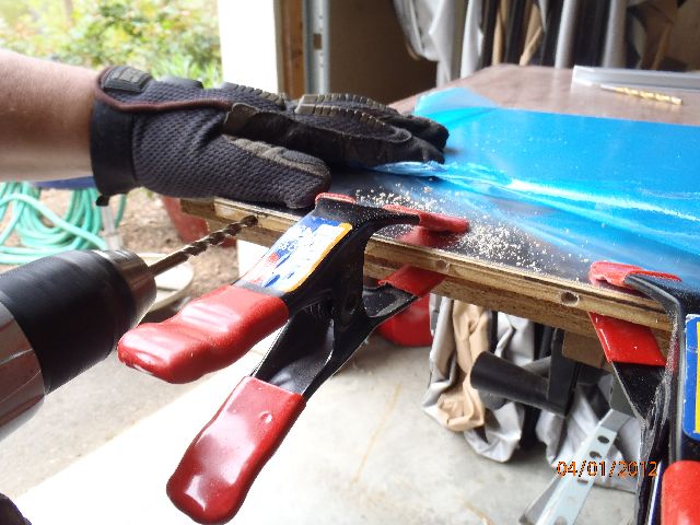

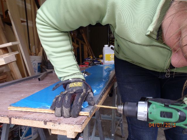

Once the materials were cut to size, we drilled holes in the bottom molding. The hole are sized to receive rivets.
Then that molding was placed on the sandwich of metal-wood-metal and the holes drilled into the wood.
Then the molding was removed and the holes drilled a little larger to allow room for the rivets’ butts. ( I don’t know the proper term for the hind end of a rivet)

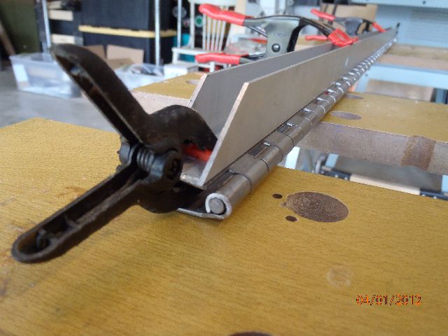

Then the molding was positioned on the hinge and the holes drilled out ( on the drill press) and the holes riveted.
(note rivet butts)

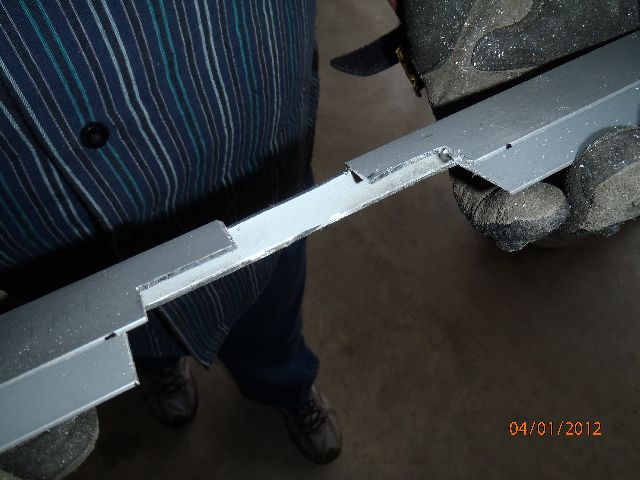

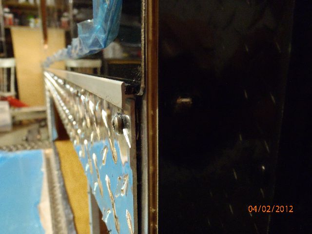

Once that was done we trimmed out the upper piece of the molding to get it to fit around the paddle handle.
This was a little tricky. We actually worked it out on a test piece first.

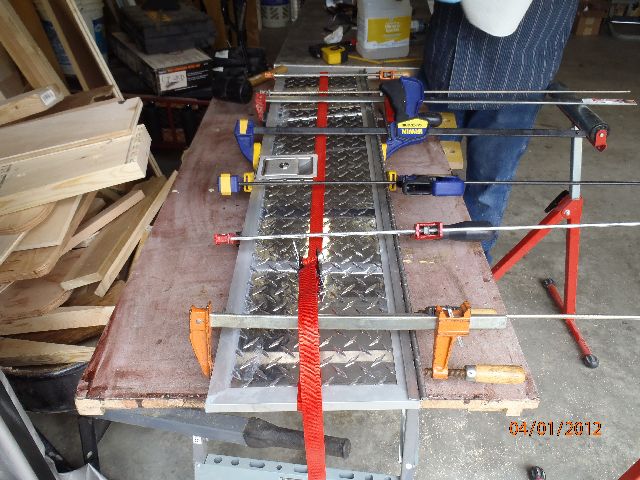

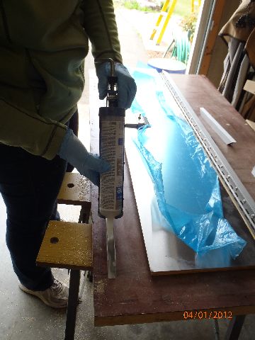

Then I applied a heavy bead of silicone down the inside of the c-channels and the pieces were assembled and clamped an the excess silicone cleaned off.
The next step will be to drill through the moldings from face to back, and rivet the pieces together, though it feels like the silicone alone has a lot of holding strength.
I hope this helps anyone who is wanting to build hatches, I will show how to mount them later, when we get the that part of the build. So far I am satisfied with the results, they seem reasonably lightweight and strong. :)

We managed to get the roof and both sides sheathed in aluminum this weekend. The roof was done yesterday, it went pretty well.
Fitting aluminum (mill finish) to the roof
The black aluminum only came in 4 foot wide, so we placed a layer of flashing to weatherproof the bottom. It is 20 inches wide. There is a line of butyl tape sealing it next to the bottom plywood and trailer frame, filling any little voids.
Cutting out storage hatch openings.
Today we started on the diamonplate trim.
Reference photo incase something goes horribly wrong and I need to show the surgeon what my hubby's face used to look like. :frightened:
Diamonplate installed.
It is 15 1/2 inches wide and is sealed with black goo to the flashing and held in place with stainless steel screws.
A the top of it is panel moulding trim to transition it to the black aluminum.
The grooves are 1/8 inch wide, just right for the diamond plate.
Then we cut the black sheeet to size adhered it with carpet glue (only temporary, as it will actually float, the glue won't hold long term)
The aluminum still has its protective plastic covering on it. All in all, it is a bit too shiney for my taste, however I know nature will put an oxidizng patina on it soon enough. At the very least it will be coated with pollen as soon as it is outside.
Hubby stapling second side, just a few around the perimeter.
The top aluminum sits in the top groove of the panel moulding. It is held snug with a rubber screen spline that just fits in next to it. Later there will be another piece of trim that dresses up the top of this area.
We still have alot to do, the hatch should prove to be tricky, it is next. We also need to install the hatch doors along with the door and windows.
