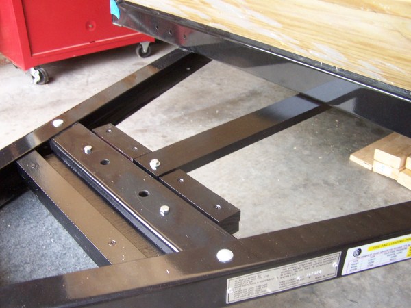

Re: The build begins (modified Weekender)!
Postby albion2 » Wed May 16, 2012 12:51 am
crumbruiser wrote:Image
I took 2 of the center cross braces, and clamped, drilled and bolted them to the sides.
I had to cut off about 20 inches or so. I was wanting to save the weight, you can see what I cut off under the tongue jack.
I am adding 2 2x4s length ways. Right now, there just laying in position. I'm thinking that a 5x10 might be too heavy for the PT Cruiser so I may build a 5x9 or 5x8 and give myself a back porch. I'm planning on a rear entry TTT.
Frank

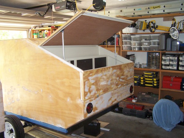

Re: Weekender status - body work and electrical (update 5-17
Postby les45 » Thu May 17, 2012 3:01 pm
It's been a while since I posted so I guess I need to catch up. Getting a lot done, but not a lot of picture changes to show for it. Rain and humidity for the past two weeks have really slowed down my body work and painting. I've gotten four coats of CPES on all the outside and the first round of Fill-it filler, but I'm waiting on the weather to clear before I sand everything and do the fiberglassing on all the edges. While I wait on the weather, I've started on my electrical. My original plan was to install the battery in the storage area under the galley counters, but I decided that I didn't want to deal with a vent system so I installed a battery box on the tongue (I needed the tongue weight up there anyway). I'm running the battery cables through the cabin with a combination of wiremold and clear plastic tubing for conduit. On the other side of the cabin I'm running the trailer lights with the same type of wiremold and plastic tubing. The nice thing about the tubing is that it slides down inside the ends of the wiremold and protects the wiring. I've been buying a lot of parts online including coolers, cabin lights, hurricane hinge, bussbars, and terminal strips. They are all starting to come in now. Hopefully the weather will clear up soon and I can finish the filler, apply the fiberglass tape, and paint with Valspar tractor paint. One thing I should point out is that I cut my holes for my Fantastic fan and tail lights after I applied the CPES. I had a little CPES left over so I plan to go back and seal all those raw edges with several coats.

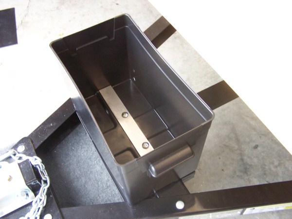

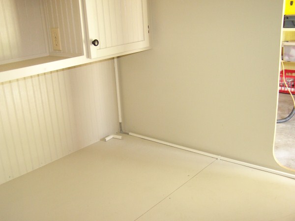

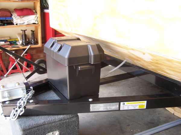

Battery box installed on tongue. I'll use clear plastic tubing as conduit to run the trailer light wiring and the battery wiring into the cabin. A slightly undersized hole through the plywood makes the soft plastic tubing seal really tight. I'm hoping it is waterproof without having to caulk. You can't tell by the pic, but the box is mounted really solid on a wood frame bolted to the spare tire rack with a full length metal strap washer inside. The size 24 battery is actually smaller than the size 27 box so there is plenty of room for the wiring and plastic tube conduit to run inside the box. I plan to fabricate a metal locking strap to hold down the lid and secure the entire box.
Wiremold on left side will carry battery cables to power cabinet. Similar wiremold on right side will carry trailer lights to galley storage area (rear side markers and tail lights). Haven't run wiring yet. Note receptacle installed in cabinet shelf for TV and heater.
Switch at top is the master battery cutoff. Figured that would work better than a big old knife switch hidden down in a cabinet. The hot battery lead will run through the switch and will remain off when not in use. All of my cabin lights have built in on/off switches so this will prevent something from accidentally draining the battery. Receptacles under the galley cabinets are also in wiremold surface mount boxes.

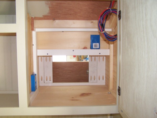

Backside of electrical cabinet. Progressive 4045 converter/charger will mount from the galley side and all AC/DC distribution will be inside this cabinet with access from the cabin. Note back side of cabin receptacle and battery cutoff switch installed.
Tail lights dry fit under tailgate area. Wanted to use LED's, but the old style lights were the only ones that fit flush and allowed the tailgate to drop down flat. (obviously a lot of sanding yet to do).

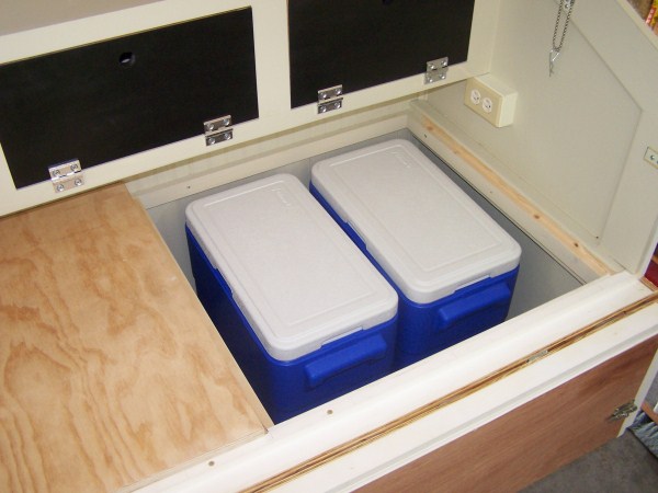

Found these Coleman coolers on sale at Sears online and they fit perfectly under the galley counter tops. I have two more coolers with handles and the camp stove to store in this area.
Hurricane hinge came in the mail today and will be ready to install when I finally finish the paint. The folks at Vintek are really great to deal with. I've bought a lot of major parts from them and shipping is always fast.
Hoping for good weather so I can get back on the body work. Stay tuned.

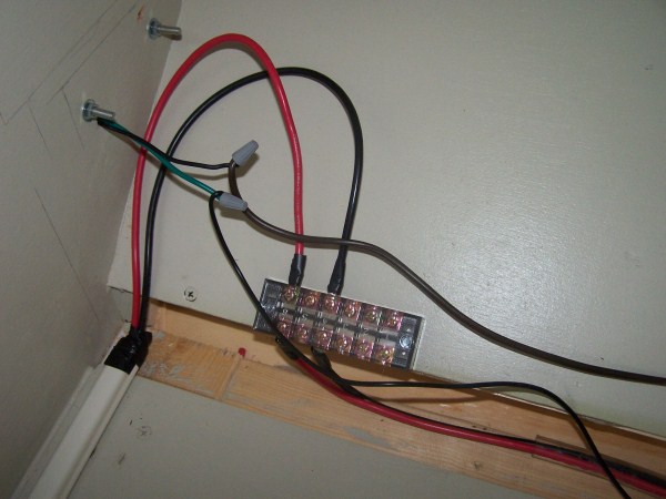

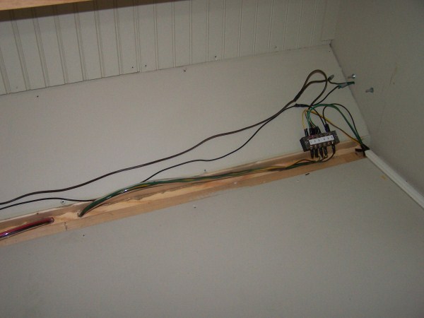

During the past two weeks of rain that kept me from painting, I've nearly completed the electrical.
Painted wood bracket on spare tire carrier will hold battery box.
Battery box bolted in place with aluminum plate washer.
Battery box complete with 1/2" plastic tubing conduit from cabin. Battery leads in one tube and trailer harness in the other.
Tubing conduits enter near center and run to each side. Right side is trailer wiring harness.
Closeup of trailer wiring harness. Terminal block allows distribution of front clearance lights and allows removal of wiring harness with battery box without affecting
the rear half of the system. Wire nuts to clearance lights are temporary and will be replaced with permanent plug type fittings after final painting.
Closeup of battery leads. Terminal block serves same purpose to allow removal of battery box by simply pulling the front tubing out without affecting the rest of the system.
Progressive 4045 all wired up (except final AC inlet). This will control four DC circuits and three AC circuits.
Back side of converter inside electrical cabinet. All power systems except trailer lights are distributed through this area. Hole is drilled for AC inlet (partly visible on right side). Inlet fitting and pigtail are complete but will not be installed until after painting.
I've got running lights!
Also (not shown) got the Fantastic Fan dry fitted.
After all this, I spent the morning removing all the exterior fittings so that I could resume sanding and painting. Weather is clearing so I hope to have the painting done soon. Stay tuned.

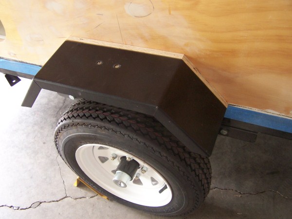

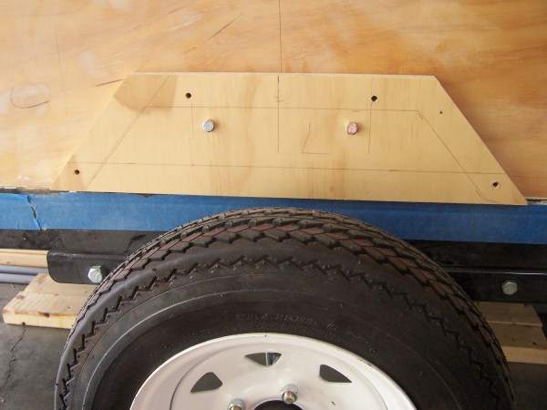

Postby les45 » Mon Jun 04, 2012 3:27 pm

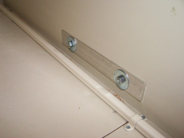

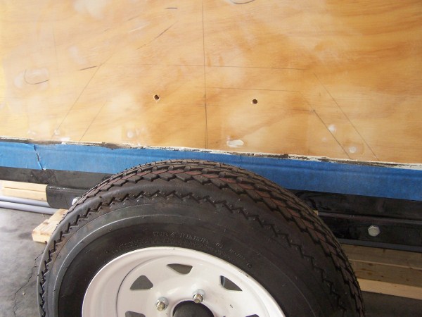

I was moving along pretty well with the fiberglass and epoxy until the rains came this weekend. Decided to go ahead and mount the fenders while I'm waiting on the weather to clear. I'm using the fenders off my old 4X8 HF trailer since they are angular and fit the shape of the weekender better (the NT fenders were big and round and they swapped right onto my old HF trailer with a little adaptation). I used a piece of 3/4" plywood as a spacer to set the fender out from the body and (mostly) cover the tire. There is about a 1/4" of sidewall sticking out, but it doesn't look bad. I may double the spacer to make it closer to center if I don't like the way it looks later. Simply bolted the fender to the spacer and then the spacer to the body with large strap washer and fender washers inside the cabin. The nuts and washers will be below the top of the mattress inside.

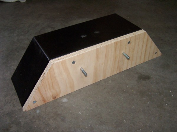

I figured the sturdiest mount would be bolting directly to the 3/4" sidewall.
3/4" plywood spacer holds the fender and bolts directly to the sidewall.
Used four 1/4" bolts to fasten fender to spacer and two 5/16" bolts to fasten spacer to sidewall.
Everything dry fitted.
Top view. Wood spacer gets sanded,sealed, and painted. Fender will stay black but I haven't decided whether to paint the spacer black or same color as body.
Holes in fender will get auto body filler.
Aluminum strap and fender washers distribute load to sidewalls. Dry fit with plain nuts but will use nylon lock nuts for final installation.
les45

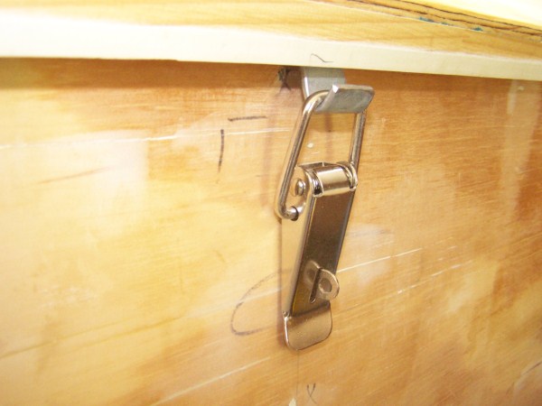

Decided to use three large pull latches to hold the hatch down. The hooks are about 5" long and custom made from 3/4" X 1/8" bar stock in order to get a good grip on the hatch. These can be locked, but I'll probably just stick a small carabiner in the hole to keep them from coming open. Like someone said in a previous post, I would rather they steal the small stuff from the galley than to have to rebuild the hatch.

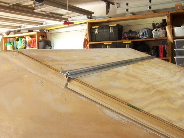

After finally figuring out which side is which, I got the hurricane hinge installed. That thing is a pain in the @$$ to thread back together after the pieces are installed on each side. A little lubricant might have helped.
