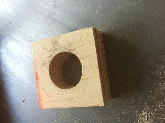

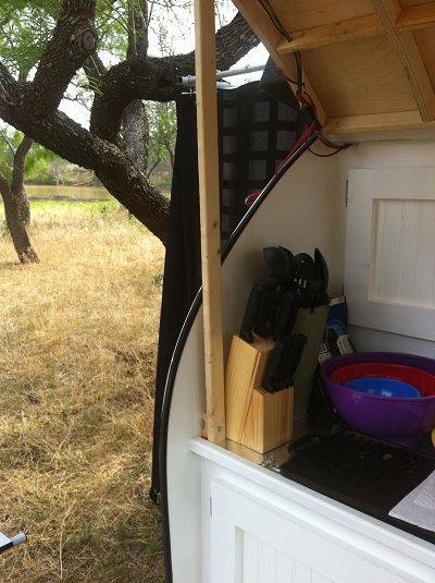

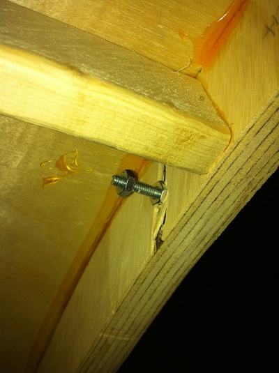

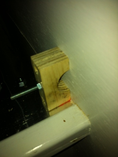

Made some simple hatch prop connectors out of a 2x2 piece of ply and four 1.5" machine screws. It's attached to the galley wall at top and bottom and then the spar slides over it and the nut goes outside of the spar. Not the prettiest, but minimal set up, easy to make out of stuff I had and should be secure in the wind.

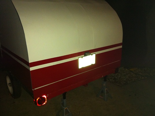

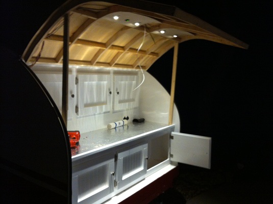

Wired the hatch and license plate and all tested out successfully.

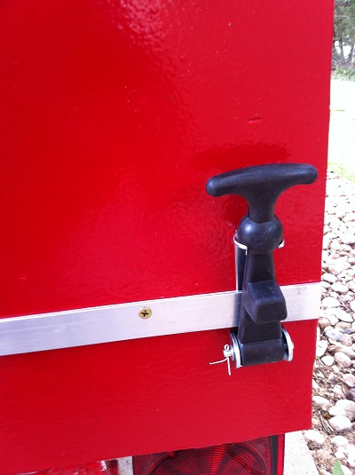

Installed the hatch lower trim and the hold downs

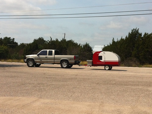

Did a quick safety check and went for a test drive, tows straight and steady up to 60, haven't tested beyond yet. :)

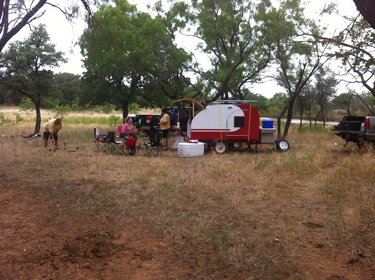

MAIDEN VOYAGE!!: First time teardrop builder - project on 4x
Postby txcamper » Tue May 29, 2012 9:03 am
First, I want to say thanks to all of you for the kind comments and to this site for the wealth of information on building these.

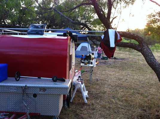

Second, I want to say that our maiden voyage in the teardrop was all that we wanted and more. Great camping experience and everything worked as planned!

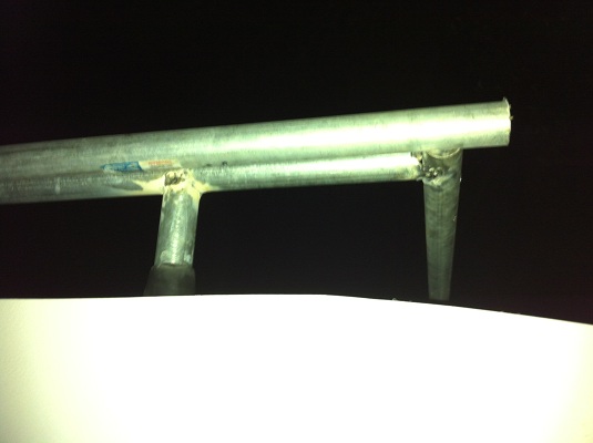

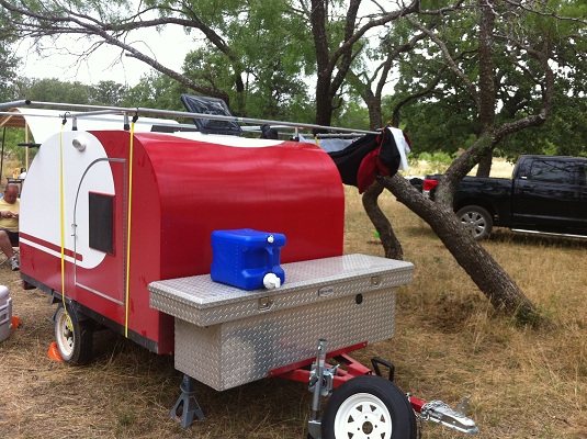

Before we left, I welded up a quick telescoping roof rack of sorts for the changing room and we made up the bed for the trip!
We left for an 8 hour round trip to our campsite, the trailer towed great at 60-65 the entire way and made it across probably 20 acres of rough trail into the campsite. Was pleased that all of the build held together perfectly through this rough terrain. We set up camp and had a great weekend. We ran the fan at least 20 hours, hatch lights any time it was dark and we were awake, and interior lights off and on periodically for our little one as needed and the battery level after Friday night to Sunday night was still at about 50%. We also ran the stereo anytime someone was awake and a small portable dvd player for about 45 minutes and the second battery was still at 70% when we got home on Sunday. The storage worked out well and was laid out perfectly for our needs, the changing room was worth the rush before we left and I'm now going to do some clean up and completion on my welds, paint and find a way to mount this securely for travel (it rode in the bed of the truck on the way this time).
We had a great trip, Thanks again to all!
